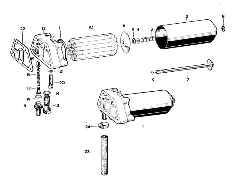

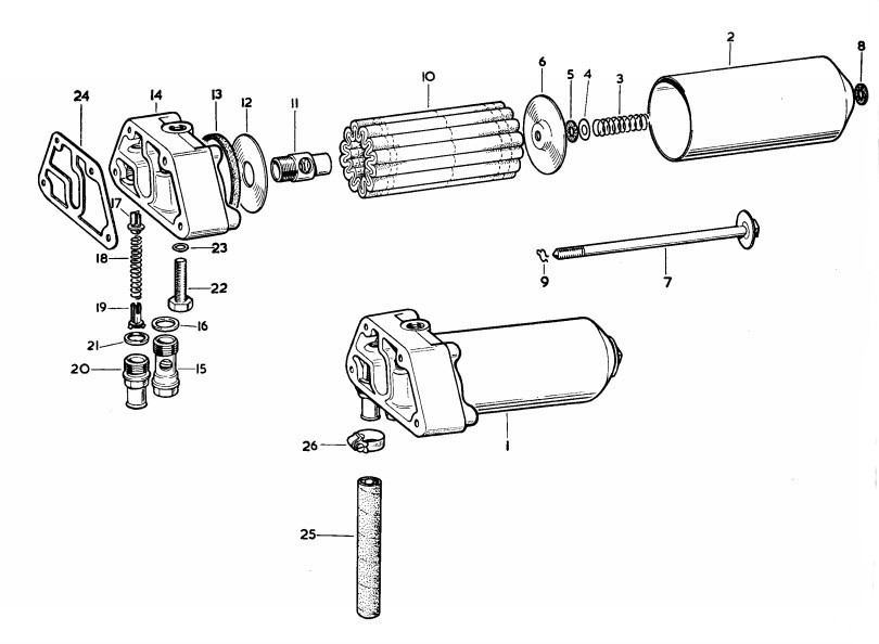

I have been mislead by the factory fit drawings of the 3.8 and 4.2 assemblies respectively.
On the 4.2, there is indeed a metal plate, piece number 12:
factory fit 4.2.jpg (62.03 KiB) Viewed 10650 times
On the 3.8 drawing however, there is no plate between the filter element number 10 and the filter housing number 12 (the ring number 11 being here, as correctly outlined by Steve, to seal the canister cover) :
factory fit 3.8.jpg (57.64 KiB) Viewed 10650 times
Not having that metal plate, I may have wrongfully mounted my filter assembly and will have to source a plate for correctly reassembling.

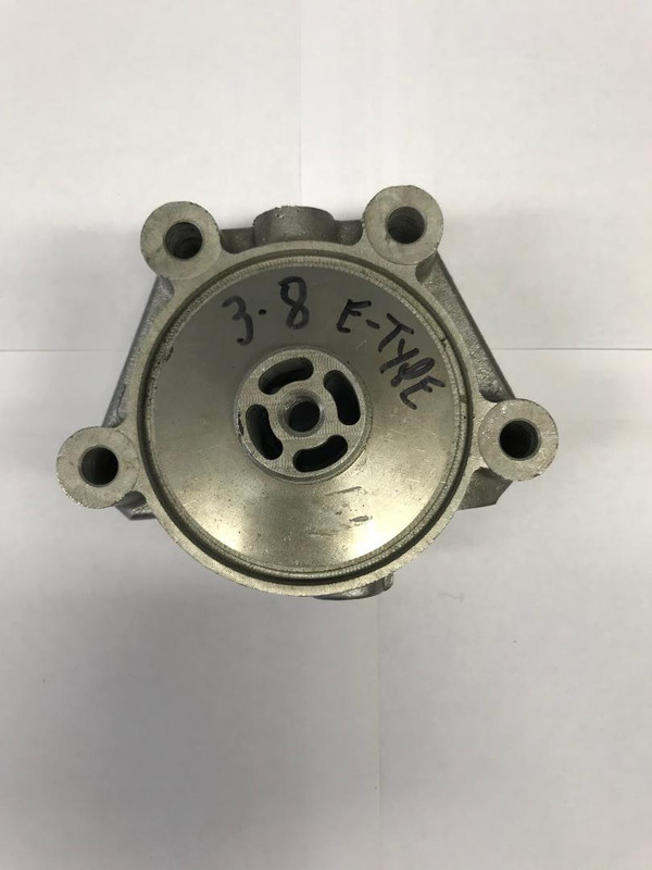

Hello Serge I see your mistake. The reason is the plate on the 3.8 filter block was not removeable and was pressed onto the alloy casting - so it was not offered as a separate part.
It must be fitted for your filter to work as intended.
