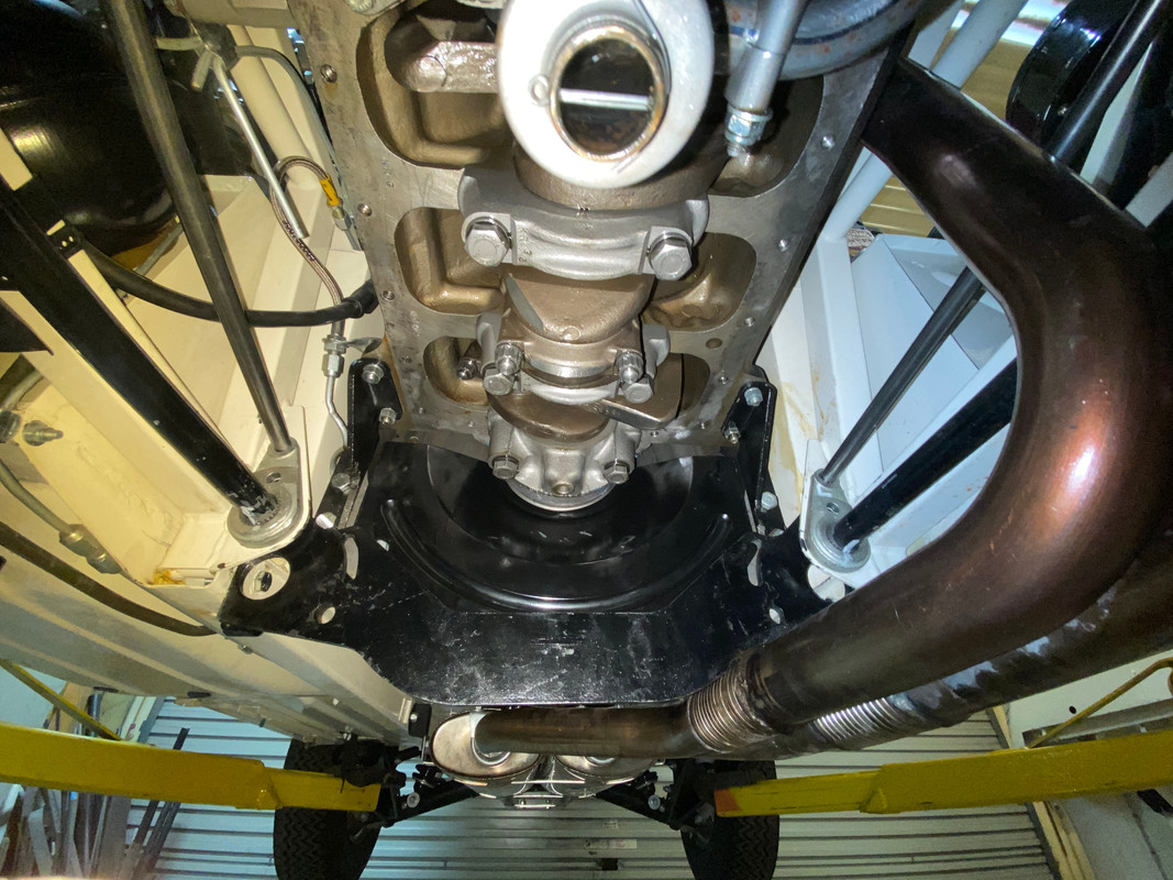

I have ended up needing to remove the sump from a 3.8.
Although I obviously did this 2 years ago, memory fades...
Armed with this thread I was able to do this by dropping the tie plate down with the exhaust still in place.
I made some nice long pins out of 1/2" 4140 steel with the ends turned down to a .370" section around an inch long with a nice blunt taper, as per the manual.
While you can do it without the pins, just using bolts, the long pins allow you to manipulate the tip into the hole in the tie plate more easily as the torque on the TB does tend to twist the bolt off line and out of alignment with the TP hole. This should make refitting the TP easier.
Here's a photo for posterity showing the crank position for clearance and the pins in situ.
Interestingly the main problem with clearance seemed to be the rear main bearing cap more than the crank web although you can't actually see into the sump to be sure until you have enough clearance to get it to drop down.
With the TP pushed down and back there is ample clearance to get the sump down and around the obstruction. And yes this is an adjustable plate but the critical dimensions are the same as the standard one.
I do however remember what a chore removing the gasket from the bottom of the block was. Took me an hour.
