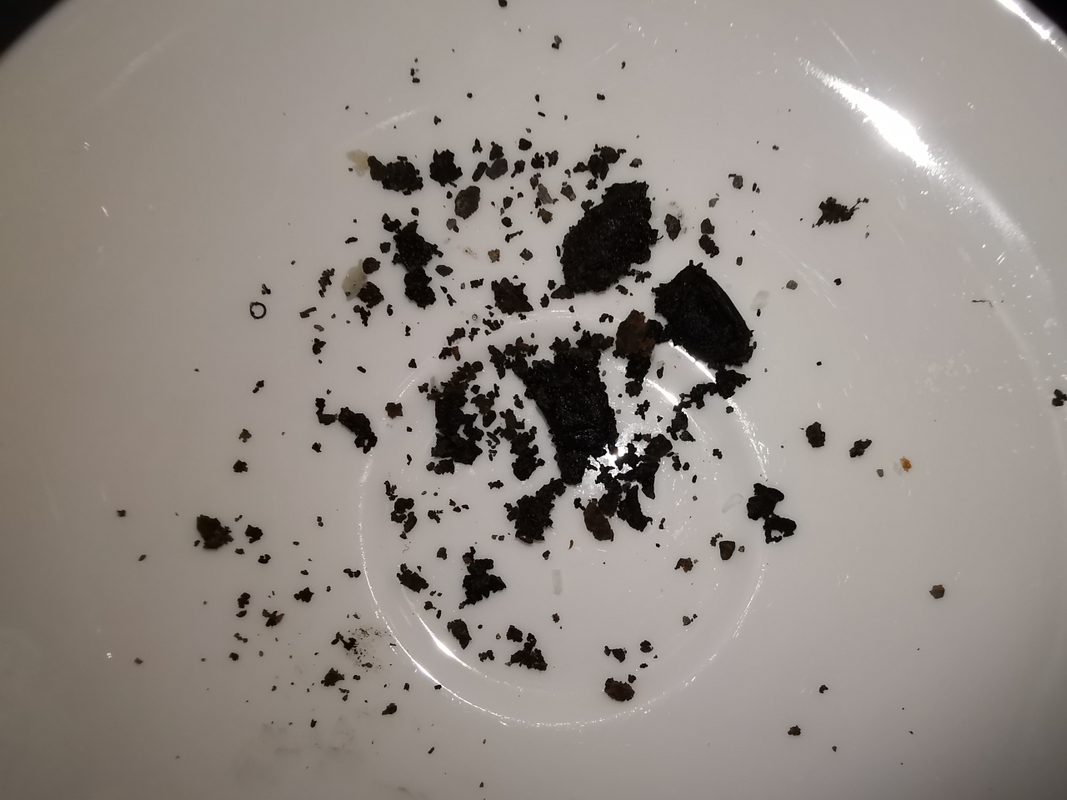

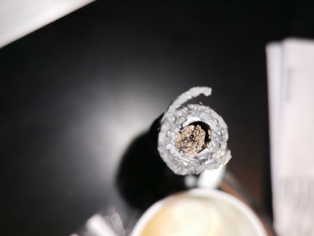

Update:
When I removed the Banjo the pump ran much faster and I found out that the fuel-pipe in the trunk was totally clogged and not even a drop of gas had reached the pump. It is not bent and looks ok from the outside but well it is 48 years of age ... hose with inline filter :smile:
Guess I will have to get new ones :wink:
clogged in an area of about 3cm:
