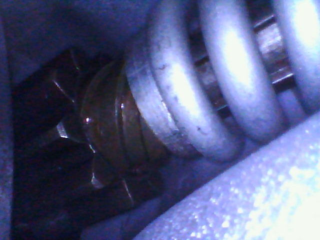

Thanks Barry, however it I would prefer NOT to take the engine out - the car is almost ready after over one year of assembly...
Before I took the starter out, I tried to tae a few shots to see how did the starter jam, but all I got is this:
- from the bottom, showing the pinion did not disengage:
from the top, flywheel tooth visible bottom left corner:
BTW - taking the starter out is a hell of a challenge!!
The nuts from the front are impossible to take out as there is no space for any key so the only way to remove the bolts from the back. The top one is ok, but the bottom one is quite a challenge!
