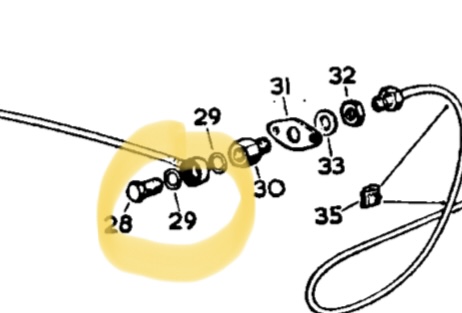

I don’t know what model you have, but I had something similar on my 3.8 fhc. I started getting fuel smells in the cabin and after ruling out leaking carbs etc under the bonnet, I checked the pump and sender gaskets but all were ok. What I found was the banjo union (28 below) holding the nylon fuel pipe where it goes through the rear boot bulkhead was not tight and fuel had been dripping down behind the spare wheel and also soaked into the cloth I had wrapped around the spinner mallet that was tucked below the union. When I tightened it, problem solved.

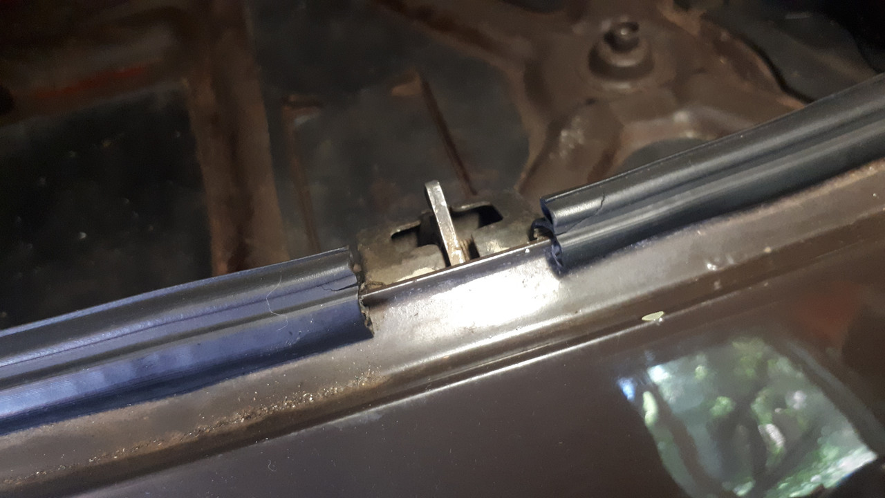

DHC, you mean OTS? If so yr problem is almost certainly exhaust fumes.
E-types without or with modified emissions control generally run rich, there are unburnt hydrocarbons in the exhaust from which, due to e-type aerodynamics, you can never escape. Result can be hair, clothes, luggage smelling of petrol. May be most noticeable after lengthy journeys at highway speed, under such steady state conditions, due to the aerodynamics, cloud of exhaust is firmly anchored to and surrounding the rear of the car.
Fumes get into the boot via empty screw/bolt holes, drains without bungs and loose or worn boot lid seal. Largest opening is usually the gap between the ends of the boot lid seal at the latch.
Worst case is if there is opening from the bottom of the boot across which there is negative pressure, i.e. air is sucked out of the boot. This air is replaced by exhaust fumes through other openings, i.e. you have a positively powered circulation of exhaust gases through the boot.
This issue is pretty much confined to OTS cars. With FHC’s the “boot” is part of the cabin, there is positive ventilation drawn from the front of the car, at other openings there is cabin air exiting, not exhaust gases entering.
Posts on other forums suggest meticulously sealing the boot; difficult to do entirely. Another solution may be to implement a boot ventilation system that effectively mimics the FHC condition. Install a rear facing nozzle from one of the boot floor drains, for strong suction of air from the boot. Install a generous air supply to the boot, ducted from a location towards the front of the car where there is positive pressure and no exhaust contamination.
Solving the boot issue still leaves the hair and clothes. To solve this, first requirement is to get yr car professionally tuned using an exhaust gas analyser to reduce unburnt hydrocarbons. Again difficult to do entirely due to our cars are 60 year old technology. Next solution would be to have a catalytic converter retrofitted. Difficult, not a backyard or local mechanic job, would need to be designed, by cat experts.
