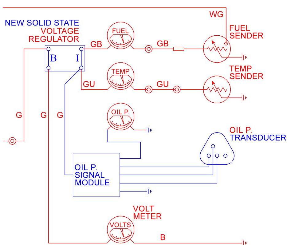

The drawing in post 15 is incorrect, the oil pressure gauge should go to the "B connection on the voltage regulator the same as the voltmeter.
The original design had the oil pressure gauge/sender powered from the “B” connection because back then the oil pressure senders were voltage independent bi-metallic switching types. Such are NLA, these days all you can buy are resistive type senders, these are very effected by voltage so, for consistent performance when using a resistive sender, the gauge should be powered from the “I” connector. Note that the sender is drawn as a resistive type.
Powering the gauge/sender from the “I” connector would make the gauge consistent however it will also reduce the indicated pressure, because voltage is lower, “B” voltage is typically 11-13 V, “I” voltage is 10 V. To resolve this you would need a different sender or Marek’s widget. Either way, if it is a resistive type sender, the voltage supply should be regulated.

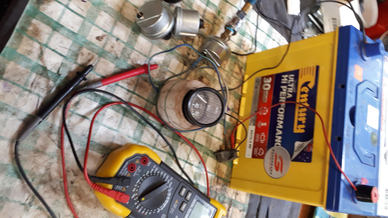

Using S3 as example:
Original bimetallic switching type of sender was a Smiths Instruments PT1811-10 (has a double lug electrical connector in the middle). The Jaguar part number was C31177. Now when you purchase a C31177 you will most likely be sent a PTR1811-10 (R = resistance, has a single lug electrical connector that is off-centre). Despite the common Jaguar part number “PTR” senders have completely different principle, performance and requirements compared to the original “PT” senders.
The “10” in the above sender designations signifies 100 psi, this is the pressure that will cause your gauge to indicate full scale. The S3 gauge full scale is 80 psi therefore, with everything working as intended, when the oil pressure is 100 psi the gauge should read 80 psi. This is demonstrated by the following test results: The two Smiths senders are 100 psi so when 90 psi is applied the S3 gauge indicates 75 psi. The VDO sender is 80 psi, same as the gauge, so when 90 psi is applied the S3 gauge indicates 90 psi.
The above results were with the gauge connected to the “B” connector, voltage was 12.4 V. When swapped to the “I” connector (=10 V) the gauge indication reduced correspondingly, i.e., with the Smiths senders, when 90 psi was applied the gauges displayed 75 psi when connected to “B” and 55 psi when connected to “I”. This suggests that, for S3's with resistive senders supplied from a regulated (10 V) supply the ideal Smiths sender might be a PTR1801-06, Jaguar part number C15474?

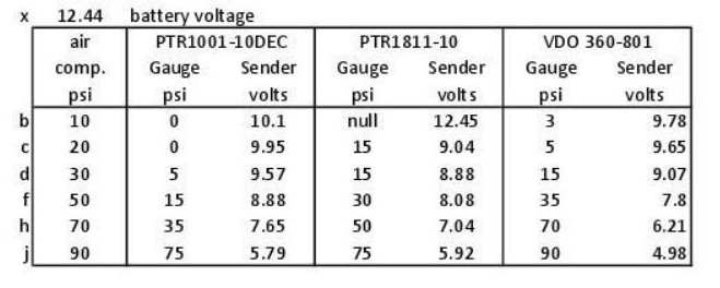

Here are my test results. Bench test, i.e. everything out of the car:
Battery voltage = 12.44-12.45 V, the later with afternoon sun through the window.
As per photo, because my senders are all resistive type I started with voltage regulator (10V) in the circuit. However the relatively slow switching by the regulator made multimeter reading too difficult so I removed the regulator. At 90 psi with 1001-10DEC sender, gauge reading increased 20 psi when the regulator was removed (from 55 to 75 psi), would be even higher when there is alternator voltage (~13.6 V). Such voltage dependency is why voltage regulators are used with resistive type senders, for consistent, reliable reading.
One gauge, 3 senders: (1) Smiths PTR-1001-10DEC, (2) Smiths PTR- 1811-10, (3) VDO 360-801.
Measured the voltage across the sender; more stable than measuring across the bi-metallic gauge. Voltage across the gauge is then the battery voltage minus the sender voltage.

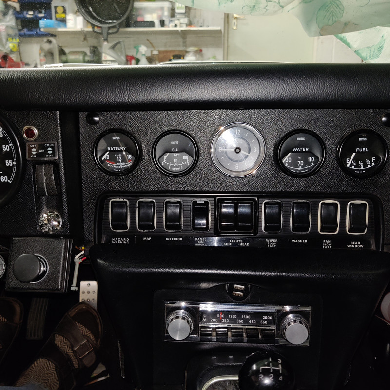

I'm definitely in the !st category, smugly watching my oil pressure rise and fall in proportion to the engine speed and temperature but I've utilised an Aeroquip type pipe to connect to the gauge and used the redundant wire to drive a low engine oil press red light (LHD series 2) on the dash just above the heater controls as a mirror image of the choke warning light.
Chris

Very informative post Colin. Thank you.
If people are uncertain as to whether their gauge is of a bimetallic switch type or a resistive gauge, just connect an LED in between the gauge and sender and feed it from the unregulated supply. If it lights up solid, it's a resistive sender; if it strobes, it's a bimetallic sender.
To give a worked example of how the widget would work, it is easiest to look at the third sender. This needs no basic overall multiplier as it reads correctly at high values 70-90psi - it just needs a regulated supply of 12.45 for that to always hold good - that's easy to arrange and will be part of the widget. Below 70, it needs boosting.
How much does it need boosting?
Well, the next compressor reading at 50psi reads low at 35psi, so if we add a linear adjustment to all values below 70psi, starting with no adjustment at 70psi, but with a triangle shaped wedge of cheese adjustment which gets progressively bigger as we go towards 0psi, then we'll need a 150% adjustment. That's because the indicated 35 gets multiplied by [1+ (1.5 x (70-50)/70)], i.e. 50 pops out !!!
All of the gauges readings further towards zero are going to also get a boost, so the
indicated 15 becomes 27.9 (it gets multiplied by [1+(1.5 x (70-30)70)] ) and
indicated 5 becomes 10.4 (it gets multiplied by [1+(1.5 x (70-20)70)] ) and
indicated 3 becomes 6.9 (it gets multiplied by [1+(1.5 x (70-10)70)] because 10psi is 6/7 of the way to zero
Then you repeat the process with the next lower down wrong reading by setting the air compressor to the next reading down and twiddling the next knob .
With just one adjustment, it's already a lot closer.

Chris, its interesting that you have a 100 psi mechanical gauge. In classic Jaguar style I only know of the Caerbont/Smiths Instruments 60 psi one. Is yours a one-off, cobbled together by someone clever?
And yes, imo the main (very seductive) benefit of a mechanical gauge is its ability to indicate pressure variations in almost real time; an old style electric bi-metallic gauge can never do this.

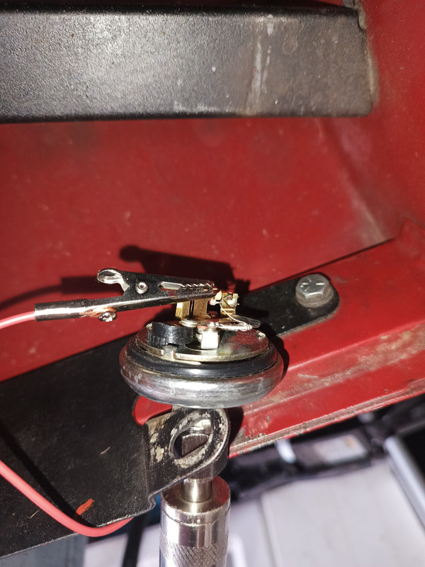

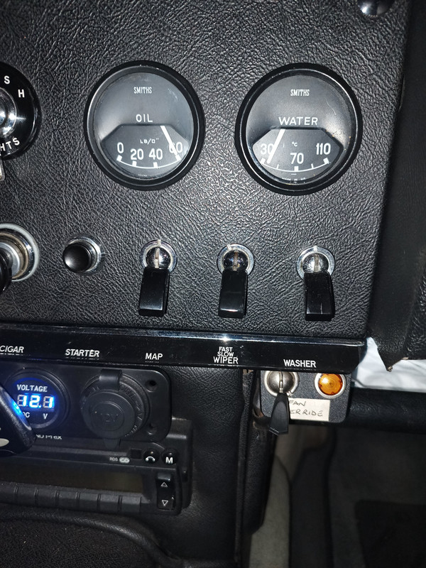

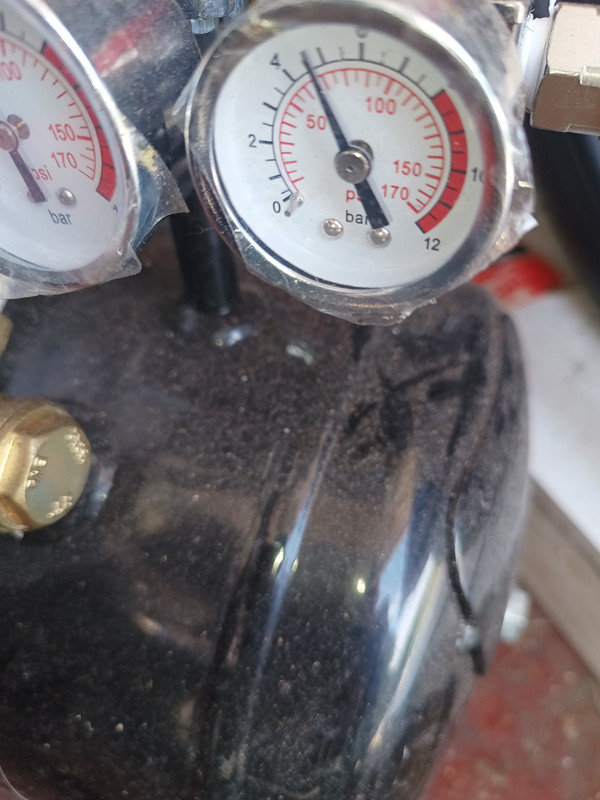

This thread prompted me to do this.
I prised the cap off a sender to see the gubbins inside. This is a bi-metal switch sender.
Having reset the contacts using the rotating black plastic adjuster so that the contacts were just apart at no pressure, I applied air pressure and waited for the gauge to respond.
About 70 psi in the air line....
60 psi on the gauge.
This was one of the several senders which became unreliable. Not sure how long it would read this accurately. If I had been more accurate with the initial zeroing of the sender maybe the reading would have been more accurate. I don't know for sure.
As it is I'm not going to change the wildly optimistic sender currently on the engine. All I need to know is that the gauge reads 60 when I think the real pressure is around 40. As long as this is consistent, then oil pressure is fine. I don't need to know the actual pressure, just that is hasn't changed.

I've done this with a couple of old senders and am using them in cars.
As you say the actual number is less important than a change.
I don't think that you can get replacement senders that actually work.
