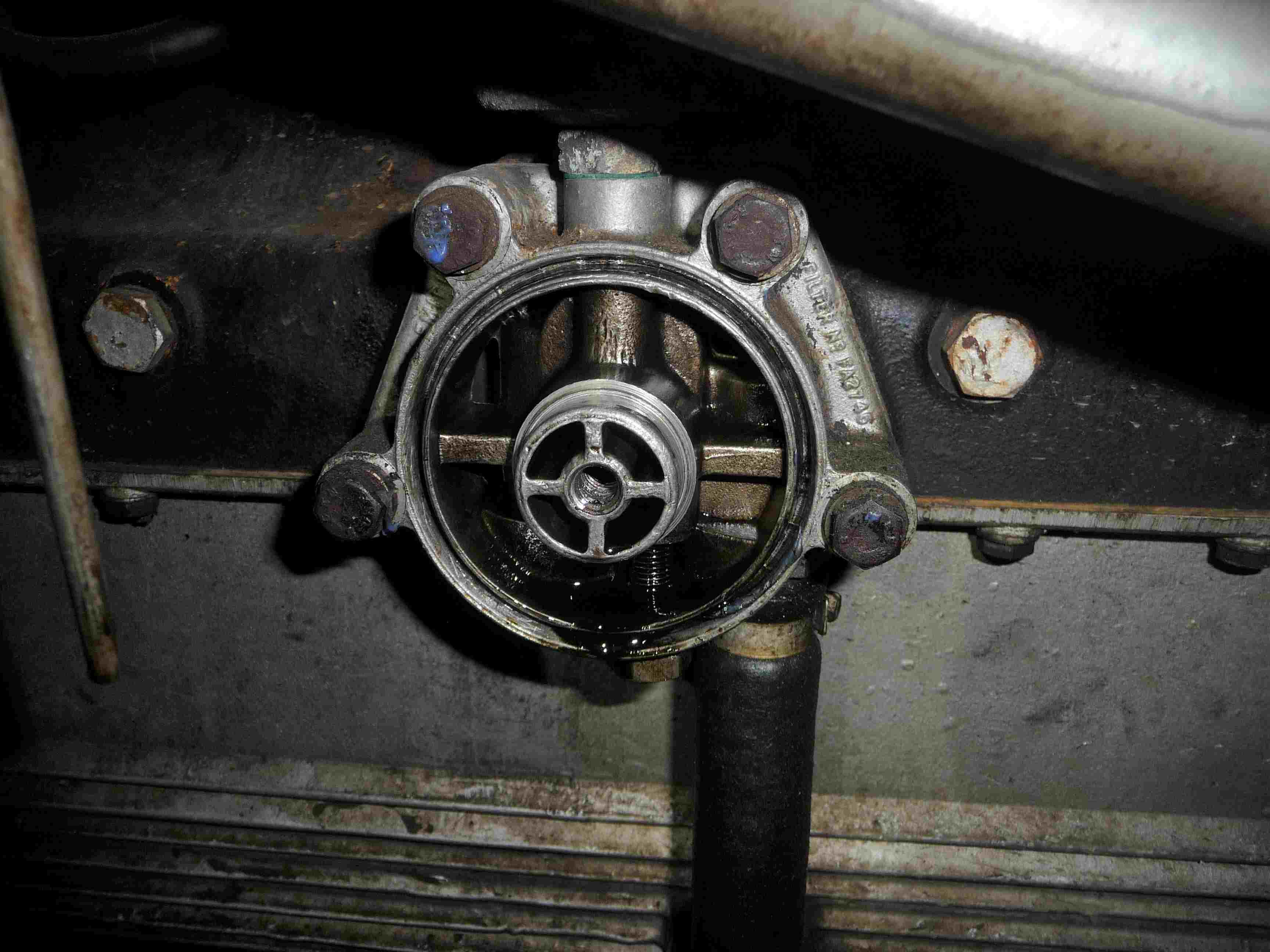

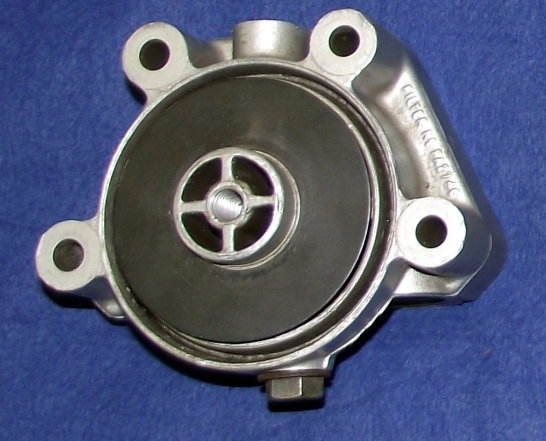

On the factory fit there are indeed two pictures showing the bottom plate on the filter housing.
This one for the 3.8:
factory fit housing 3.8.jpg (154.97 KiB) Viewed 4056 times
And that one for the 4.2:
factory fit housing 4.2.jpg (174.79 KiB) Viewed 4056 times

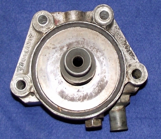

And this is the filter housing I found out when I removed the spin on device:
P1190120 (2).jpg (227.84 KiB) Viewed 4053 times
So should I understand that my filter housing is not a 3.8 one and instead is a 4.2 one with a removeable plate that I would have to source and install or is it a 3.8 one that was butchered?
And if a 3.8 one could I adapt a 4.2 plate on it?

Hello Serge, you have the correct 3.8 filter head just missing the plate. I cannot say how effective (or not) your spin on filter was as I do not know its method of attachment. I will have a look later and see if I have a 4.2 plate to compare with a 3.8 one I know I have in storage.

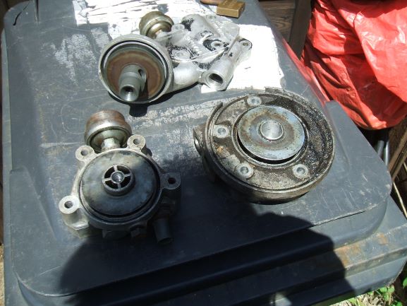

Hello Serge, the photo below shows the different valve housings 3.8, 4.2 (mk2 item not E-type but the plate is the same ) and 4.2 S2 .
The 4.2 has a smaller hole than the 3.8 and could be easily put in a lathe and machined out to match your housing (it would be a press fit so you would need to turn up a fitting tool out of a piece of pipe and you will need a press of some sort)
The dimensions of the 3.8 one are as follows - Diameter 71.5mm
Hole 32.2mm (you would need to adjust to suit)
Material 1mm mild steel and its flat (not concave/convex)
You can make one from scratch quite easily once pressed on the alloy would need to be staked to hold it firmly in position .
The S2 valve block is scrap and you are welcome to it if you want to go that route.
Barrie
