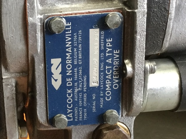

#5 Re: 5 speed xj6 or O/D box for 2+2 s1?

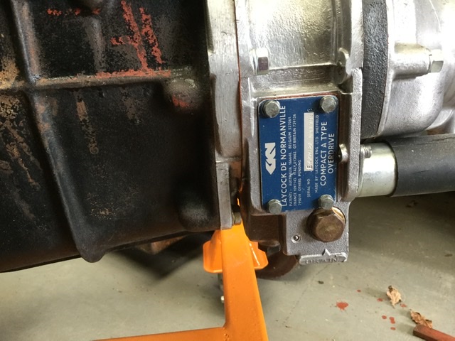

Thanks Steve, now you are I am afraid dealing with an amateur here when it comes to boxes. The guy tells me indeed it is the OD compact A gbox, can you tell by looking or maybe a number?

#6 Re: 5 speed xj6 or O/D box for 2+2 s1?
#7 Re: 5 speed xj6 or O/D box for 2+2 s1?
Couldn’t be more helpful thanks so much Steve

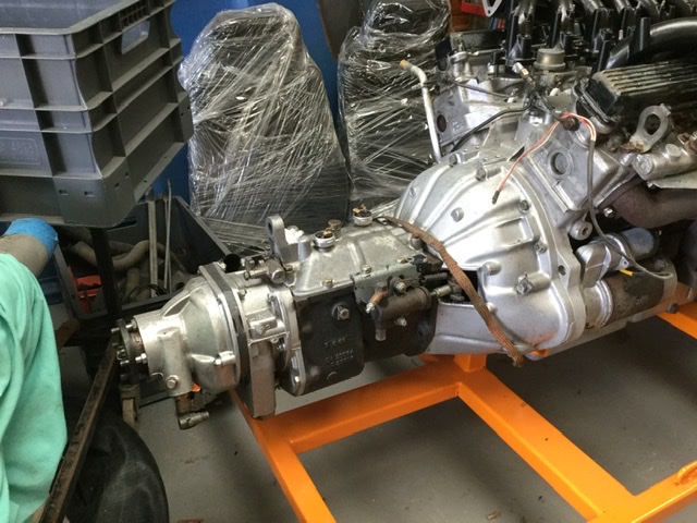

#8 Re: 5 speed xj6 or O/D box for 2+2 s1?
Here is a photo of the S3 XJ6 5 speed (with engine) The remote linkage is not on the box. The LT77 was used in Land Rovers too (as you may know) There is a selection of linkages that can be modified to fit - several on here have done the conversion and may give us a few photos -

#9 Re: 5 speed xj6 or O/D box for 2+2 s1?
Hi Barrie...dont know of anyone that has fitted the Lt77 into a manual 2+2....Skiday a member here fitted one into an auto 2+2 with the larger tunnel......also dont think you can change the gear lever position on the Lt77 box so it will be further back than a standard E type....Steve

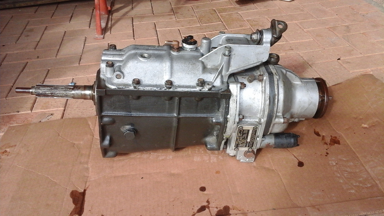

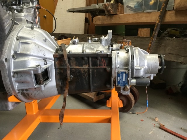

I’ve just relieved my S3 OTS of its heart, it’s had an O/D box on for some time now done by it’s PO. It’s very good and hasn’t given any problems. I believe the PO had a propshaft made to measure by Dave MAC in Coventry.
It’s currently on its stand, your welcome to come see if you,want. The current project is a rotisserie of a slightly different design.!!!

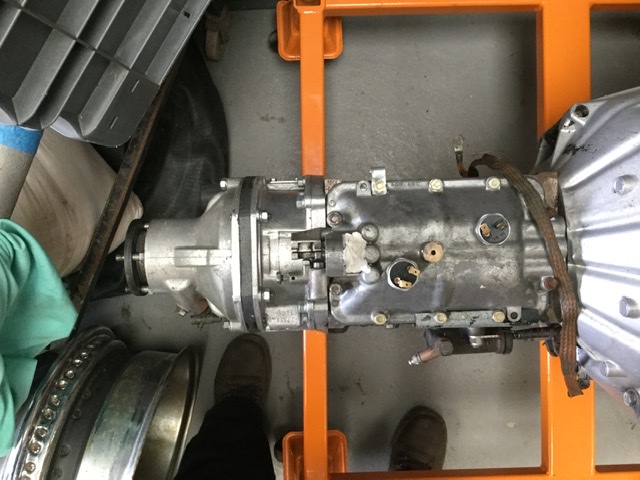

#14 Re: 5 speed xj6 or O/D box for 2+2 s1?
More of the same...

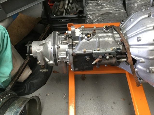

#15 Re: 5 speed xj6 or O/D box for 2+2 s1?
And if’s any help..
