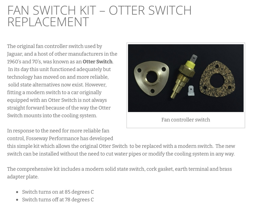

Danny,
I swapped out my manual thermostat adjuster (Kenlowe) to one of these (85/78°C) so its preset and works a treat;
http://www.fossewayperformance.co.uk/fa ... placement/
The Kenlowe capillary globe sat in the top hose and was always seeping so I’ve now solved it permanently.

#3 Re: Capillary thermostat
Mine comes on at 85C and off at 80C.

Coolcat has a very similar product. Similar range i believe.
Works very nicely. My old repro Otter held the fan on to 70, which when working out the car often meant the fan was on when it had no need to be as temp would stabilize around 75 at speed while the fan continued to operate.
