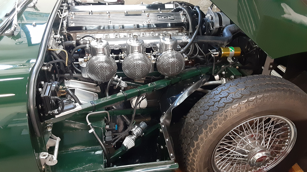

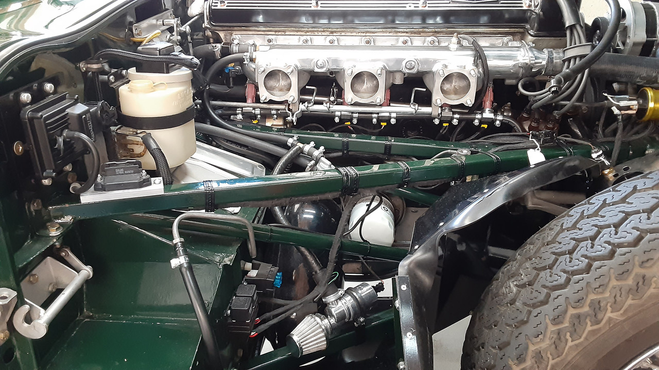

Came across this company who advertise fuel injection kits for SU's. https://www.classicfuelinjection.co.uk/products
Here is a car so converted.
