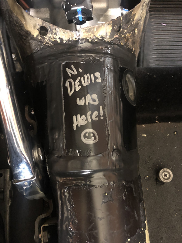

#421 Re: The 5 Speed is here……..
End in sight, looks promising

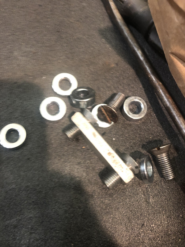

#422 Re: The 5 Speed is here……..
Thanks DWW you need cheerleaders with these projects.
I’m going to shim the Emergency brake for more clearance.
Let everything cure then when I come back from Hershey Friday, Saturday I will put a 100 miles on it to make sure there is absolutely no clearance issues then massage the transmission cover.
Pics to follow on the shims

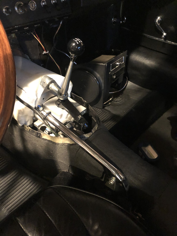

#423 Re: The 5 Speed is here……..
Headed to Hershey ready for test drive saturdayish
Shims can be adjusted
Spacers look close between e brake handle and new tunnel
You have to shim
Looks great

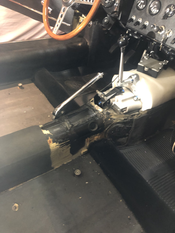

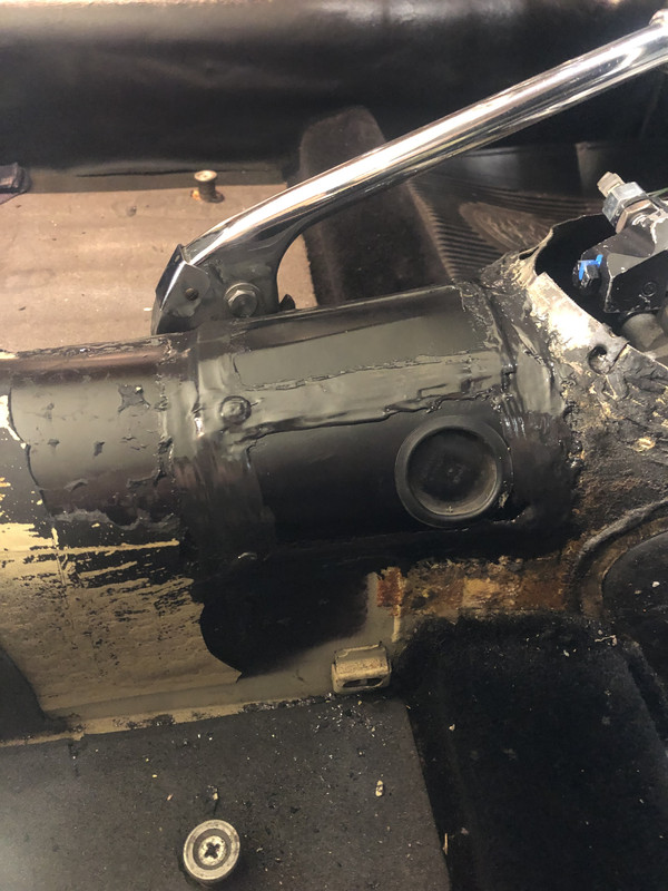

#424 Re: The 5 Speed is here……..
Wow, that’s a lot of JB Weld, probably the strongest part of your car now

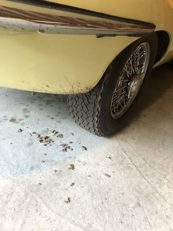

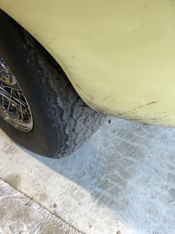

Ps That’s mud on the tires

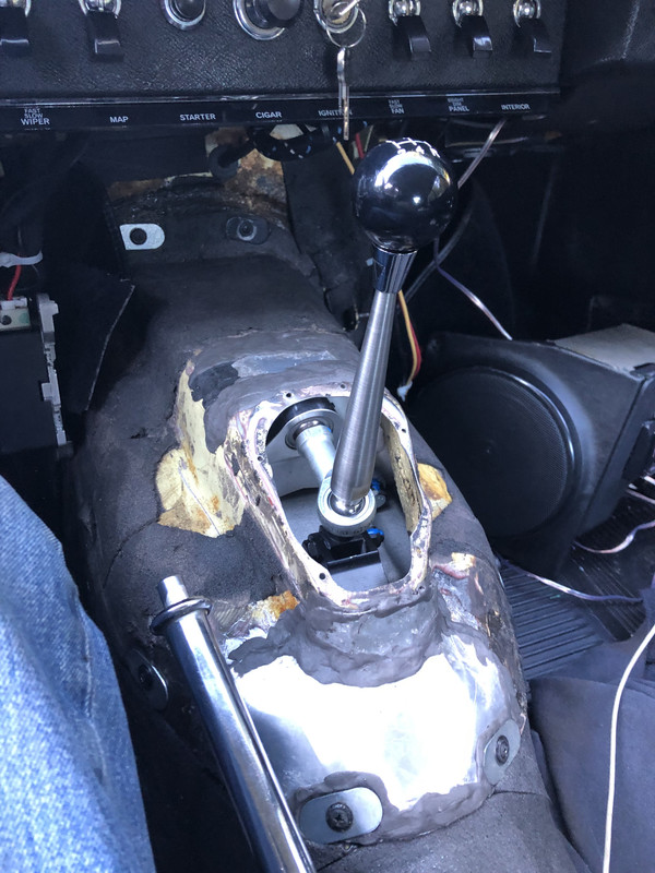

#438 Re: The 5 Speed is here……..

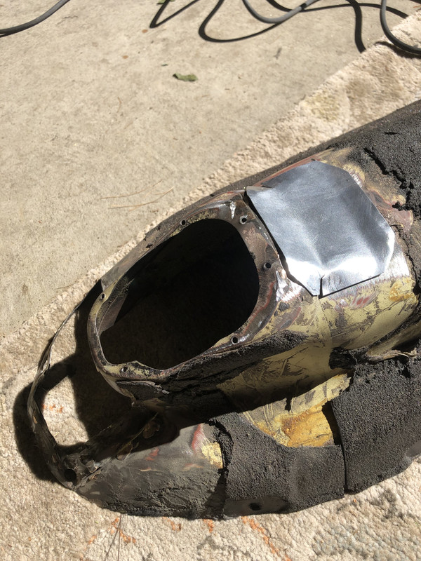

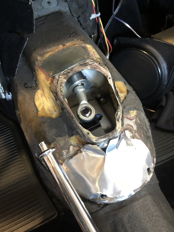

Onto the cover
It looks ugly but once sealed and covered more to come
You need to cut these areas
I used very thin aluminum and will seal it on Monday
I used dum dum for sealing and fumes just to test
Enjoy
Enjoy
