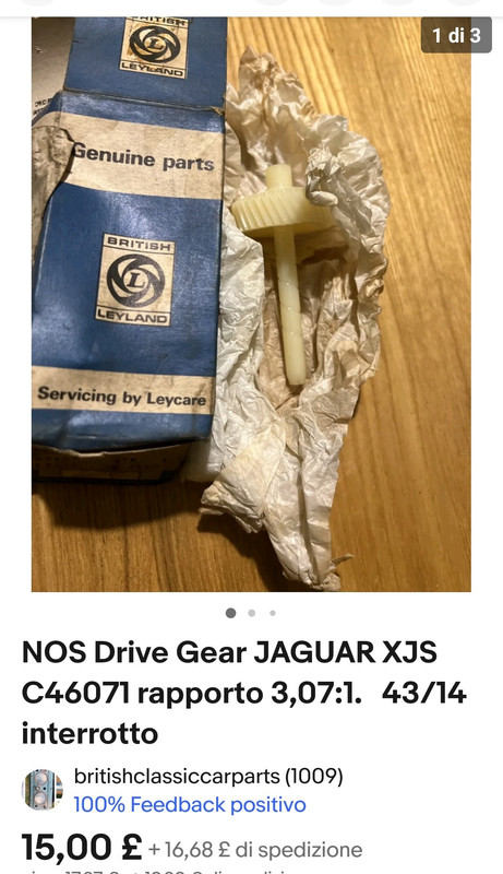

Hi, after your interesting comments and after a drive with a 3.07 differential (4.2 - 1 series) and with a 2.88 (4.2. - 1 series 2+2), I make a decision. I prefer 3.07 differential and I decided to change to that ratio.
Now I need to update speedometer.
Is it possible to change gears to transform a 3.31 speedo in to a 3.07?
I found these gears on ebay (see image) but I'm not sure they are right for me.
Do you know anyone who sells gears or does the work?
Ciao
Giovanni
Giovanni
S1 - 4.2 - 2+2 - march 1966
Posts: 3834
#43 Re: DIFF. better 3,07 or 2,88 for 2+2?
Post by Gfhug » Sun Nov 20, 2022 9:13 am
Giovanni, Speedograph Richfield: http://www.speedograph-richfield.com/ and Speedy Cables: https://www.speedycables.com/ can both do the work for you. Clean up, recalibrate and put the correct dial face on for you.
