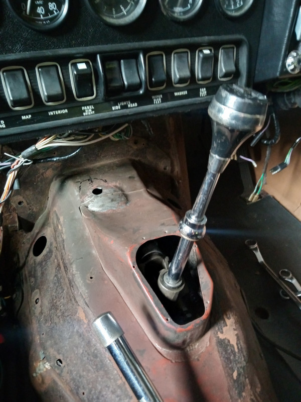

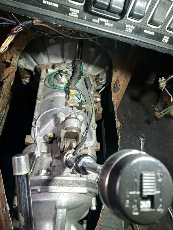

Here is pic of my S3 gearbox top cover showing the OD “select” switch on the gearlever knob (aka xj6) the OD “inhibit” switch on the top cover (front-left), and the gearbox breather relocated to the centre port:
And here is pic of my tunnel cover during panel-beating …
