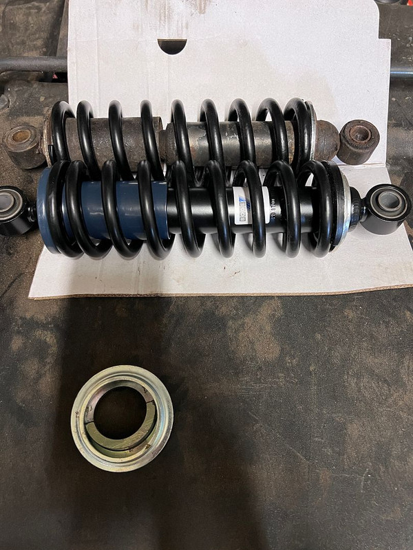

Ok ok, so have a go at my English now then!!
Look its not an issue for me, I have established what I needed to , which is the BOGE is roughly 3/4 inch longer/higher than the original Girling. Thats enough to make me look for another shock absorber as I have peculiar aesthetic about ride heights. So many E types are wrong to me they spoil the beauty. Probably like many others on here, I spent hours and hours as a kid in the 60s studying every angle possible. It was infatuation. If you look at the Gunmetal car which I restored a few years ago, that sits too high with the original springs and BOGE shocks and now I know why. My other car sits better with Konis but not sure I am buying them again, so given I am not on a mission to be 100% original with this car, I think I may go for the adjustable platform SPAX. Thanks for all the input. Andrew

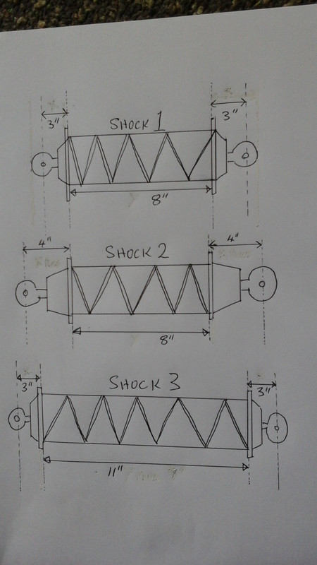

Post by mgcjag » Thu Feb 16, 2023 9:53 am
Hi All....indulge me here......iv just drawn up this representation of 3 different shocks fitted with the same springs...note that the springs iv drawn dont all look the same but iv just drawn it as a representation.....so identical springs.....dimensions are shown....so which shock/spring combo if fitted would give the highest ride height.......the shortest combo 1...the longest combo 3......or the middle length combo 2 ......Steve

Post by Series1 Stu » Thu Feb 16, 2023 1:31 pm
Shock 2

#48 Re: 1965 COUPE STOCK REAR SPRINGS AND SHOCKS NOT SNG
Post by Geoff Allam » Thu Feb 16, 2023 5:36 pm
Steve. Thank you for drawing the diagrams. They demonstrate exactly what I, and I think most others were trying to convey. #2 with the total 8 inches of distance will raise the car approximately 4 inches higher than the other 2 setups. (Will make it look like my Camaro back in the day😁)

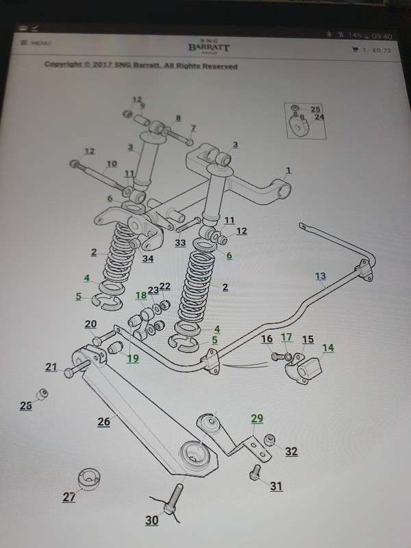

Post by mgcjag » Sat Feb 18, 2023 9:27 am
Hi Andrew...i mentioned previously about spacers. ....looking at your photo i dont see the top packing ring C19027 fitted at the top of your Girling/spring combo.....with this missing your car will sit lower than it should.....part 6 shown here S1 4.2 cars.....I dont know if they are also required on your Boge.....Steve https://www.sngbarratt.com/English/#/uk ... mbly/21400
