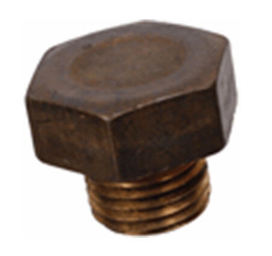

Unless originality is important, I replace drain taps with a threaded plug and safety-wire it in place, to avoid having to worry about this. I did this on both of my E-Types, and it is a suggested modification in the factory's competition tuning manual.

Moe, can you remember the thread size of the plugs you used?

The original drain tap used a straight thread, possibly 1/4" BSP, in conjunction with a fibre washer. I going from distant memory here, so you might want to gauge the threads on your tap.

If you look at post 8 here: viewtopic.php?f=3&t=18589
You’ll see that replacing the tap with a simple screw in plug is a preferred solution. Even SNG Barratt now show one of those instead of the tap for part number C2354. Maybe talk to Radtec to ask if you can buy one of those plugs rather than hope an old one from eBay will be reliable?

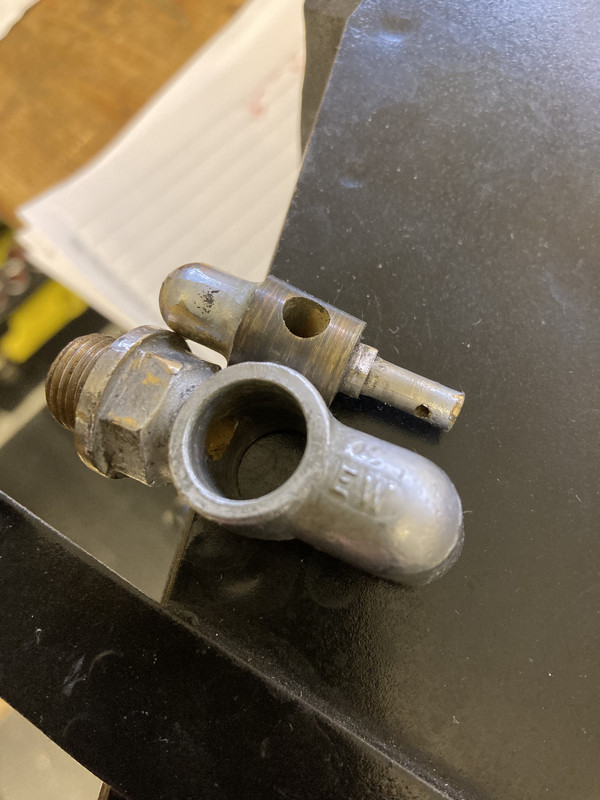

All my drain taps have EW cast in them. I have one on the bench that I am working on at the moment :-
Cheers,
Dave
Cheers,
Dave

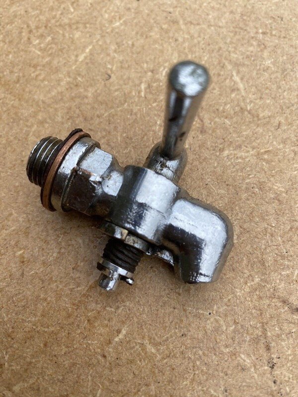

Any brass drain tap with a 1/4" BSP thread will work and there are lots to choose from on eBay. If you want originality this is what the one Jaguar fitted looks like:
Marked EW and either cadmium or chrome plated and not rare as they were used on the saloons (Mk2, Mk10, S-Type) as well. Several for sale s/h on eBay although prices are now a bit silly at about £40. Originally they used one copper and one fibre washer but you can use extra fibre washers to set the orientation.
