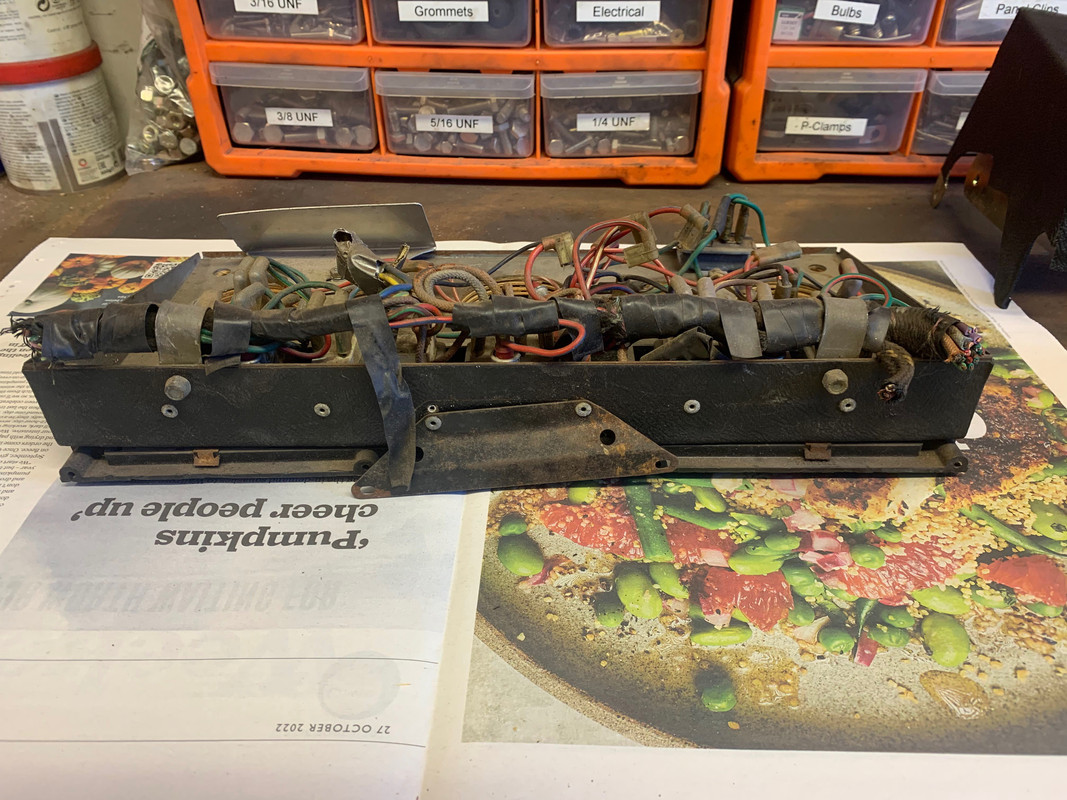

Have removed windshield, new dashboard etc… should have taken more photos…
Where does the lower bracket belong?

Well I’ve just finished putting together exactly the same car and trawling through my pics I can’t seem to find that part anywhere.. I can tell u that the two are not related, but you prob all ready now that, it’s not a part of the rocker switch’s assembly is it? Or down around that area?? I’ll keep looking

Here is mine before being stripped..

The Windshield rod is there for proportions, but they were stored in the same box so I assumed they are from the same area :?:
Changing the whole interior so it should belong somewhere I suppose.

It looks like the piece that goes underneath the switch console to connect with the top of the radio centre console assembly. However, I thought that was only present on S2 cars with rocker switches??

That’s the one…. Thank you :thankyouyellow:
No I have to take it a part again to put it in place.
