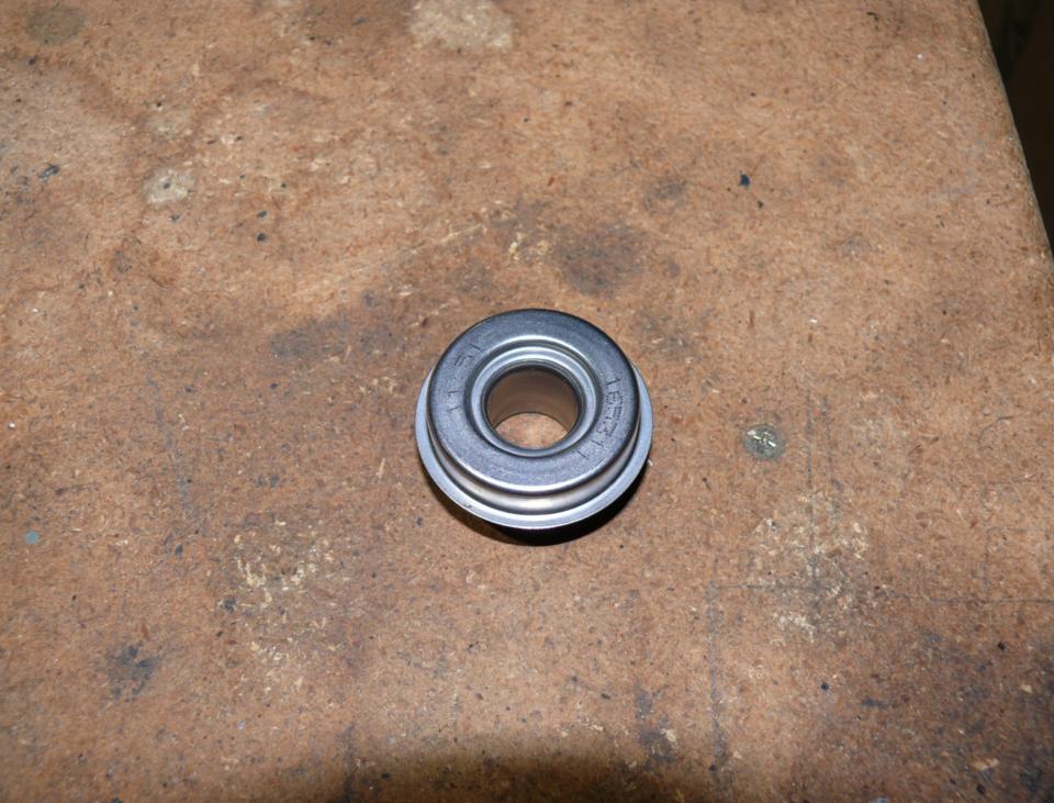

PS2. Original seal:
Tadek

You are correct that the seal is not an interference fit on the bearing shaft.
If you buy a repair kit from SNG these days - as I did recently - it comes with an additional ceramic washer/seal which sits on the face of the impeller and gives you a much smoother face for the graphite of the seal to run on meeting your "min. 0.5 µm", actually probably much better. The spring has to compensate for the graphite wearing away but with the ceramic washer it will last much longer. A new impeller is supplied with the kit whose nose is shorter to compensate for the thickness of the ceramic washer.
From the drawing you've posted you can see that there's at least 2 mm of graphite available to wear away, so the variation on the 0.38mm clearance between impeller and body is irrelevant as to how long the seal will last and that is the only relevant variable available to you as you rebuild the pump.

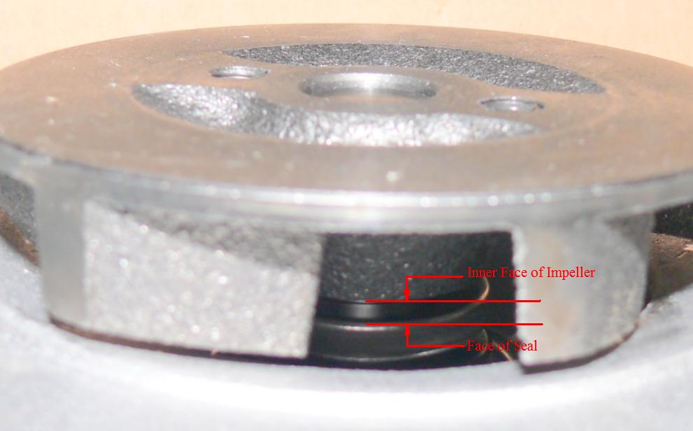

The new, complete S3 Water Pump purchased from SNG Barratt recently, has a gap of approximately 3mm between the inner face of the Impeller and the Outer face of the Seal, which clearly appears as a pressed metal cover that is an interference fit with the Shaft. You can look through the vanes of the Impeller and see this.
A Seal I had in my hand yesterday for fitting to an S3 Water Pump was constructed in the same way as that of the Seal in the wholly assembled Water Pump from SNGB, where both the ID of the Inner component and the OD of the Outer part are both interference fits with their respective shaft and pump body bore. The two Components are able to counter rotate via Ceramic Disks that are held in interment contact by spring pressure. Repair Kits that I've been purchasing over the past two years have a construction as described here.
I've used the type shown in your drawings and I have a repair kit coming from SNGB, so I'll be interested in how its constructed. I don't mind the type of construction of the Seal I've been using over the past couple of years, as, notwithstanding the generous tolerance of the compressed dimension of the Seal you have described, the type of Seal used in the new pumps supplied by SNGB and that which I've been using in a repair situation, can be pressed home and the correct compression obtained without any reference to the position of the Impeller and therefore, any accumulation of tolerances of the parts.

The following picture is of the complete S3 Water Pump sold by SNGB.
The Seal has a pressed metal cover and is clear from the inside face of the Impeller by approximately 3mm. The bore of the Seal is an interference fit on the shaft.
The following pictures are of each end of the Seal used in the Pump shown in the picture above.
This type of seal is quite common and allows the Seal to be installed with the correct spring compression and the Impeller position optimally without reference to each other.

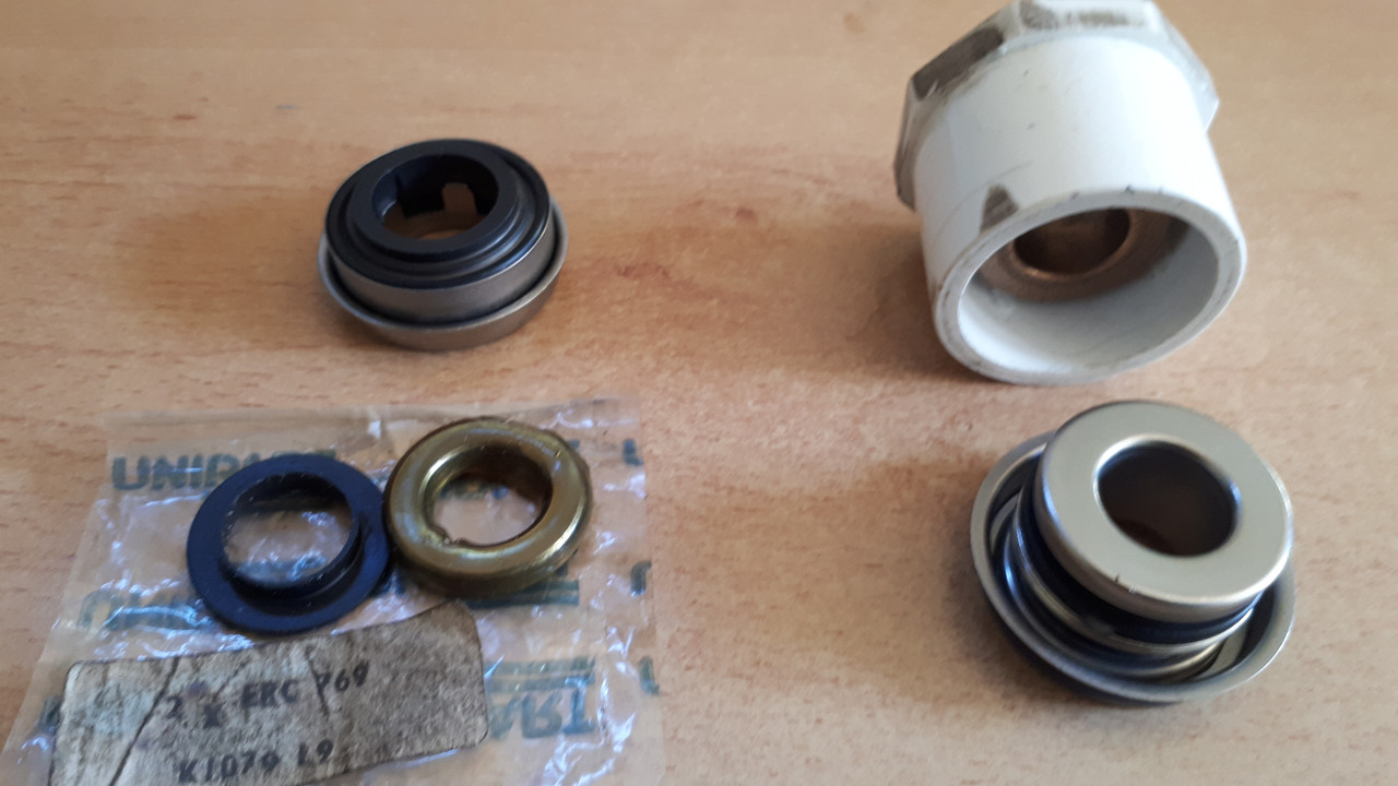

Some, like Tadek’s pics, are just a stationary part that presses into the pump casing, with a spring loaded carbon surface that seals against the rotating impeller. Issue with Jaguar versions is that the relatively soft cast iron impeller wears very quickly. One solution is as per Post #4, ceramic runner accommodated by shortened impeller. Sometimes (XJ6/12) there is a rubber seat between the ceramic runner and the impeller, this is to ensure that the runner spins with the impeller.
Setting this type of seal is tricky, pressing on the impeller simultaneously sets both the seal spring compression and the impeller/casing clearance, i.e. these cannot be set independently. You want the seal spring to be lightly compressed; compression is not so much for sealing as it is to accommodate wear. At the same time you want the gap between the impeller and the casing to be as small as possible without touching, for best pump performance.
Another type of mechanical seal combines both stationary and rotating parts and press fits to both the casing and the shaft. I.e. this type DOES have an interference fit onto the shaft.
As per Bills posts. Aftermarket for all classic Jaguar; imo newer and vastly superior because the seal and impeller can be set independently. With the appropriate setting tool (e.g. Bill’s mandrels), you can just blindly tap the seal into perfect position. Because the rotating part gets pressed onto the shaft it does not rely on the impeller, the impeller can be separately set to minimise the clearance with the casing, I usually press it on till it starts to scrape then pull it back a hair. Generally requires shortened impeller so that there is plenty of separation (Bill’s 3 mm) between the seal and the impeller.
Photo: On the left are from SNGB (stationary part, runner and rubber seat) on the right is aftermarket combined seal type together with a setting tool.
