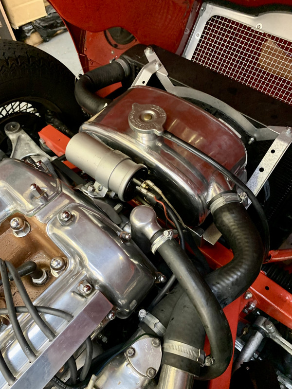

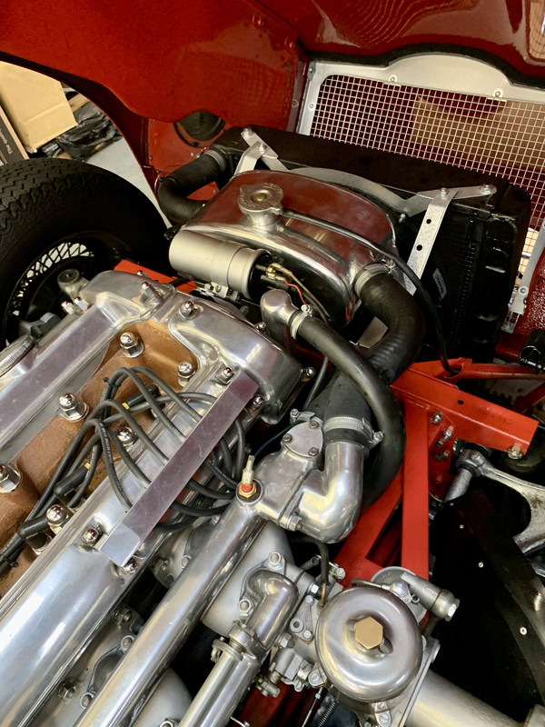

My steel tank developed perforations and leaks within the first two years after restoration from new (after market). Now my 3.8 lives happily with an Aluminium header tank.

For those looking for aluminium options, here's mine (Radtec) that I recently fitted and a copy of the original:

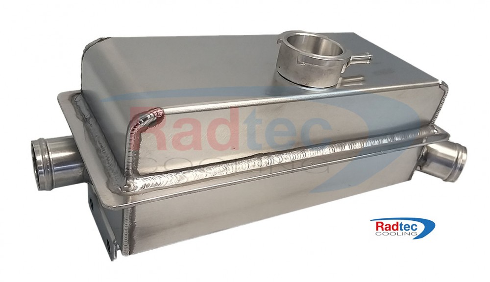

#13 Re: Header tank: Aluminium, brass or stainless steel?
Steve,
Are you talking of the rad or of the header tank?
I haven't seen an aluminium header tank from Radtec with that shape.

#14 Re: Header tank: Aluminium, brass or stainless steel?
Serge,
It's the header tank but I also have the radiator/fan from Radtec Classic Range too:
https://www.radtec.co.uk/shop/header-tanks/jaguar/

#16 Re: Header tank: Aluminium, brass or stainless steel?
You are correct with your observations, and I think Radtec use an old picture on their website.
My header tank was delivered last month after approx. 6 week wait for manufacturing process and testing. I’m very impressed as it’s exactly like the one I removed and their workmanship with welds and rounded corners is very impressive. The best I’ve seen and in keeping
I had a S1 radiator from them back in 2014 and it was finished like the header in your picture (square edged. I have just purchased their classic S1(4.2) aluminium radiator also and it’s exactly like my original 1965 metal radiator, with rounded/ribbed side casings. Again, a work of art in black powder coat.

#17 Re: Header tank: Aluminium, brass or stainless steel?
Good to know, pity that Radtec didn't update the pictures on their website.
I had given up on looking for aluminium header tanks as their shape was not satisfactory or the price quite expensive.
I finally decided on buying the SNG steel one, although knowing that it may not last long...
Yours looks nice and at a good price!
