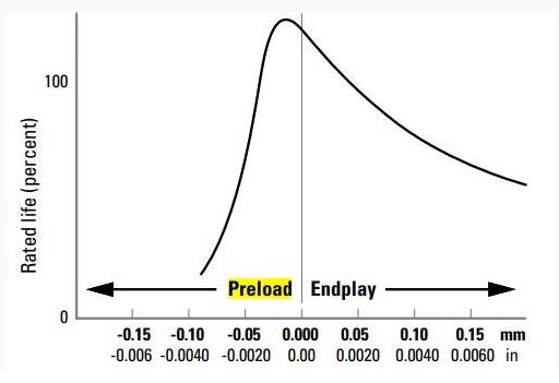

I worked in a brake workshop in another life, and when we found signs of inner race rotation was advised to apply a couple of dimples to the area with a centre punch, just enough to require tapping the inner race home on the axle. Timken's web site shows a steep decline in bearing life when a pre load is applied cold - end float needs to take account of operating temperature to avoid pre-load. Some british cars of the 40s-50s called for .003-.005 float, and provided means to adjust this finely - eg Rover used a round hub nut with 4 holes and a keyed washer with 13 holes to provide a 52 step vernier.

The main reason the fit of the bearings on the journals is a running fit, is for the benefit of servicing. An interference fit for the inner bearing would leave both the Cone of the inner bearing and the seal being left on the shaft. when, for whatever reason, the hub is required to be removed. Even mutilating the journal with a centre punch would probably result in enough localized interference to have the same result.
The following graph, is quite typical for Taper Roller and Angular Contact Bearings. You can see that the life expectancy of the bearing peaks in the Preload Zone.
For many years, I rebuilt precision spindles of CNC machine tools and without exception, the bearings are arranged in Preload. Often, Machining Centers working on large dies with small diameter tools to get into small corner radii, may run 24/7 at revs in excess of 20,000, and will exceed in a few months, the revs of an E Type wheel bearing in more than a typical life time for the car.
For those bearing systems of machine tools that are greased once for live, the amount of grease used is typically only 10% of the available air space between the balls in the bearing. Accordingly, when I fit new wheel bearings, the amount of grease used in only what can be pressed into the bearing and compared to a machine tool bearing, is an overkill.
To preload the front bearings of an E Type (the same bearings and axle dimensions of a small box trailer), without some form of restraint, will ensure that the bearings spin on the shaft. So truth be known, its probably the running fit of the bearings on the shaft that led to having an End Float specification. There are many cars today that use Angular Contact Bearing with split center races, so that when the retaining nut is torqued up tight, the bearings achieve the preload to the extent built into the bearing.
