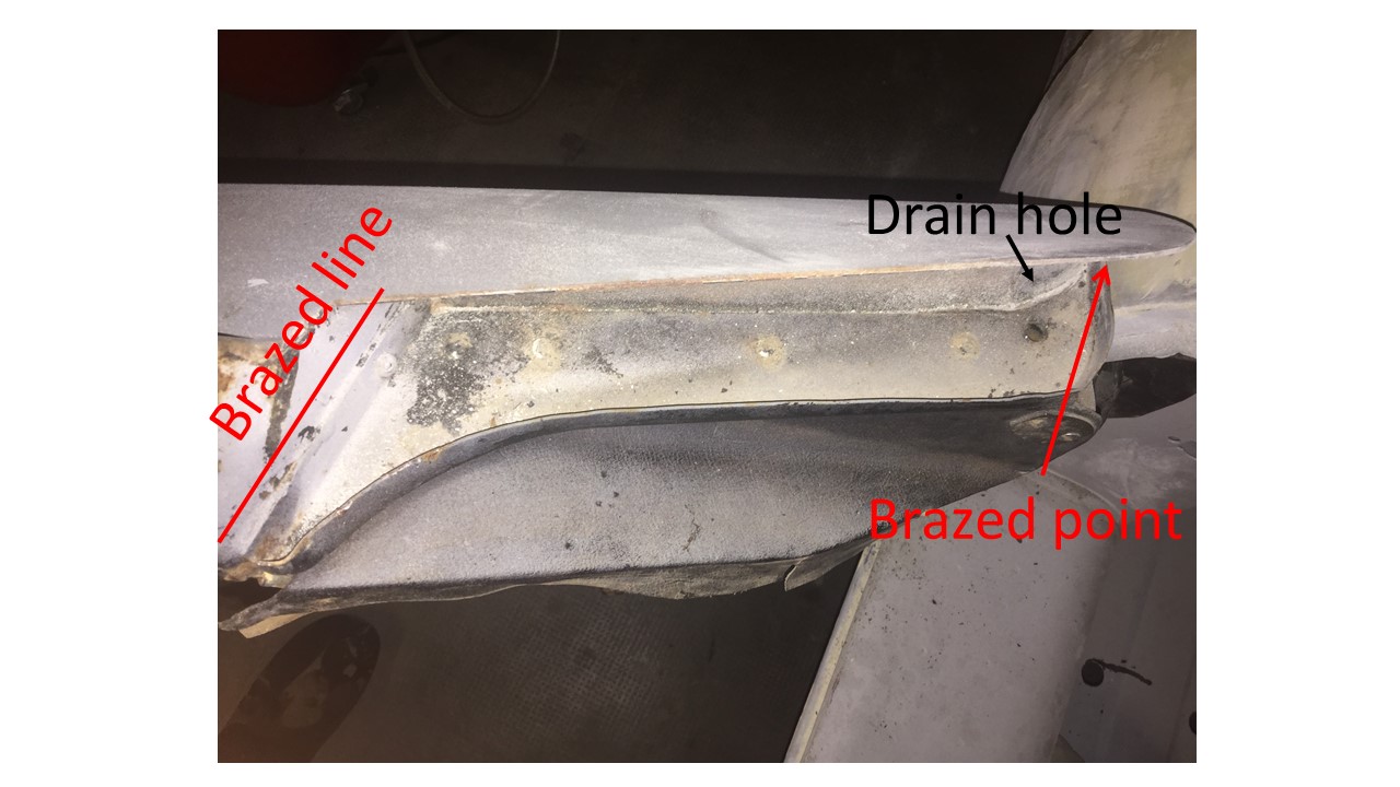

I'm resurrecting this thread about door accommodation as I am discovering the strange design of the top drain channels. On my OTS they are not only pop riveted at the top of the door frame, but brazed on two locations too:
Can anyone confirm it is nominal? Thanks!
The frame-channel seam is sealed with some material that has dried in time, letting water to ingress. As a result rust has proliferated in between. So dismantling is on order to fix it.
Philippe

#28 Re: New To Doors, does this look right please ?
Post by andrewh » Wed Mar 27, 2024 9:01 am
It looks correct to me. I will try to check mine this morning and post unless someone gets there before me.

BTW another question: how waterproofing is made along the horizontal line in the photo, i.e. between the length of the drain and the door frame? By seam sealant, brazing or lead loading?

#30 Re: New To Doors, does this look right please ?
Post by andrewh » Wed Mar 27, 2024 1:42 pm
here you go , I hope this helps.
The door seal will help stop water from dropping onto this shelf, but some will make its way there and thats where the holes come into play, the water drops down into the bottom of the doors and theoretically drains out of the slots in the bottom of the door.

Post by Philippe-J. » Wed Mar 27, 2024 3:33 pm
It surely helps, thank you!
It can be seen in the second picture that the seam between the rear of the drain and the door frame looks like filled with brazing.
Not so sure however about the seam along the length of the drain. It seem to be empty. I guess that filing it with PU sealant will do no harm, will it?
Regards.
Philippe-J

#32 Re: New To Doors, does this look right please ?
Post by andrewh » Wed Mar 27, 2024 3:36 pm
I am sure you should seal it from allowing any water to get between it and the door frame/ skin. Andrew

#33 Re: New To Doors, does this look right please ?
Post by Philippe-J. » Wed Mar 27, 2024 4:23 pm
That's what I'll do.

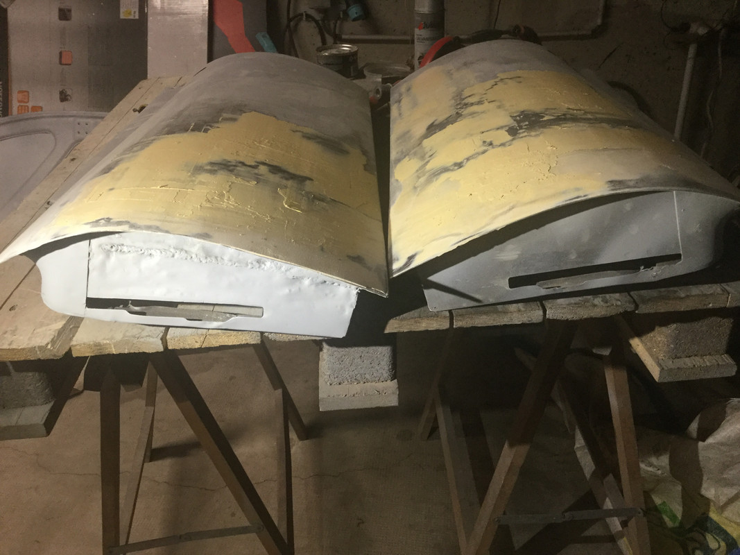

Post by Philippe-J. » Fri Apr 12, 2024 7:34 am
Folks,
another question about my doors. One of them is quite dented on its front section, the one on the left:
Is this section seen once the door is installed? Should I flatten it (with lead loading)? Or can I let it as is?
Thanks for your opinion.
Philippe
Philippe-J
Posts: 3856
#35 Re: New To Doors, does this look right please ?
Post by Gfhug » Fri Apr 12, 2024 10:34 am
Philippe, you don’t really see that section once the inner panels are fitted to the door, even when the door is open as the panel extends beyond the face and hides it when closed.

You can see parts of that panel from inside the car when the door is opened. It is only a small expenditure of time to smooth the metal and then fill and sand with a good quality polyester filler. If you just leave it you will notice it every time you open the door for as long as you own the car. Just my opinion but you never regret doing a quality job.
