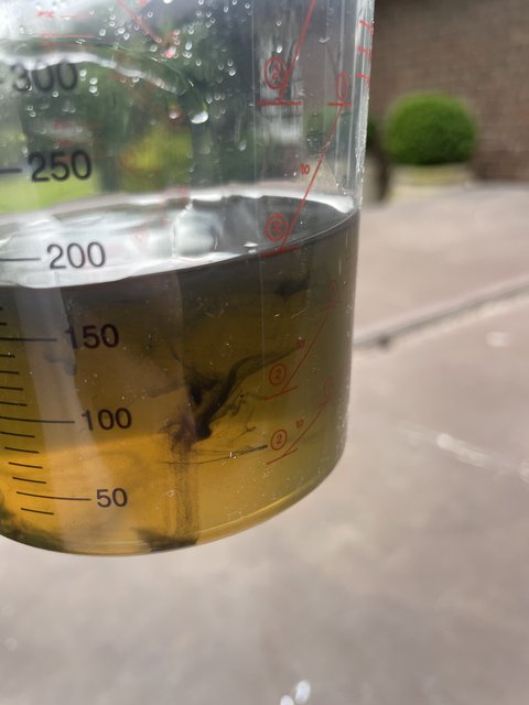

Hi guys, noticed the clutch fluid bottle was really dark in colour. No leaks anywhere no fluid loss and the correct cohene pipe used. Can’t figure out why so dark cars only 1000miles since rebuild, every item is new except the metal pipe connecting from the master to the low pressure hose.. (new one on its way) any thoughts guys?
Pic of the fluid drained out ..almost looks like oil contamination…

Hmmm....looks more like the rubber seal in either the master or slave is breaking down...and if so clutch failure is not long behind...

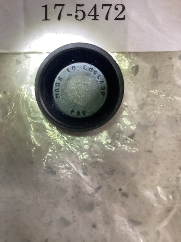

Almost certainly the Clutch Slave Seal is wearing down. A common problem when potentially “generic” 7/8 inch seals are used as opposed to sourcing OEM parts.
The original Lockheed 7/8 inch seal :-
A generic 7/8 inch seal offered by various Sellers :-
Also when reassembling the Clutch Slave Cylinder check the bore for any rust or irregularities for the seal to catch on, especially common when bleeding the brakes as the seal could pass past the point of “normal” operation to encounter a different operating surface. I had all my old Brake and Clutch cylinders re-sleeved in Stainless Steel, which then came back with perfectly honed internal bores.

That shows the discolouration .. only 1k miles in with all new parts, I cut open the cohlene pipe to see if it was breaking down.. Looked absolutely fine.

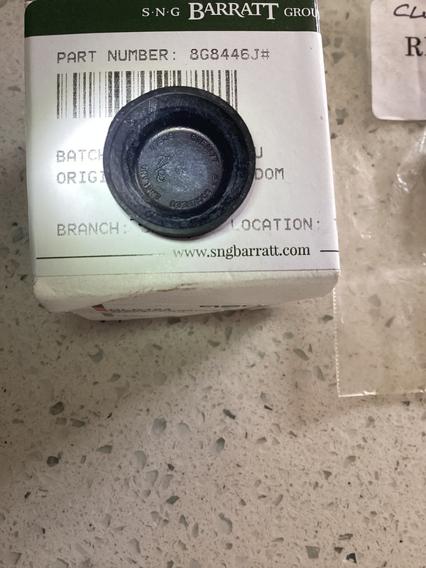

As per my photo, the OEM seal is pictured on the supplier’s box. If you look on their website it is shown as “Jaguar”, but on closer zooming in on their photo of the seal, you can see the “Lockheed” lettering.
Dave
