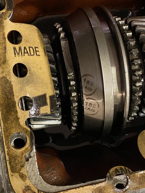

I have tried two things with my moss gearbox that is on the bench: Filling it with another oil, and heating it with a heat gun. It makes engaging and disengaging 1st and second a little better, but still very hard.
I have seen those tags on the synchro, could it mean that they have been replaced at some point?
I know that my car was lightly restored in the usa, before it was stopped for years.

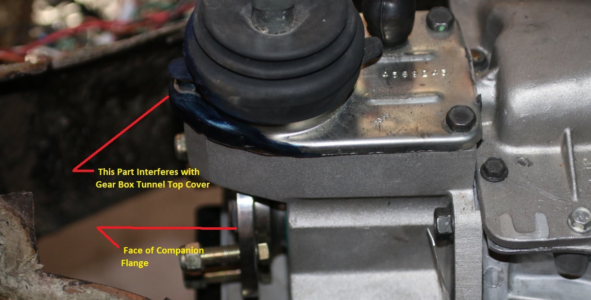

Chris Wrote:
I'm currently fitting a T5 total kit supplied by The Driven Man, sourced by the owner of the car to an S3 E Type and have had numerous issues.
I'm not sure if the same applies to S1/S2 cars, but the rear of the gear lever housing, a part specific to The Driven Man assembly, interferes heavily with the transmission tunnel to the extent that the tunnel cover can't be moved forward enough to be attached to the rear surface of the fire wall. That affects the fit of the Centre console, which in turn, affects the fit of the Radio Facia Panel. The blued are in the following picture shows the area that fouls with the Top Cover. The Blue is bearing blue I applied to see exactly where the interference with the top cover was. This was just one of a list of issues experienced with The Driven Man kit.
The following picture is of a T5 Gearbox that Mal Woods in Queensland supplies with a gear lever housing CNC machined from billet aluminum. You can see from this picture; the rear of the gear lever housing is actually forward of the Companion Flange and therefore, well and truly clears the transmission tunnel.
Hello Chris,I was checking the “drivenman” conversion that looked appealing
