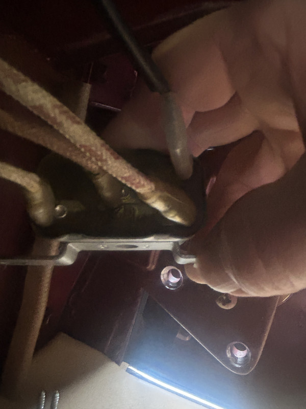

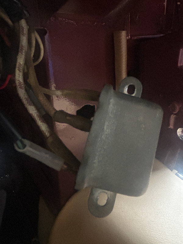

Thanks Colin and Andrew, I thought I had connected the solenoid relay as it was originally but could be wrong, see attached photos.
According to the wiring diagram its connected correctly,
W/Y on W1
N on C2
R/W on C1
B/G on W2
I will try disconnecting the R/W wire as you suggest and see what happens, will get back with the result.
