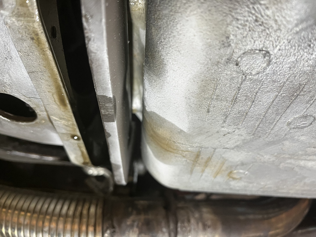

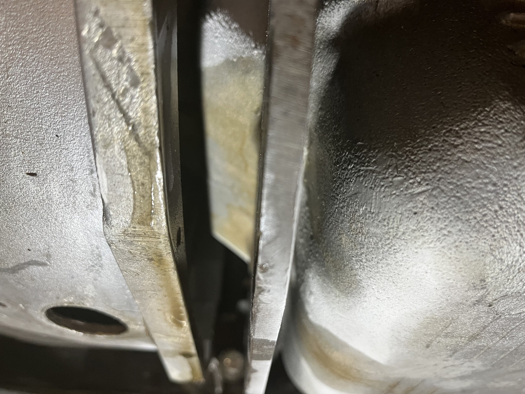

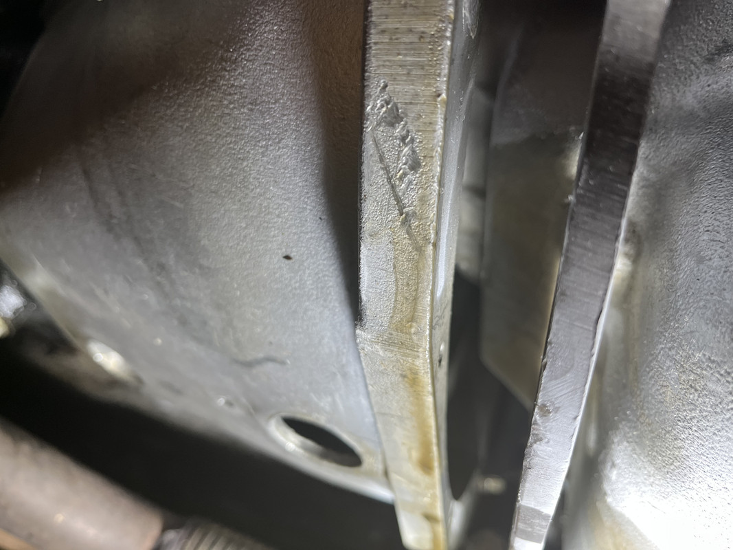

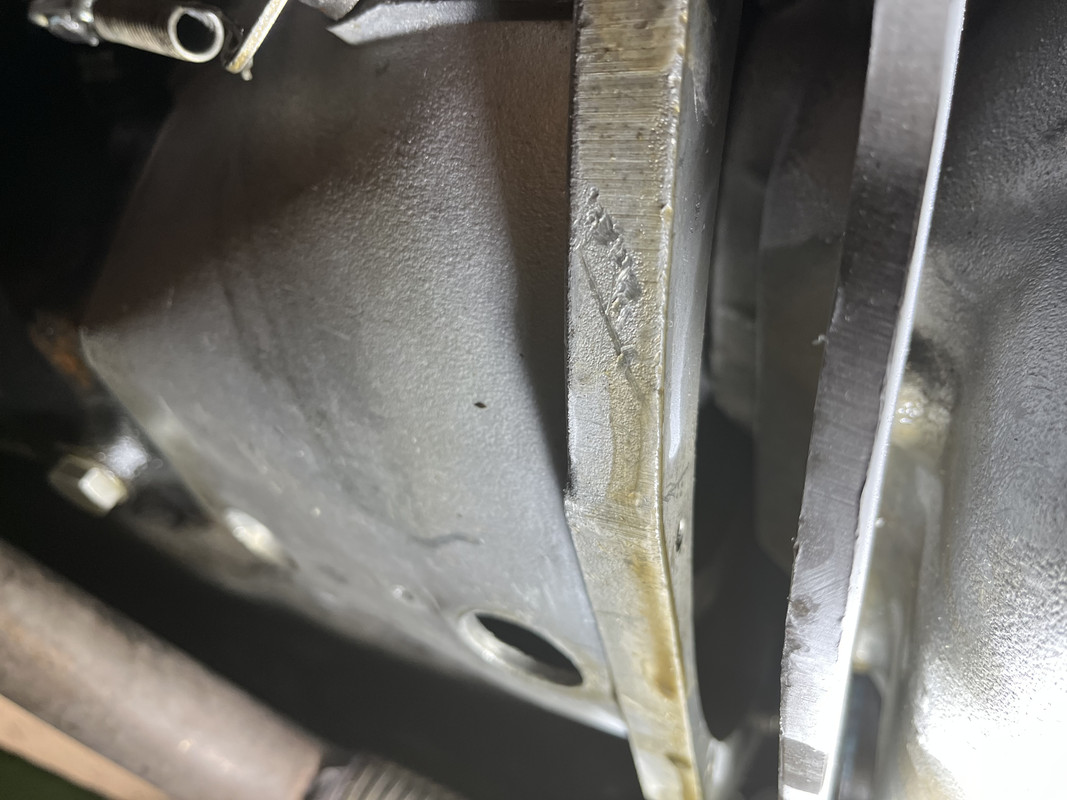

Good Evening,
Could I have opinions as to whether my sump or rear main is leaking please. I powdered the inner face of the flywheel, rear of the sump, reaction plate and bell housing. Then took it on a 15 mile run, including about 7 miles of motorway at constant 60 mph. It should be noted that if I drive it on A roads at varying speed it is completely dry. As you can see all the powder has gone from the flywheel face, although it feels damp but not wet to the touch. There is evidence of significant oil down the back of the sump.
Many thanks
Simon Brown

Hi Simon..endoscope into bellhouseing...if it crank seal then oil will be running down from crank flange and probably spun all around behind flywheel...Steve
