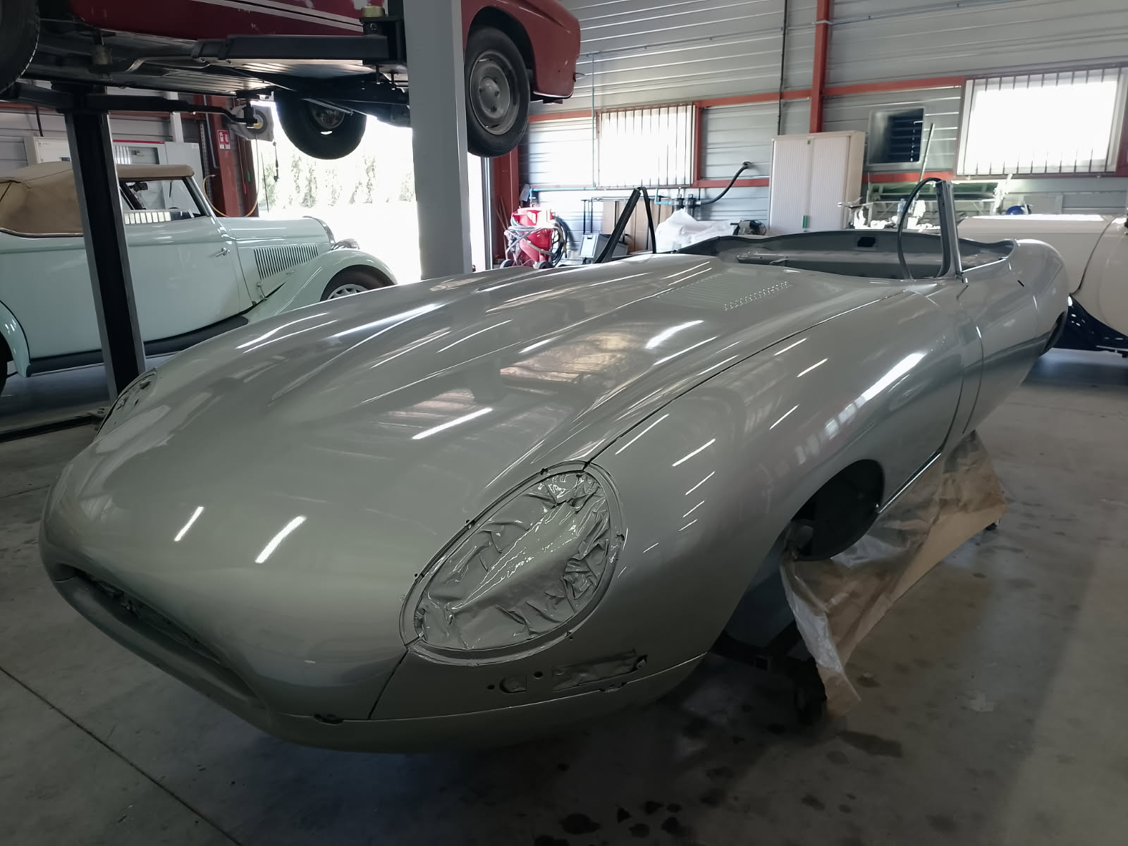

My recent experience about OSG is that of a labyrinth. My troubles were doubled by the fact that I am in France, so difficult access to UK paint providers, and that said original reference were night impossible to find today. I also found the "original" OSG on photos a bit dark to my taste, or too much "bare brushed aluminium" aspect for the light shade, see Clausager's book cover (even if the car paint appears non original). After a long investigation & some discussions here I elected a false OSG, I mean a one by Aston Martin, from an earlier period (2002+): reference AST 1180. I was appealed by its light greenish shade, or should I say bronze.
I'll be following your quest in order to know about modern available codes for the right OSG, which remains a mystery to me
- Attachments
- MJYA2905.JPG (182.05 KiB) Viewed 2057 times
