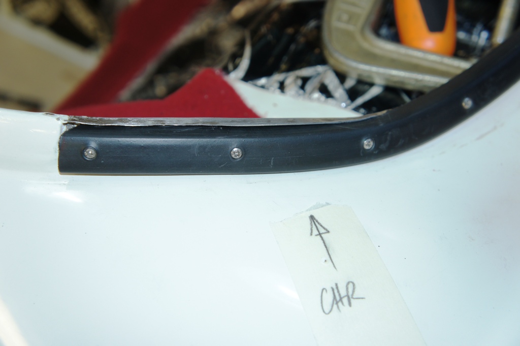

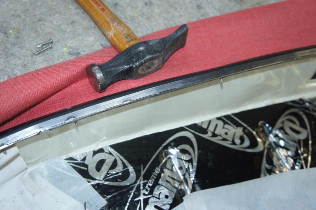

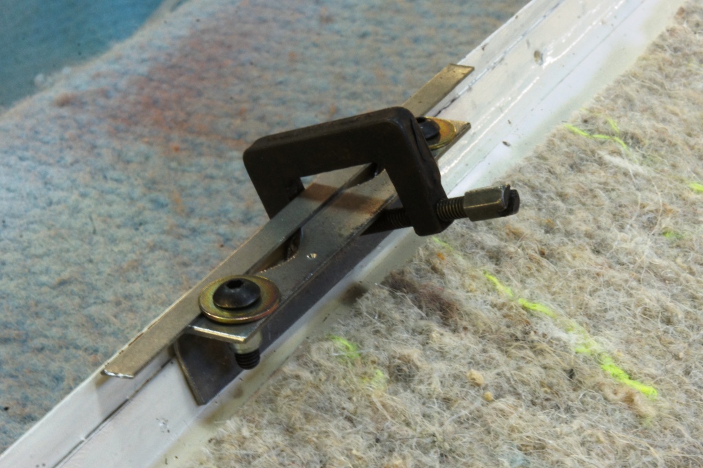

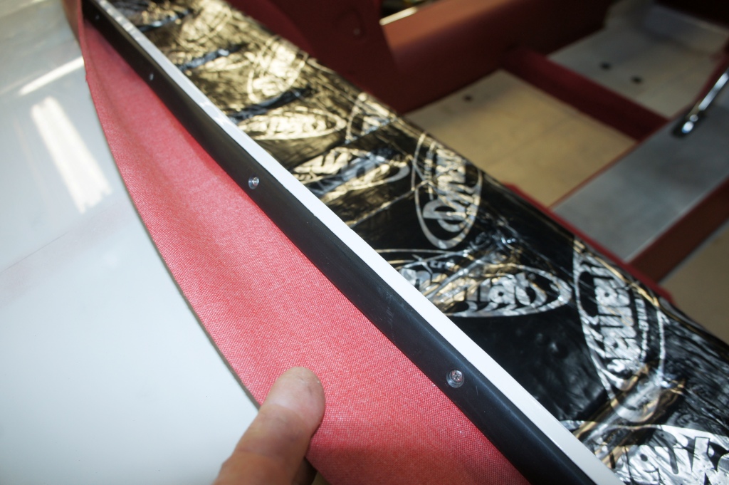

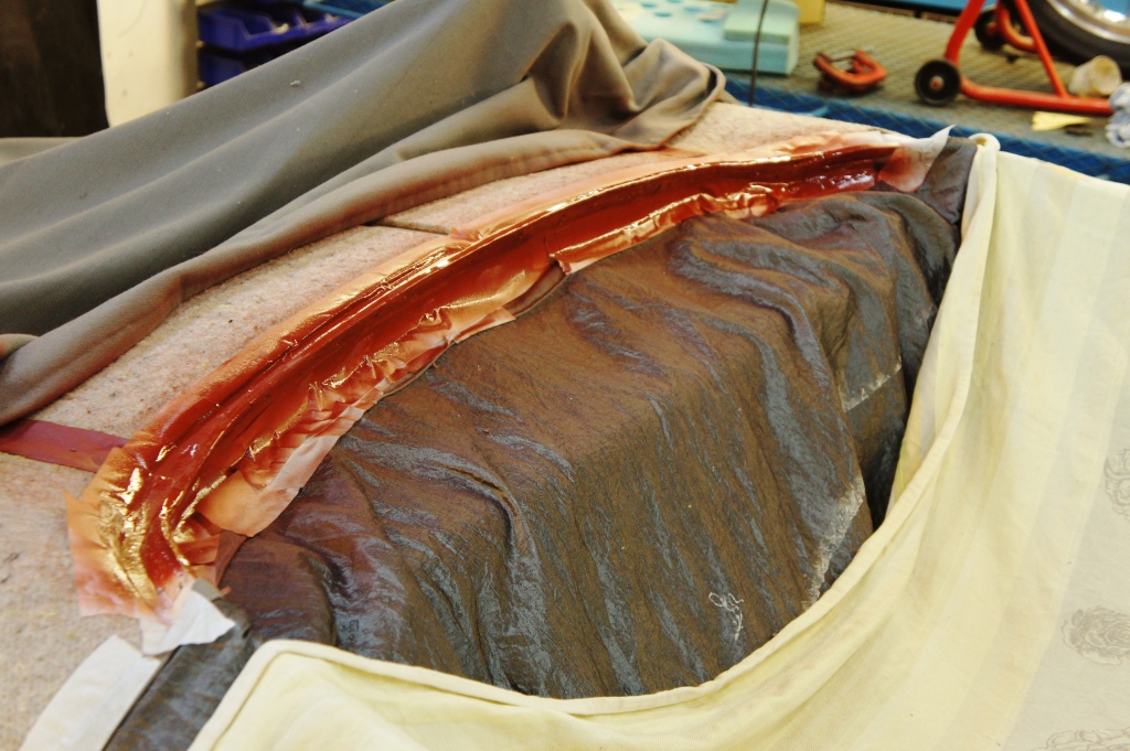

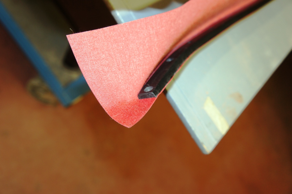

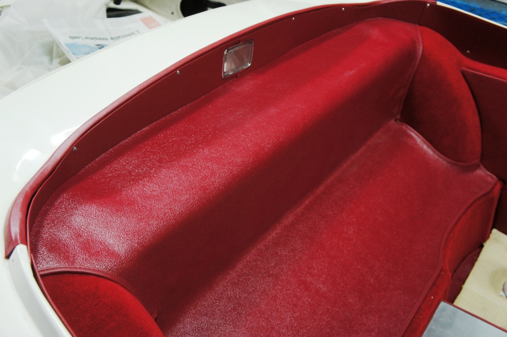

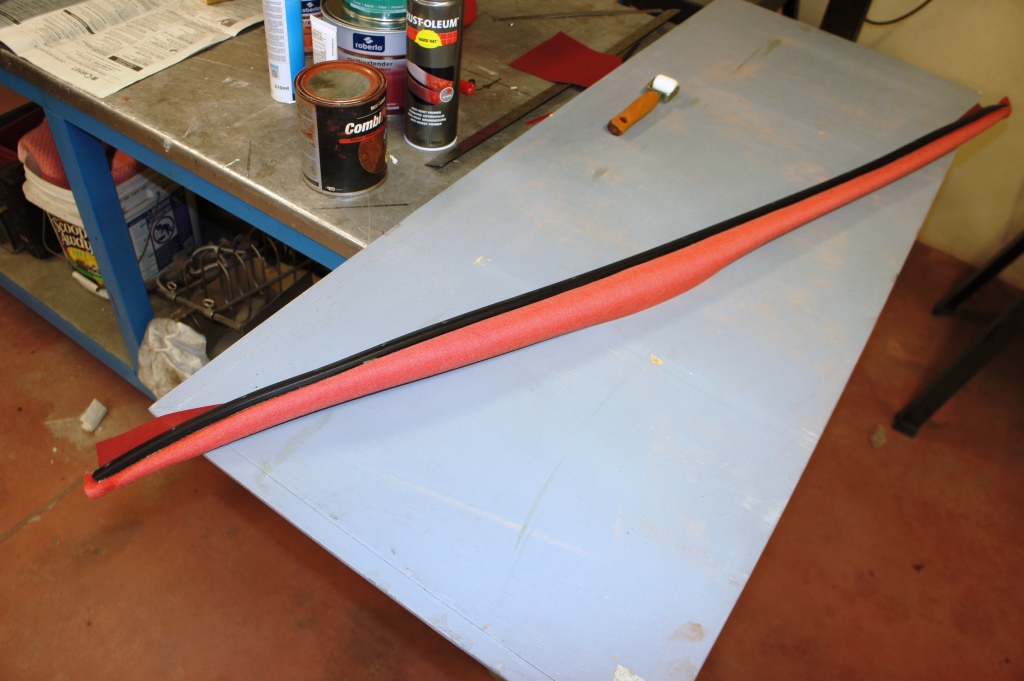

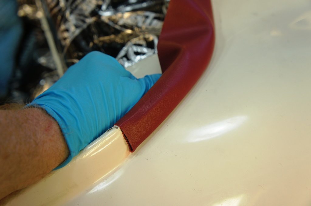

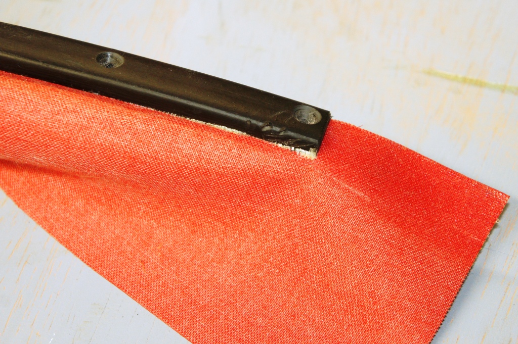

I'm plodding along with the re-trim, and it was time to fit the tack-strip that takes the hood canvas attachments - I'm using a composite hard-rubber version
My body-shell has various buggered-up zones, thanks to the PO and his set of incompetent artisans, and the tack-strip zone in front of the boot is one of them.
The metal has had enough self-tappers into it to qualify as lace, but above all the lip that constitutes the upper edge of the tack-strip seating area was formed in such a way that for about 80% of its length the tack-strip could only be 12mm high instead of the 20+ mm of the original shell.

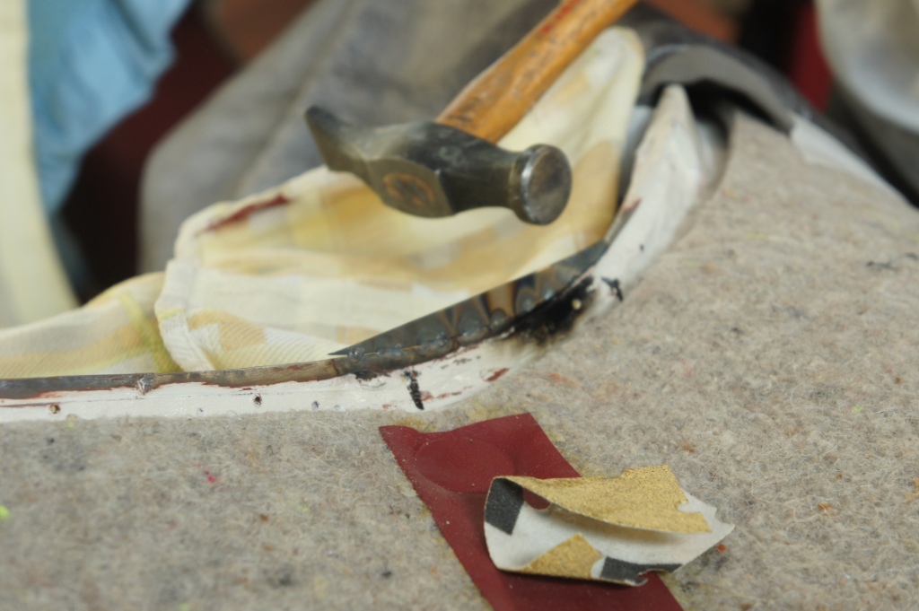

It was suggested to me (by a well-meaning Jag restorer) that if I bashed this flat I could seat the tack strip comfortably as there would be no lip to get in the way ..............
Determined not to agonise, and to quell the perfectionist in me, out came the dollies, hammers - and hey-presto, no lip ; followed by filing sanding, red-oxide, and new paint.
BUT, there's a lot to be said for moving slowly and thoughtfully.
Why did Jaguar put a lip there ?
Because the lip takes all the loads from the hood, not the screws.
Now I'll have a hood where the shear of the canvas into the tub is going through twelve #4 self-tappers.
I don't suppose anyone else has been this lazy and got away with it have they ?
Here are some pictures to show the vinyl-trimming of the tack-strip, just to prove that it's not because you get most of it right that you can't still go and shoot yourself in the foot.

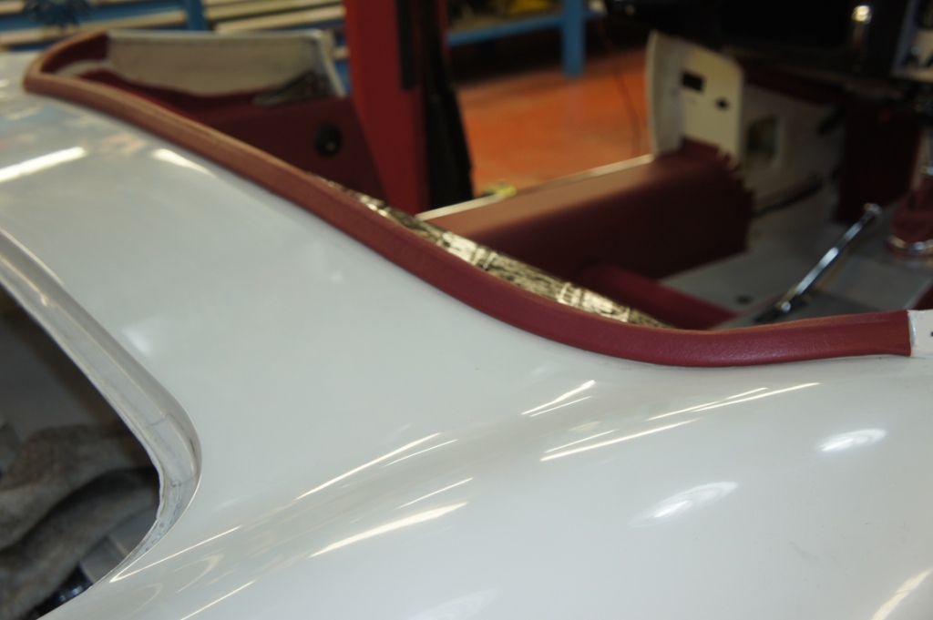

Rory, I too went away from wood, but with the lip still in place.
Have used a fan belt, and the tapers are placed from inside.
Also, I did not wrap the vinyl around. This is absolute nonsense because it is a moisture trap (particularly if you use the wood strip) and its colour will be seen under the hood. Unless you plan to have a red hood.
Here is a pic of the strip fixed:
And these after trimming:
Ralph

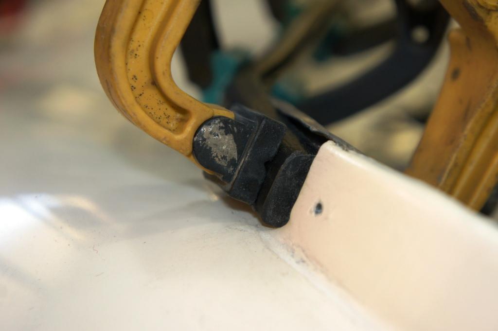

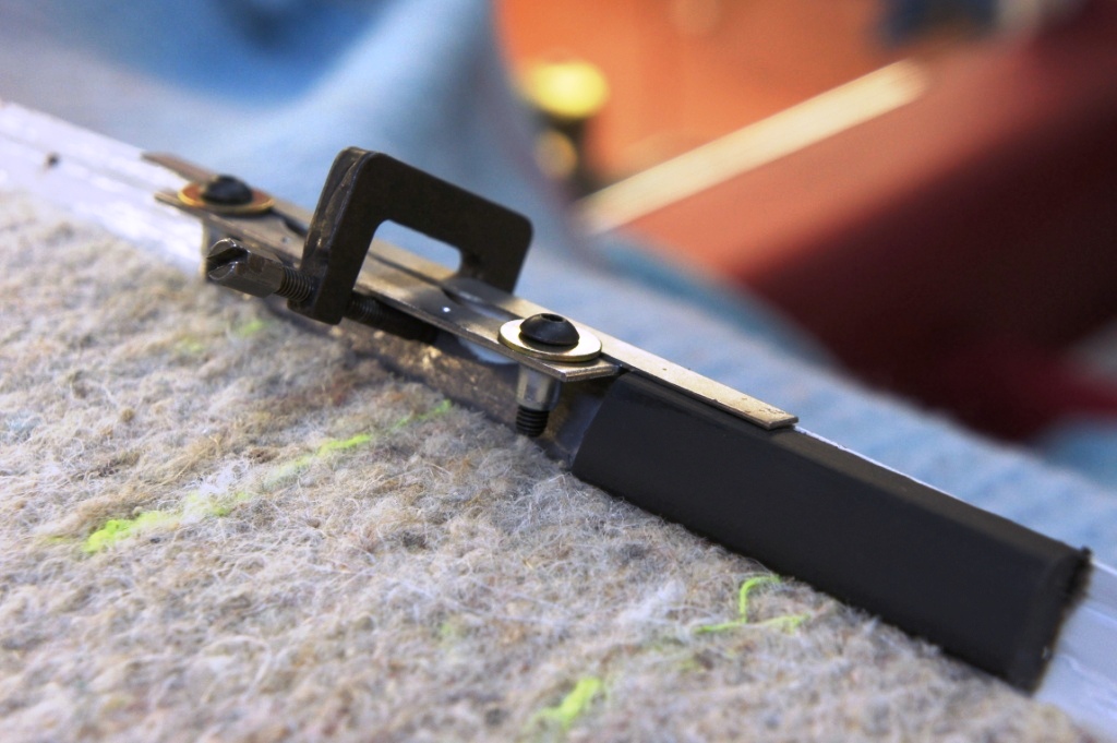

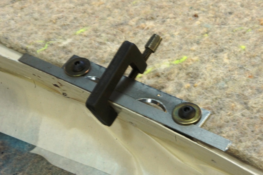

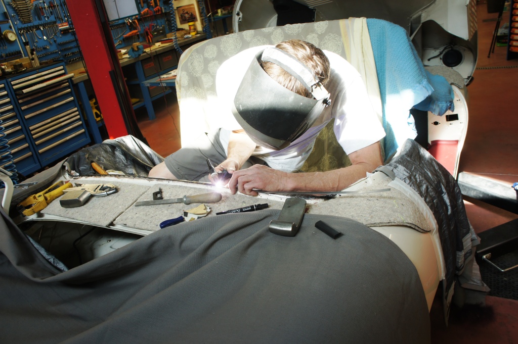

Thanks for the input boys.
As Harold Wilson said, 24h is a long time in Car Trimming !

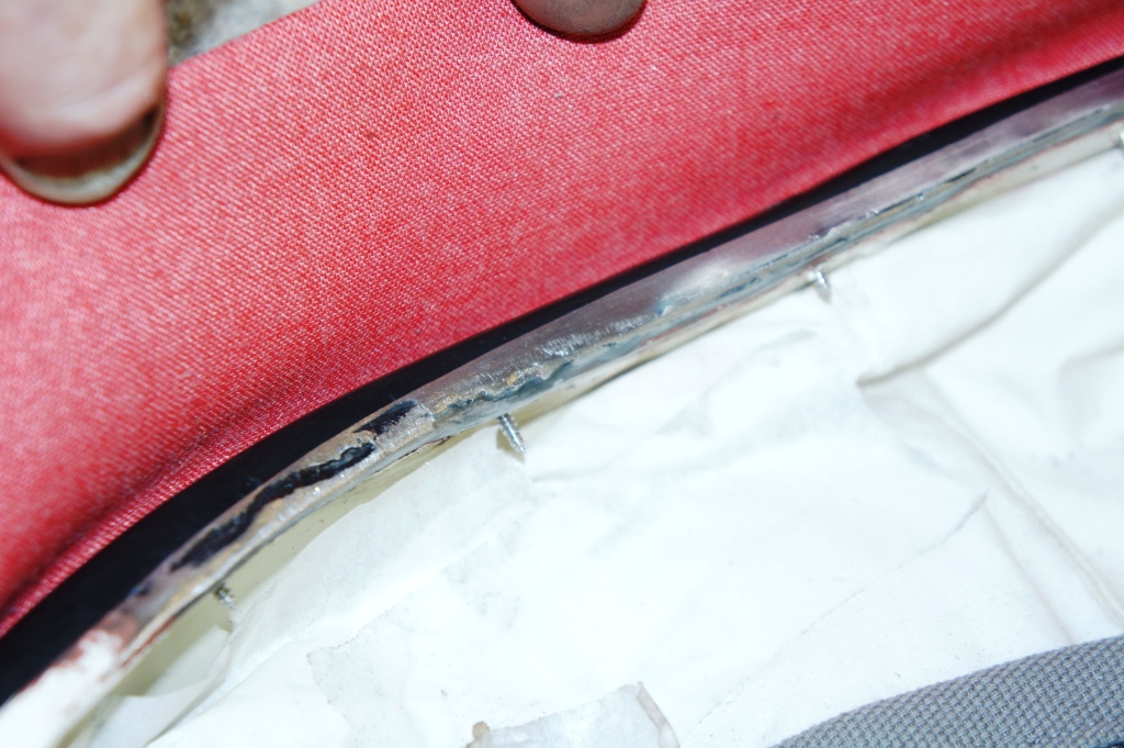

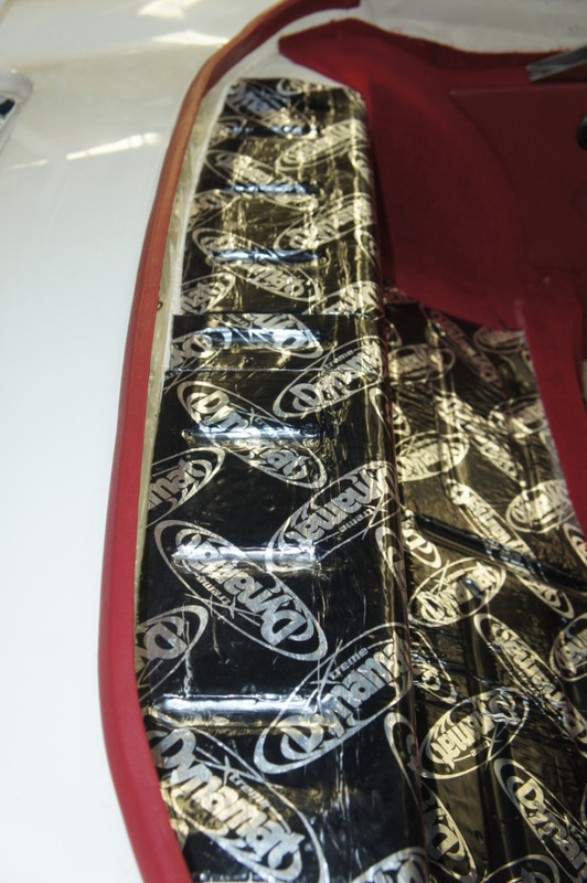

Favours called in, 7mm strip guillotined, Yvan-the-TIG summoned with promises of a good breakfast, and an hour later Bob's-Your-Uncle. (Our non-native speakers might like to PM for translation).
First some vertical additions where I was short of height.
Then some free-hand-magician stuff.
Of course I had made a jig to hold the strip in the right place and at the right angle, which he promptly ignored, but I felt I had done my bit and shown willing.
This shows the graft where old-edge joined new-edge.
I stayed with red for the edging, Ralph, as black would have shown up the less-than-perfect alignment of the rear trimming panels ............
So I didn't need to go and set fire to the whole thing after all.

I did not mean to you to leave the tack strip in black, but to trim it just from above without wrapping it in the vinyl. See my above pics again, the vinyl it cut a couple of mm above the lower edge of the tack strip.
P.S.: I didn't see the required slots for the hood cover hooks? :scratchheadyellow:

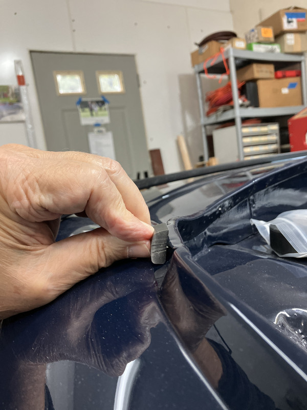

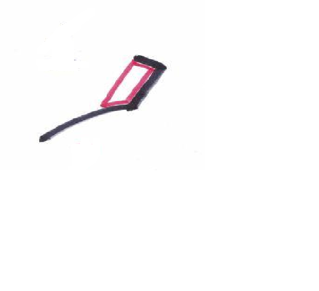

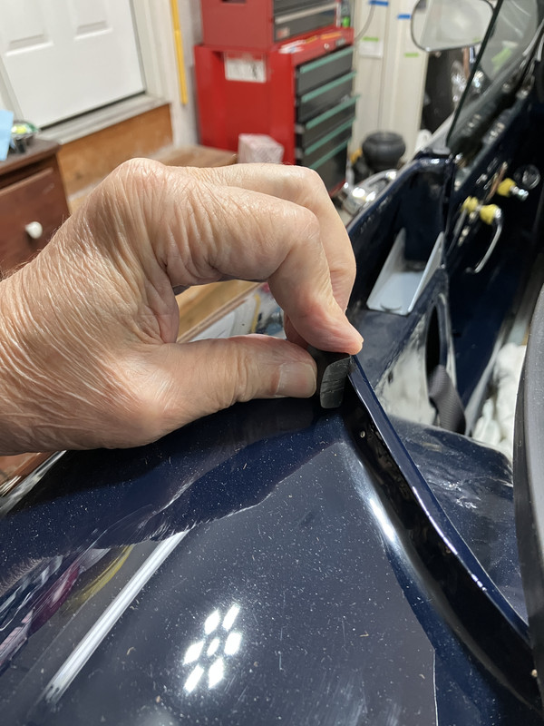

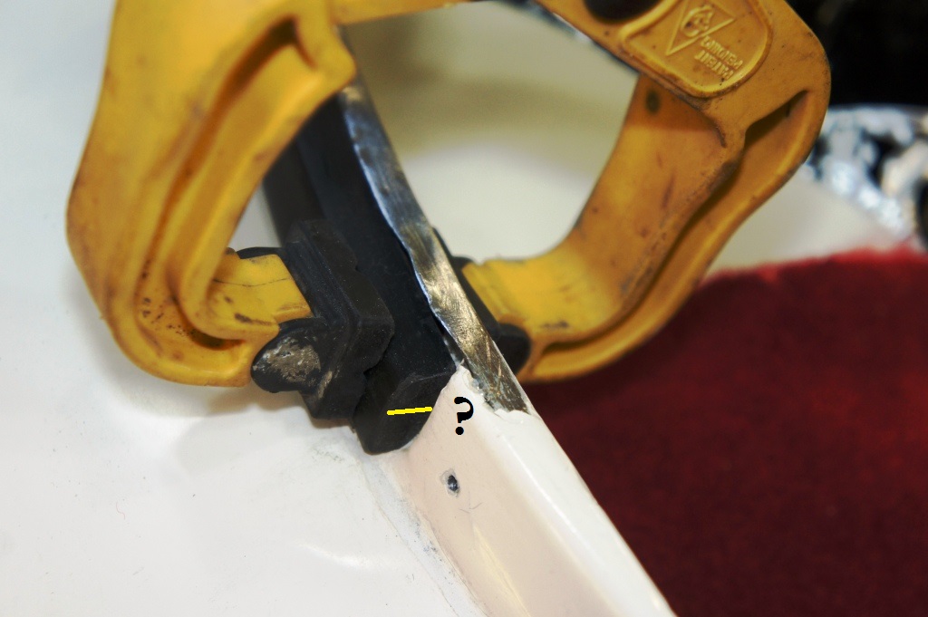

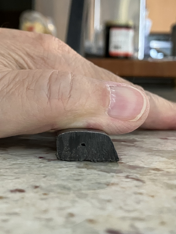

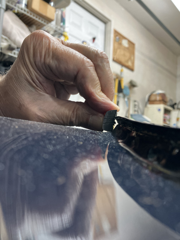

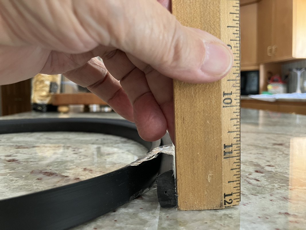

Does anyone have an opinion of the proper orientation of the tack strip ? There seems to be a narrow flat-ish edge and a narrow pointy-ish edge. The wider dimension has a flatter side and a more curved side see pics.
Image.
sorry for the duplicate pic

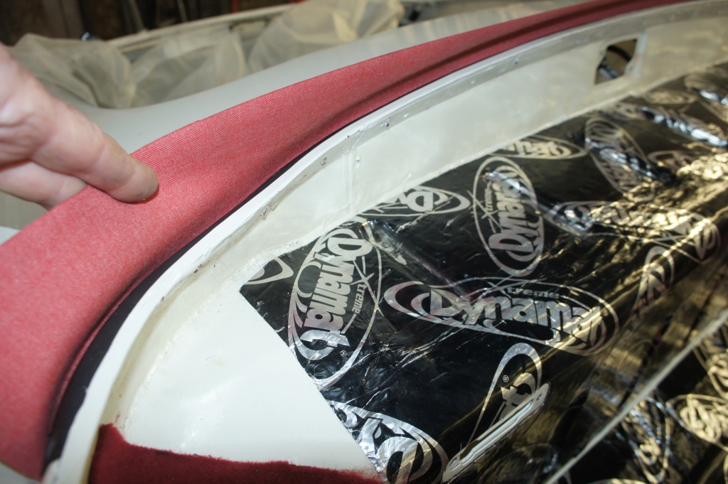

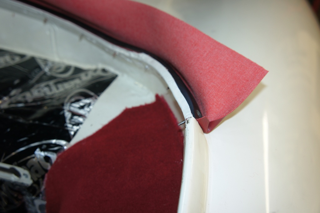

uh oh.
I think I have a big problem here. did the paint and filler build up and close up the opening or did Jaguar hammer the lip down after fitting. the gap is not uniform all the way around either.
