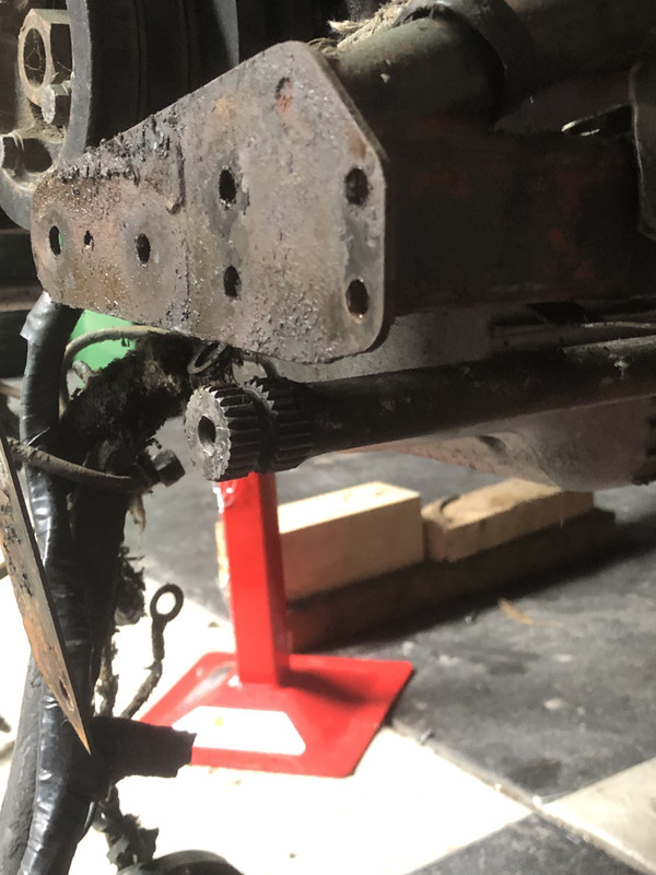

Yes, I agree that some investigation should be made to see why the bolts through the tear drop won't come out is warranted, But Freddie is wanting to replace the lower wishbone bushes, and to do so, the blocks at the front have to be removed, but the picture frame not.
The following picture is of one I prepared earlier
The scope of work was to refurbish the front suspension and brakes, plus repair the bottom member of the picture frame. If not for the damaged picture frame, it would not have been removed. The suspension components were removed prior to removing the picture frame. If there is no reason to remove the Torsion Bar, removing just the lower wishbone and leaving the Torsion Bar in place is not a difficult job, and considerably less work than removing the Torsion Bar as part of the exercise. Even if the Torsion Bar was to be removed, I still remove the lower wishbone from the Torsion Bar with it in place.
Often, due to corrosion, the lower wishbone can be difficult to separate from the forward spline of the Torsion Bar. If it isn't going to move with firm hand pressure, the center hole in the front face of the Torsion Bar facilitates nicely, the use of a small, two legged bearing puller. I clean the front face of the Torsion Bar well and allow penetrating fluid to soak into the splined joint, then use the gear puller to apply light pulling force to the lower wishbone main beam.

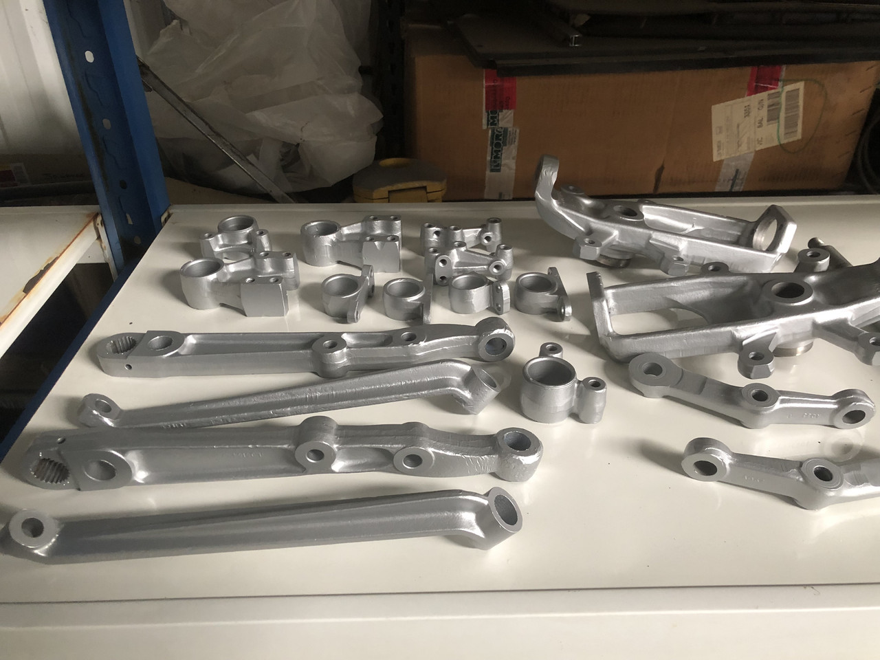

The following picture shows the front suspension parts cleaned, replated and ready to assemble.
