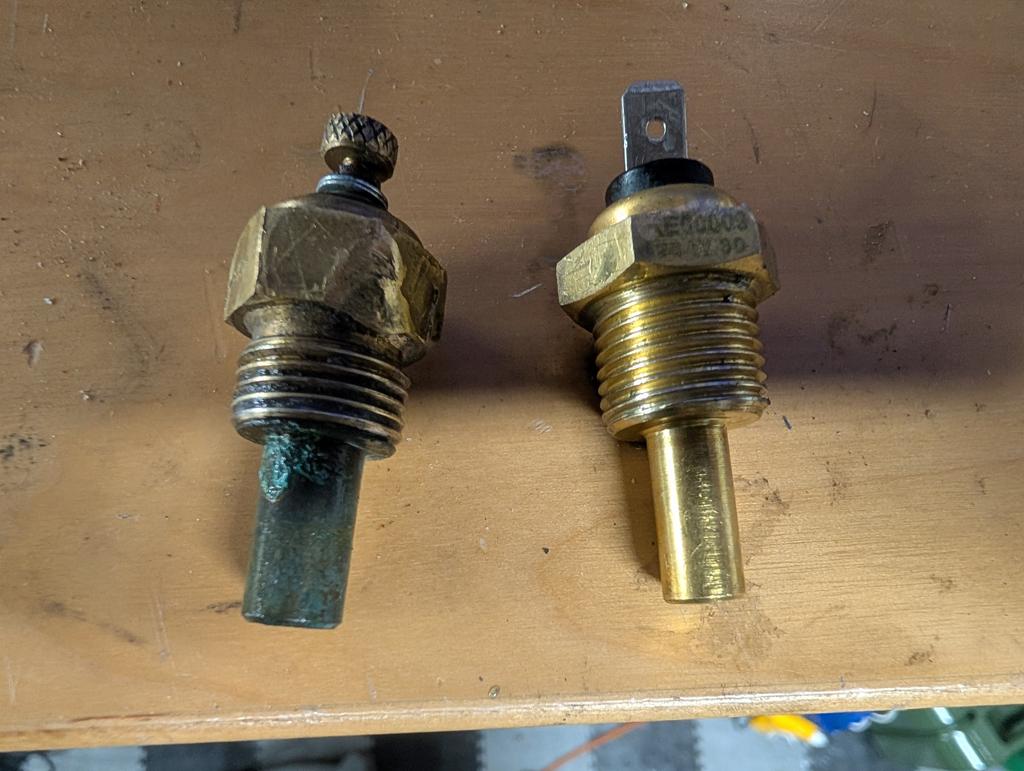

Had the same problem with my 3.8. I noticed that there was still good thread below the reach of the sender unit. I just happened to have on my shelf a generic sender unit with a much deeper reach which fits tightly and works perfectly.

Picked up a generic marine sender from https://www.asap-supplies.com/products/ ... pt-ke00005 which has longer threads than the standard one:
This grips the remaining thread in the inlet manifold securely.

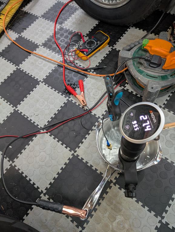

Before installing, I wanted to check the calibration with the gauge in the car, so rigged up a test circuit with some jump leads and a sous-vide cooker:
This shows that the sender is actually pretty much spot on from around 40-100 degrees C.
All installed, no leaks, engine up to temp with a working gauge. Thanks all for the suggestions.
