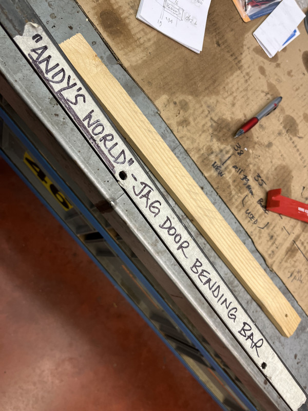

So in desperation .................. and you have to be pretty desperate to try this - bearing in mind that when I suggested this to Andy Rayner at Hutsons he said "Welcome To My World, Rory", which those of you you that know him will read with a smile .................
So my 6-foot length of 30x30x3mm T-Section steel is now named after Andy.
You need decent 6mm thick semi-penny washers behind 25mm x 6mm bolts going through the top and bottom trim holes on the rear edge of the door, otherwise (ask me) you can actually deform the panel around the holes.
Ever aware that I might be about to ruin the doors, and the paint, by applying the greatest torque I could possibly obtain with my two bare arms, I can tell you that our doors are surprisingly flexible AND I have indeed managed to correct their alignment.

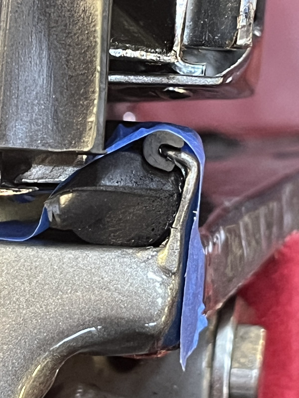

B-Post Seals :
Nothing remotely "machine-shop" and 0.01mm-precise about this, but it might inspire somebody.
Finding the door-seals too "fat" is a very common complaint - I've even tried to get COH Baines to consider making a more slender version, but they're too busy Virtue Signalling to actually reply to my email.
The bottom one is quite easy to narrow down, even in situ, provided that you accurately constrain the rubber, adequately protect your shell, then use a coarse flap-wheel on the grinder (I use 80-grain) that cuts against your constraining and guiding edge - I used a 4mm plastic 40x40 angle "martyr" last time.
The against is critical, the wheel direction needs to push the rubber against the martyr, which behaves as the edge of your guillotine.

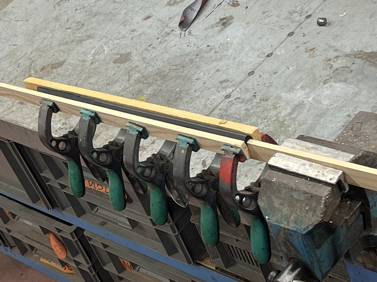

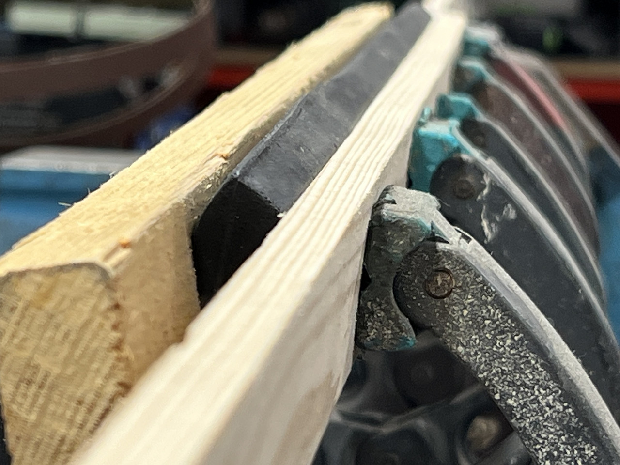

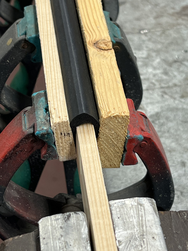

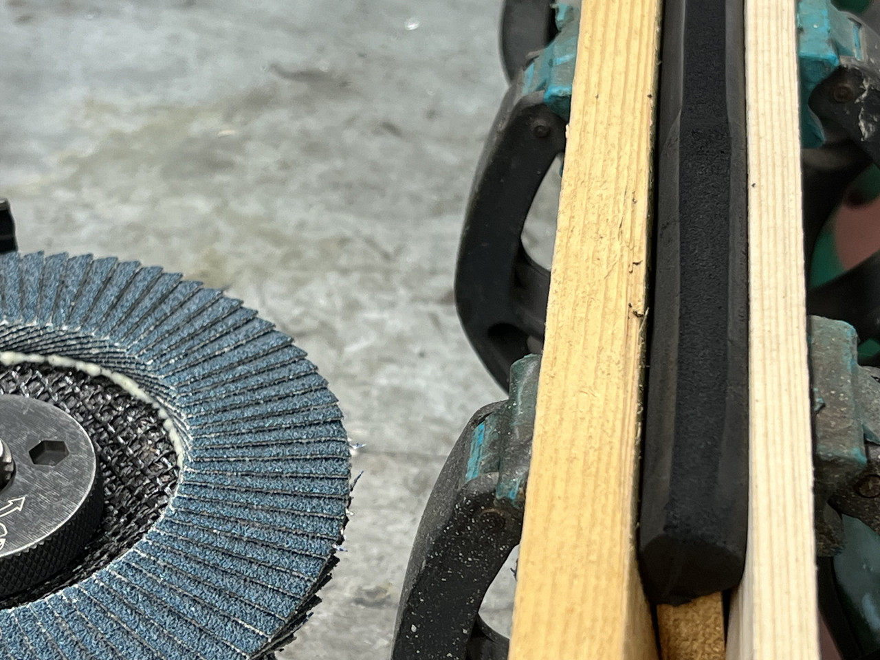

The more complex B-post seal - above - is a lot harder, and has to be done off the car.
I found that by stretching the curved length along a piece of 10mm pine strip, about 30-40mm deep, taped in place to begin with, with sandwiching pieces of pine strip on either side held in place by spring loaded clamps, you can use an 80-g flap-wheel to remove material in a pretty controlled way.
You use the adjacent cheeks, whose height you can tweak, and whose relative inclination can be adjusted, as a register for your sweep of the grinding disc, so you can remove material in the specific areas that are critical to the perceived thickness of the seal when you close the door.
Well, slam if it's my car :scratchheadyellow:
In this way there is little tendancy for the abrasive to "grab", tho' you need a good abdominal core to make those lateral passes dead regular and flat :lol:

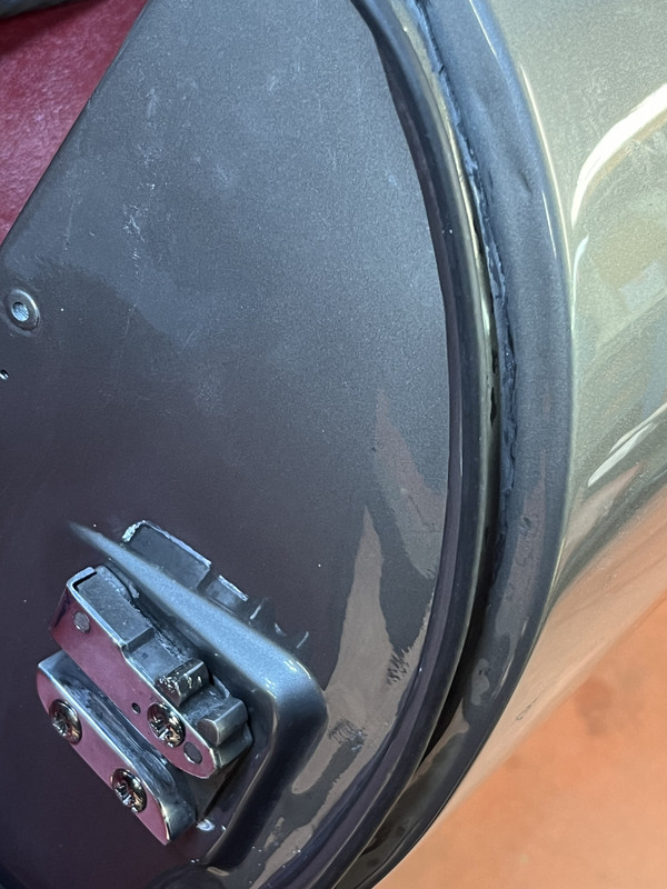

The idea is to leave the "sealed" and visible outer-edge of the seal intact, and just remove - and inevitably leave rougher - the hidden rear faces.
I have always uses Loctite 5910 - sparingly - to retain the seals, and it's obviously critical to let this cure with the door shut - but I always use 10 strips of masking tape across the rubber to stop it rotating during the curing, as the adhesive can behave as a grease and you can discover a seal that has moved when you open up after 24h.
The 5910 is not strictly an adhesive, but a gasket cement - however it was recommended to me by Loctite themselves, and does a very good job.
(I have even had great success using it to glue extra closed-cell black foam onto an A-post seal, where - in the windscreen-base-block area - the seal didn't fill the gap ; using masking tape, actually in contact with the 5910, to hold everything together, I discovered that once cured it did not adhere to the masking tape and that I had unwittingly made a mould for the seal, which had a nice smooth finish. So worth experimenting.)

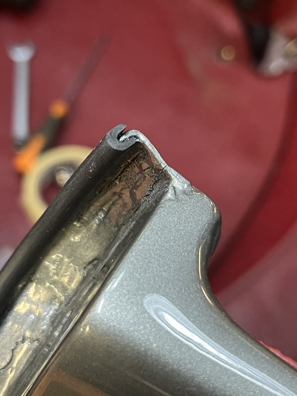

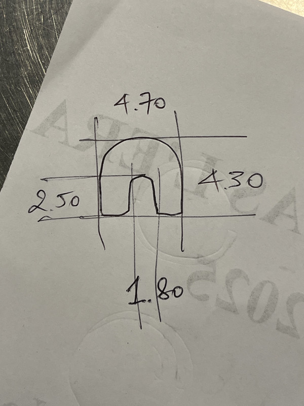

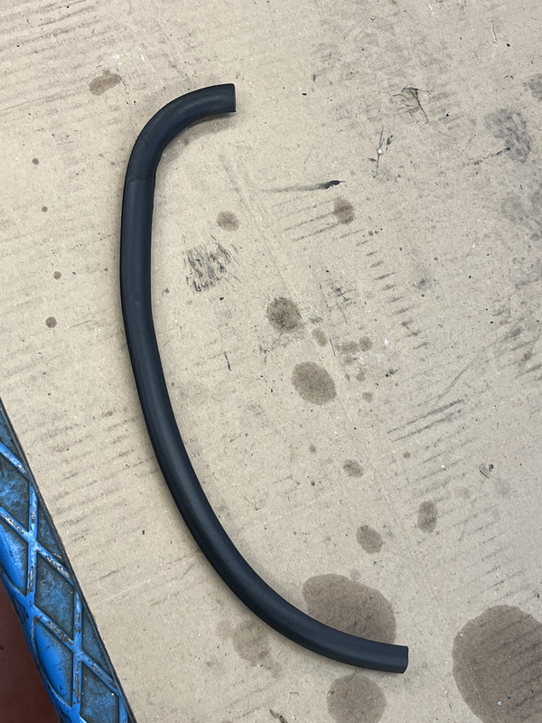

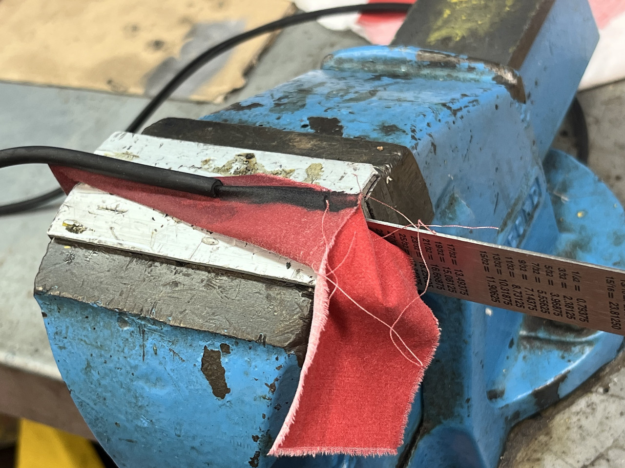

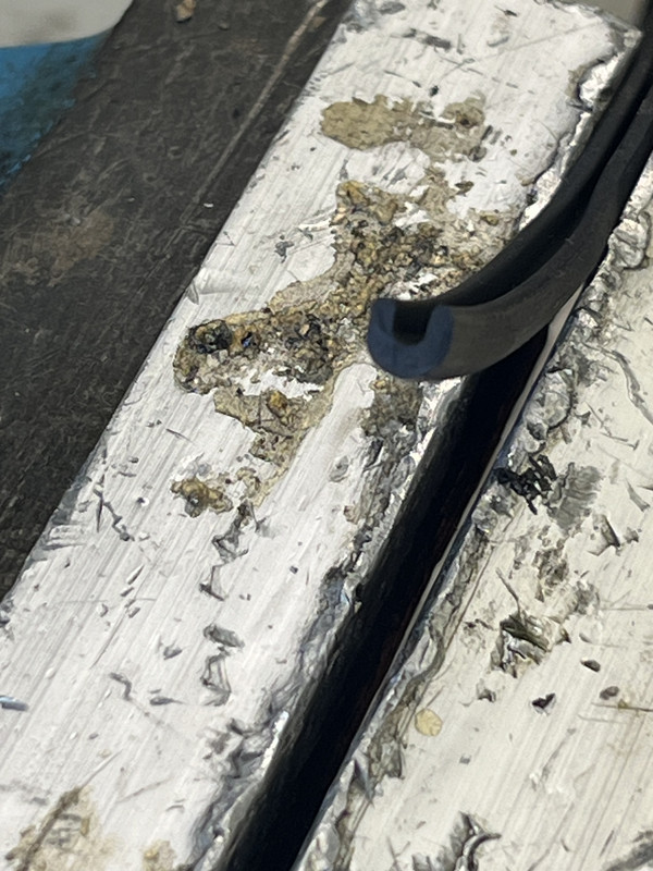

The seam on the shell next to that B-post seal always looks a bit scruffy on my car - you catch it with clothes, your belt, and the older you get the more often it catches on your exiting frame.
So I have tried to put a hard-rubber section over it, held in place with slower-curing and rubber-compatible Superglue, and then bonded it to the B-post seal ........... sounds pretty ambitious and may be a flop, BUT it's not that difficult to try, and as I now treat B-post seals as Wear Items, a bit like an oil-change, it seemed worth a roll of the dice.
There is probably a more suitable profile out there, the groove could be nearer 1mm, but it's what I had in stock.
Running it along a cloth-wrapped edge wet with mid-weight thinners should hopefully remove any release agent or w.h.y. left over from the manufacturing process, often an issue with Baines' seals.
I did one side with Superglue between the edging and the B-post seal (they are hard against one another, so you feed the adhesive into a widened gap, using a plastic scraper), and on the other side I tried the 5910, so will report back once the whole lot has been subject to some abuse.
