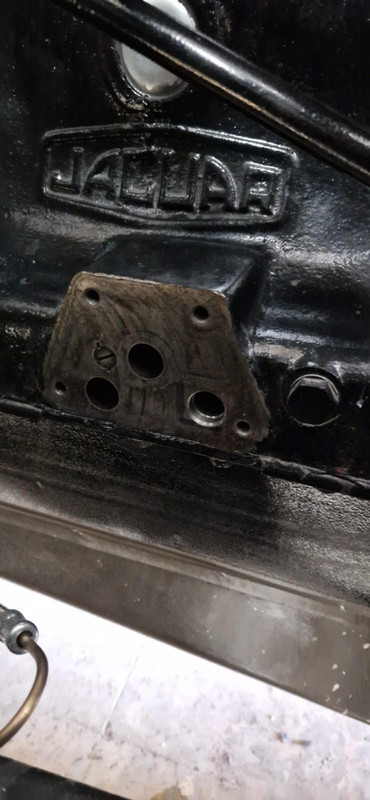

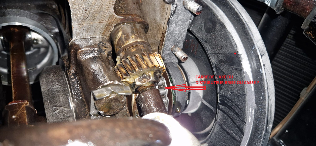

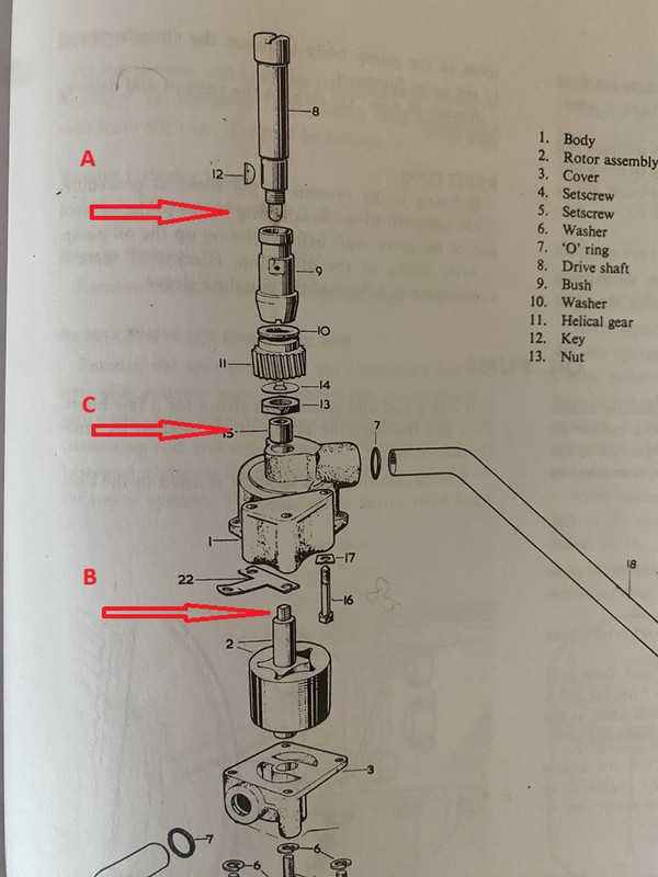

My problem is on a 3.4 l engine ( for a 140 fhc ) : for the first start of engine after restoration by a mechanic, i have no oil in the oil filter ...! the pump is new, i tested it on the bench and i feel air succion and pressure at the exit . I didn't test it with oil... on the engine, the distributor turn as it should . I wonder if there is something broken or worn on the square junction between the distributor shaft and the square end of the pump ( A, B ) or if the square ends may be "rounded " or if the C part is also the culprit?
