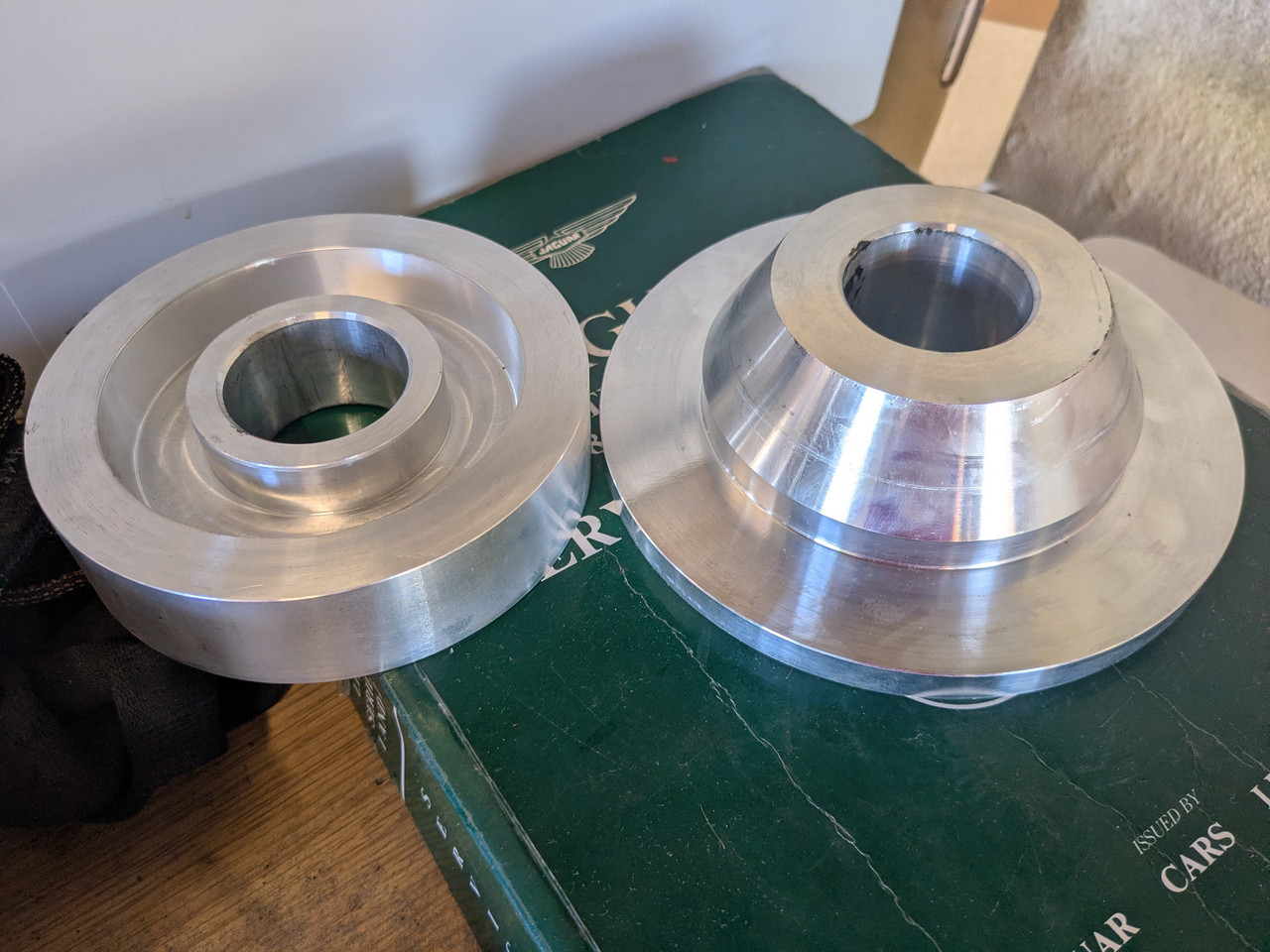

Here are the drawings, steel or any alloy will do.
It's important - if you're getting someone to make these for you - to grasp which surfaces and which geometry is critical, as parting-off (neatly) on such a big diameter (like the cone) will not be easy for all lathe-users.
This means that THE RED SURFACES SHOULD IDEALLY ALL BE MACHINED IN ONE GO, with no shifting in the chuck.
Knowing what matters and what doesn't is helpful, and some of the sizes are really not critical - 125mm seems to be the standard to seat the male cone properly on the back-plate, but if you were using 150mm stock there's no point in reducing it.
The female cone can have whatever OD is easiest, 100mm is probably a safe minimum to protect the lip in case the cone were dropped.
Bear in mind these are for a 40mm shaft wheel-balancing machine - this seems to be the common standard around here, but you had better check that that's the case in your area, as 38mm exists too.

#10 Re: Steering wheel vibrations at 70 mph
Beautiful machining, very nice

#11 Re: Steering wheel vibrations at 70 mph
Pleased to hear it James.
My first stab ended up with the female cone a little too close for comfort to the spokes, so I tweaked the drawing - therefore you were an unwitting Test Driver.
Phew.
The real thank-you should go to my mate SEBASTIEN PELLETIER, known as SebPel obviously, who turns my scribbles into drawings.
