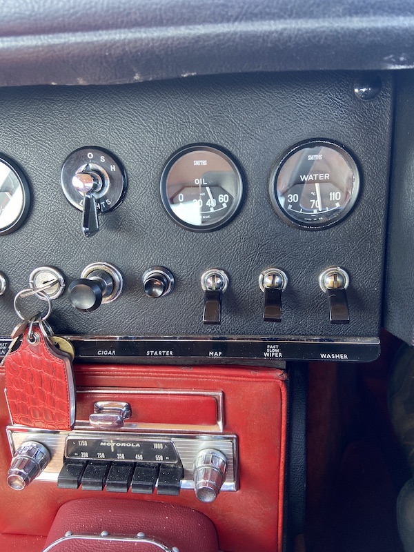

Hi all, I have been a little concerned about running temperatures on my 1964 3.8 FHC, as on the odd occasion if in traffic the engine seems to be running a bit hot. I don't know if I am just being a bit paranoid but when I stop and feel the cam covers they feel very hot - is this normal?
The temp gauge sits at around 76-78 degrees C in normal driving at a steady 2,500 rpm with the oil pressure showing 45psi, rising to 85 degrees and 40psi in traffic. I have a mechanical oil gauge fitted as well as a new temp sender (see image below).

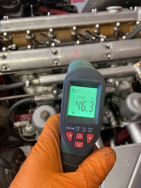

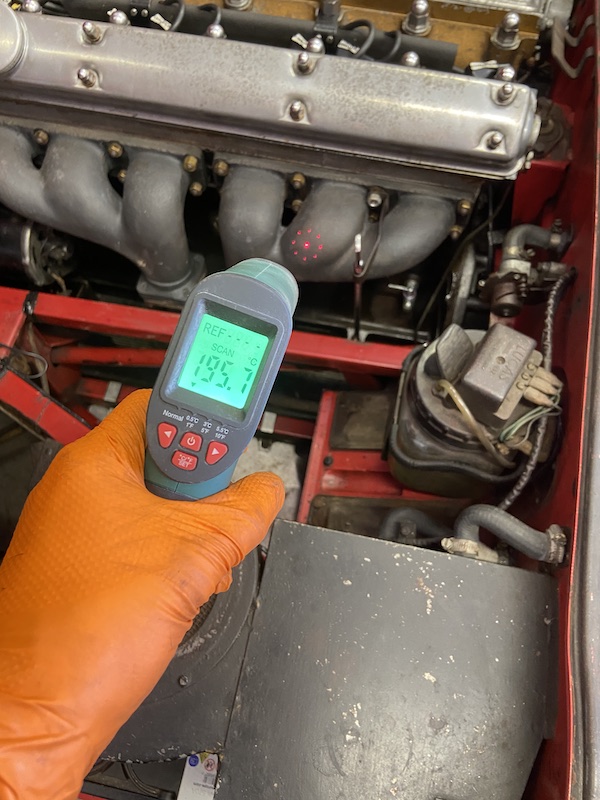

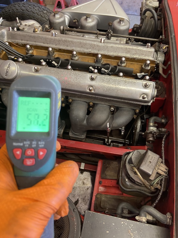

I took a temp reading on both cam covers and manifold and they were 46.3 on the inlet side cam cover, 57.2 on the exhaust side cam cover and 195.7 on the exhaust manifold. (all degree C. see images below)
Guages at 2,500 rpm
Manifold - 195.7 Degrees C
Exhaust side cam cover - 57.2 Degrees C
Inlet side cam cover - 46.3 Degrees C
These readings were taken after a 40 min drive at a steady 55-60 mph on a warm day and a couple of minutes after turning off the engine. Do these figures look normal to you?

Looks perfectly normal to me

That type of infra-red temperature gun generally measure the average temperature within a circle whose diameter is dictated by how far the gun is from the surface in question - not just at the point the red dot is.
Given how far away you appear to be from the cam covers I strongly suspect their actual temperature is somewhat higher than your readings but nonetheless as DWW commented, well in the range of perfectly normal.
