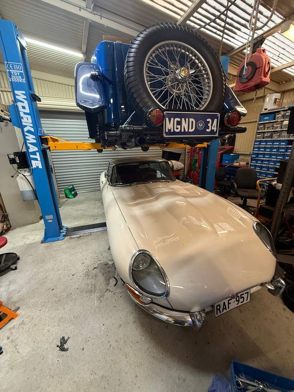

Follow up. #5 plug lead pulled; no difference in rpm. Plug removed; oiled up. Replaced. Car runs perfectly.
We'd been moving the car in and out of the garage a lot while working on Dave's ND. Too much choke fouled the plugs.
