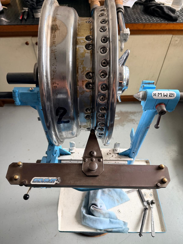

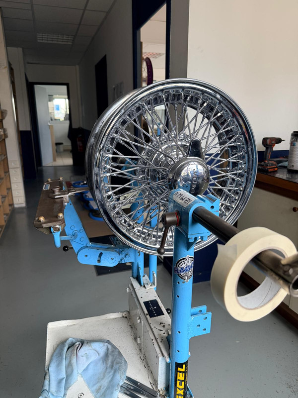

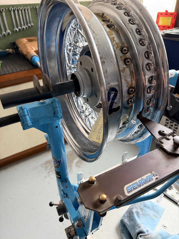

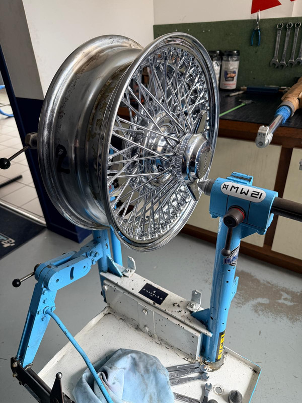

Realised I had never put up the shots of the jig in use on the wheel-builder's pulpit.

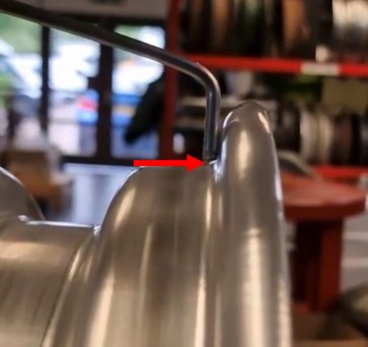

The original Dunlop accepted "true" rim tolerance was - according to MWS - 1.50mm lateral and 1.50mm circular.
This is measured at the "roots" where the beads seat, diagram courtesy of MWS.
I had my wheels done in Dijon by people who are more used to bikes than cars, and where the norm is more like 0.50mm run-out.
Over the years I had always fed a mixture of oil and WD40 into the nipples, with a quill, as part of regular maintenance, and when they came to loosen all the spokes off, before re-tensioning them all, only 2 of Lord-knows how many there are gave them any difficulty, and had to be replaced.
They now run truer than they ever have before, and because of this they also require fewer weights to balance them.
