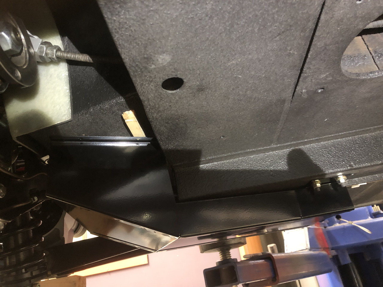

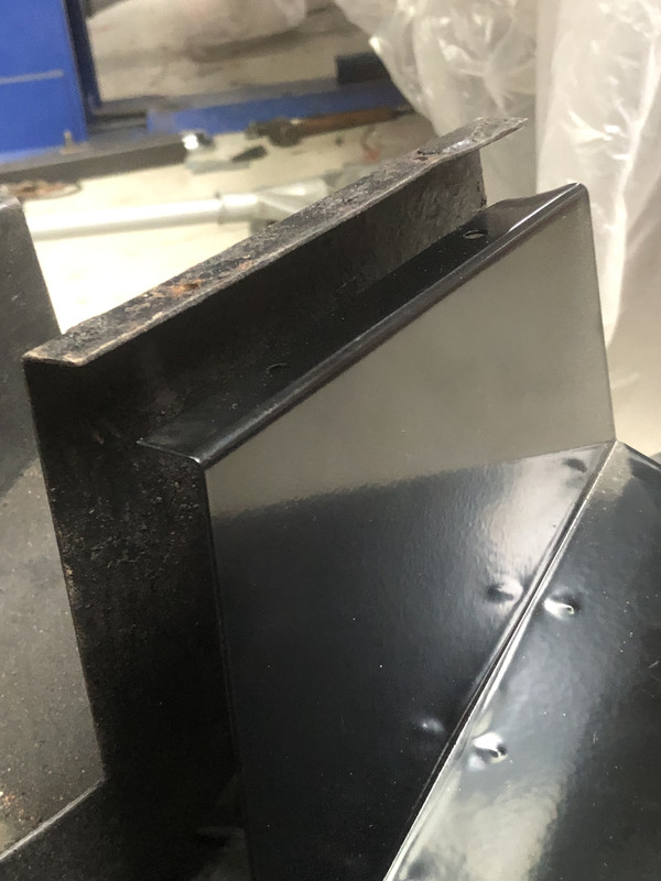

Another part that SNGB make in house that is rubbish, is the rear brake air ducts for a Series 3 E Type. There are two chances of their parts fitting, Buckley's and None. The following pictures are just two of many I sent to SNGB.
In the first picture below below, that's a 16mm wooden packer you can see in the top, left quarter of the picture so as to show SNGB how impossible to fit their part to the car. The folded edge in the location of the wooden packer should be secured to the underside of the car with self tapping screw. Even with 5/16" bolts to pull that edge up to floor would result in a distorted mess. The second picture is a comparison of the SNGB part with an original part. You can see how futile it is to attempt to fit this part.
