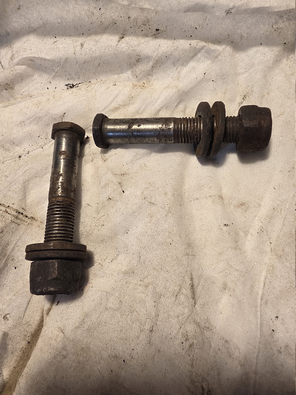

Hi, I've done a stupid thing, rebuilding my rear subframe to fit new brakes etc. Ive managed to end up with 2 special bolts which I cant find a home for! They are 7/16 unf, with nuts and 2 washers each, 2 1/2" long with a 9/16 hex head. They are not the special bolts for the radius arms, those are 1/2 unf and already fitted. I have only 2 bolts for the rarb drop links, which are also 7/16 unf, so I've obviously mixed something up, but I cant figure out what I've done. Can anyone steer me in the right direction please? Note to self: always label these bolts!

Rear anti roll bar I think....Steve

Thanks, that would make sense because thats all I've got left to fit, but I dont understand the need for special bolts there, cant see a hex recess or anything.

Possibly a thinner head for clearance......without a setup in front of me I can't tell.....dont overthink it....Steve

Steve, I think you’re correct, from what I remember there is little room to pass a full size hex head beside another part.

That bolt with the thin head, is the bolt that secures the small rubber bush end of the Radius Arm to the Wishbone of a Series 1 car. Series 2 and 3 cars have a more conventional bolt, where the thread points towards the outside and engages with a threaded hole in the outer yoke of the wishbone that the hub carrier is attached to. To facilitate that entry direction, part of the hex head of the bolt has a flat machined down to the periphery of the bolt's shank to provide clearance so that the head of the bolt can pass by the shock absorber lower fulcrum boss. This clearance is also facilitated by a removable spacer collar.
With a Series 1 car, the bolt, which is a special bolt with a thin hex head, enters from the outside of the outside yoke, passes through a plain hole in the yoke (no thread), through the small bush end of the Radius Arm, and secured with a nut. The thin hex head of the bolt is driven into a shallow bore in the yoke, with the corners of the hex being an interference fit with the bore so as to stop the bolt from turning when the nut is being tightened. As a consequence of this system, the Radius Arm can't be detached from the wishbone without detaching the hub carrier from the wishbone.

C18296 is a special head 7/16 bolt used on the rear anti roll bar on some cars.....the original posted did say the bolts are not for the small bush on the sway bar that are larger 1/2in that he has fitted already.....what model car is this from?....Steve
