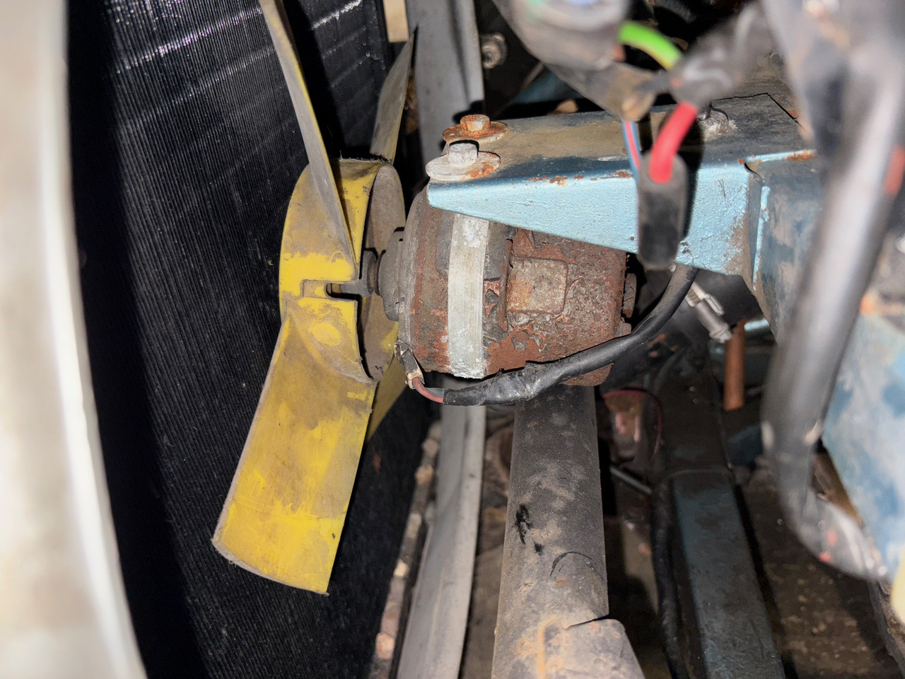

My car has had a 'different' fan motor fitted (not quite sure what it is from?) which is held onto the mounting platform using a large jubilee clip. Now this sounds like a terrible bodge, but it is very secure, and has worked it would seem for quite a long time. Long term plan is to maybe fit a modified fan system (Kenlowe or Cool Cat?) but initially I want to get the one that's fitted working so I can run the car to temperature etc..

It would be helpful to have a photo of the fan / motor installation. Someone may recognise the parts.

The attached picture is not for the faint of heart... I know it looks awful, but it works, and has been working for the past goodness knows how long so it will stay on, for now at least...
I tested the standard circuit this morning by removing the wire from the Otter switch and earthing it with the ignition on and the manual override switch disconnected, it works fine. This suggests one of two things, either the manual override switch was fitted as a precautionary measure, or the Otter switch has failed. I will run the car up to temperature and see if it cuts in, and if not I will test the Otter switch. If the system works OK, (as many have said on this forum they have a standard system and it works fine?), and I do like standard stuff, I may well just leave as is for now, i.e. re-fit the manual override switch as a 'just in case'.
The long term plan is to renew the picture frame as it looks like it has had some 'rough treatment' over the years, and a new one isn't that expensive. When I do this, I will look to maybe modifying/changing the fan motor.
I have been looking at CoolCat/Kenlowe systems, and have to say I do like the look of the standard motor, plus they are still available and a sensible price too. Only slight mod I may do is replace the 2 blade fan with a multi blade one. Has anyone done this? Is it even possible??

Hi Steve....is your fan blowing or sucking.......Steve

Hi Steve, Definitely sucking. i.e. pulling air through the radiator. It is doing what it needs to do, albeit a bit unsightly mate!!

That looks like it might be a very early Kenlowe fan before they started using pancake motors.
I would not bother with the single blade ‘Flymo’ fan, I would save up for the Cool Cat multi blade version.

Thanks Mike, It pains me to say it as I do love originality, but I think you are correct!

I have the fossway performance fan and their otter switch, very pleased with it, looks good and keeps the car cool, it does need a relay though

#14 Re: cooling fan
