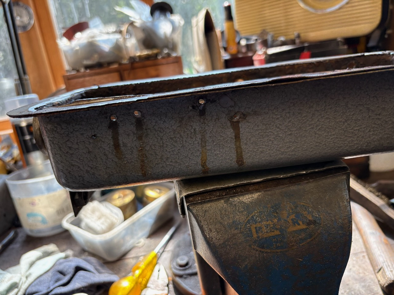

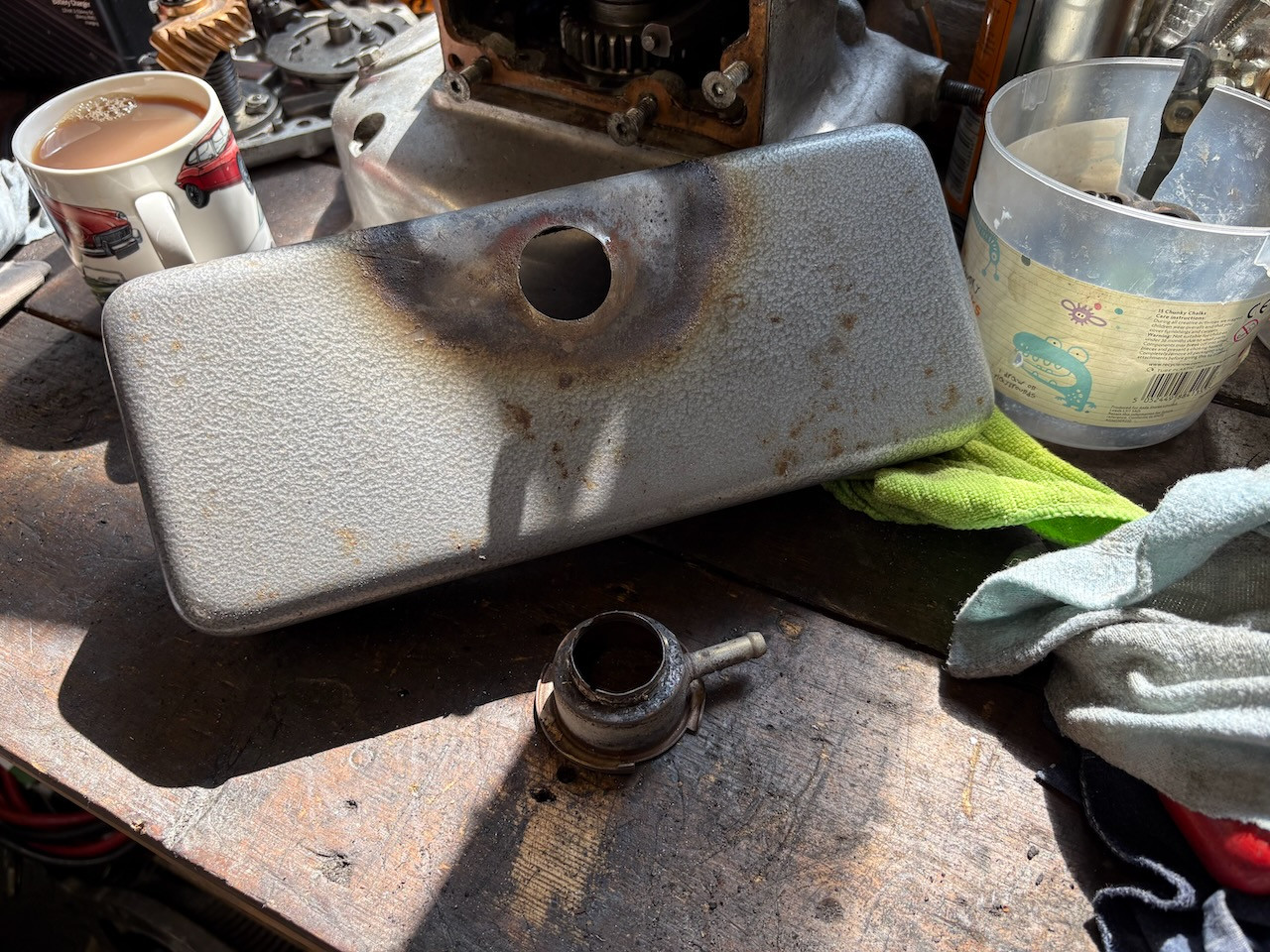

I noticed a small leak on the header tank, so removed it tonight to take a closer look. More holes in it than a Swiss cheese once I started to poke around, so a new tank required.

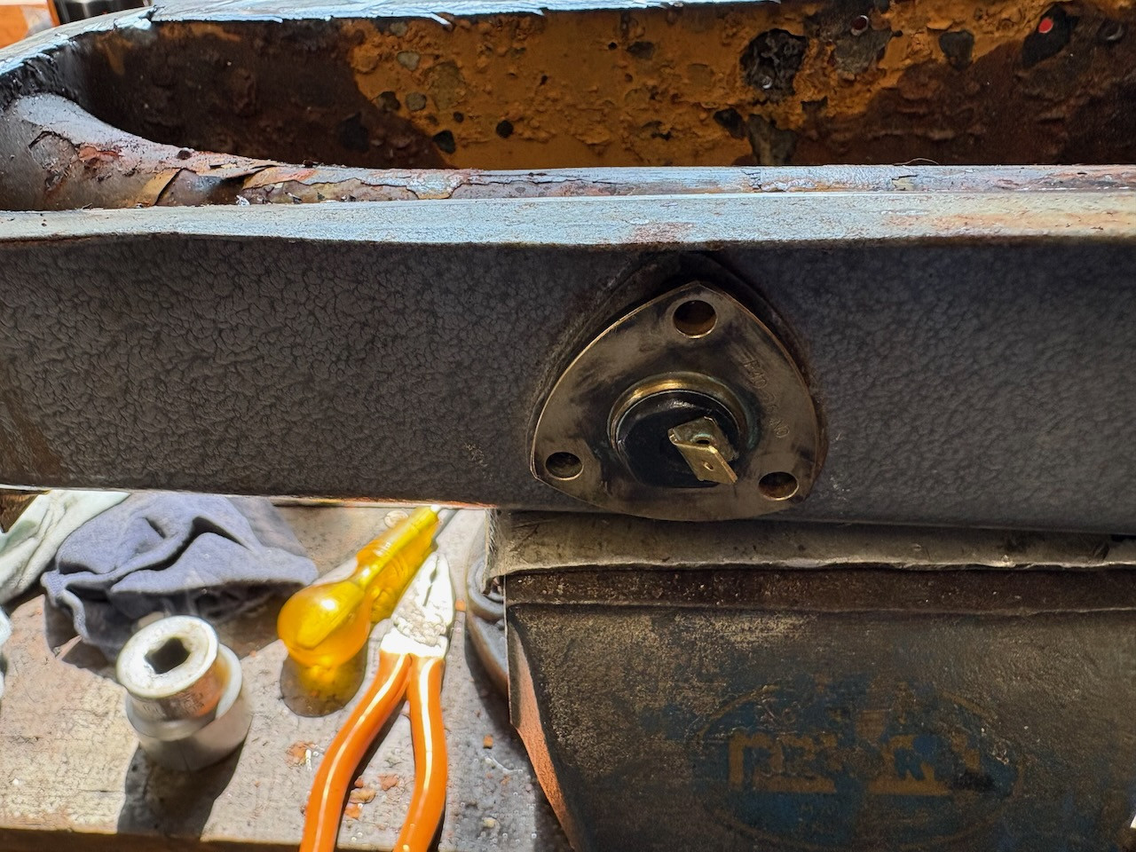

Take the otter apart and clean the contacts, re-test and it should be ok, I wouldn't just buy another until I knew why it wasn't working.

I was hoping to be able to do that as it has worked for me in the past, but my otter wasn’t one that could be taken apart (no tabs) plus it was a short bulb version so technically incorrect. The new one I purchased from Burlen, is the tab type and long bulb.

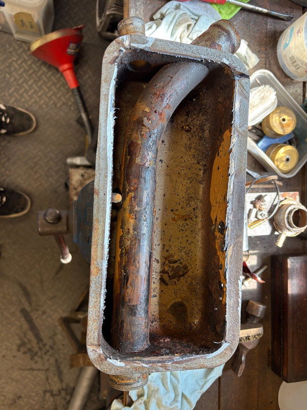

I have a contact in Sherbourne who is a very good Aluminium welder. He repairs fuel tanks and is doing my Lita tank at the moment. I went to see him yesterday with the header tank to see if he could fashion an aluminium version. He didn’t see it as an issue, but wanted to know what the layout was inside. I have agreed to strip my original one carefully so he can see the pipe layout, and he can then make one. I quite like the idea of having one with a curved top, and he can of course do this.

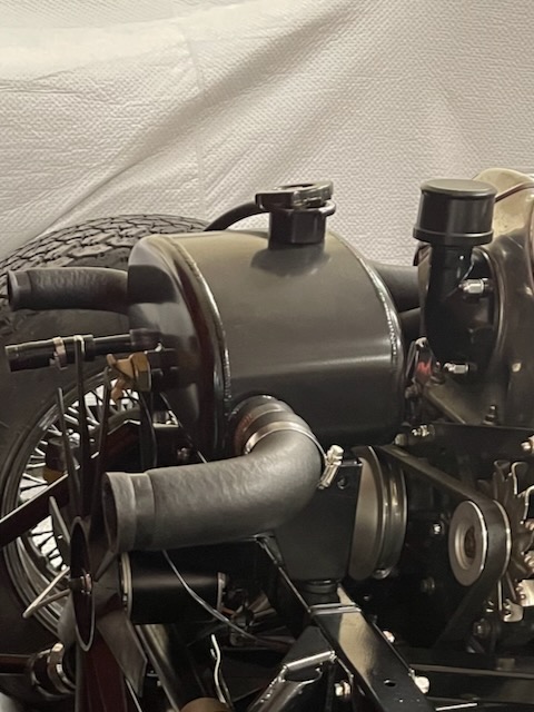

Have you checked out the header tank from Cambridge Motorsport? It's a thing of beauty and can be ordered with choice of thermo switch bosses, and either polished or satin finished. I bought polished, but found it a bit blingy, so had it powder coated satin black.

Thanks again, I like the look of the Cambridge one, I am with you on the colour as well!

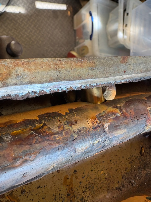

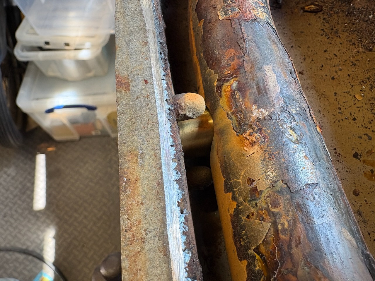

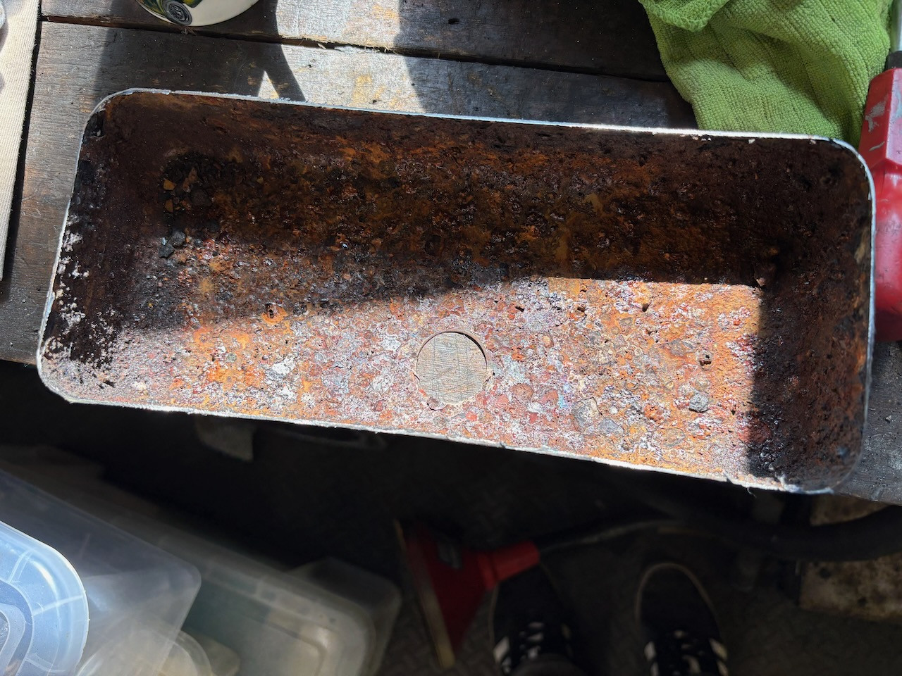

I took the lid off the tank this morning, just to see how bad it was inside, it was horrific...
I can now see why the Otter switch on the 4.2 is a longer bulb type, it sits in the pipe that has flow when the stat opens/closes, thereby working more efficiently.
I can also see why they corrode.The roof of the tank never really gets immersed in water but will suffer condensation drips, and as a result will of course corrode like hell! I am considering trying somehow to coat the roof, but with what im not sure as yet...
My welder friend says he can make this no problem, Aluminium/brass/whatever I want, waiting for him to let me know how much first...
Meanwhile here's some photos to enjoy (or not!).
