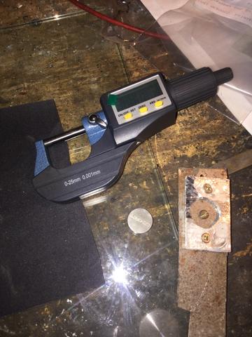

Well, time to explain how I got through this issue.
I elected to grind the thinner shim, from the thinnest available at SNG. I made a special tool to handle the shim, and pushed it back and forth on a sand paper, or in circles, laid onto a thick piece of glass.
It is sort of a spoon, with an embossment in the middle of the recess, in order to apply punctual pressure on the shim so as not to make any wedge in it.
"Very clever" I thought, immodestly. My problem occurred elsewhere: in the math I made to calculate the shims I needed! Almost none gave the correct clearance, eventually :banghead:
So I had the choice between ordering a new set, which supposes that I made the correct math this time :?: , and results in a week delay due to postage. Or, grinding the shims myself, which takes a lot of effort and time, but less than a day (so I thought). I took the later path. Actually it took me the whole week-end, in a try and error process, some valves required 4 or 5 steps before converging to the famous 0.004" and 0.006" clearances (which validates the choice not to purchase the shims at each step).
The only thing I found to speed up the process is to alternate gross and fine sand paper, finishing with 2000 grid to kind of polish the surface.
To my relief, I can now move to the next step: reassembling the block and the head :drinkingcheers:
