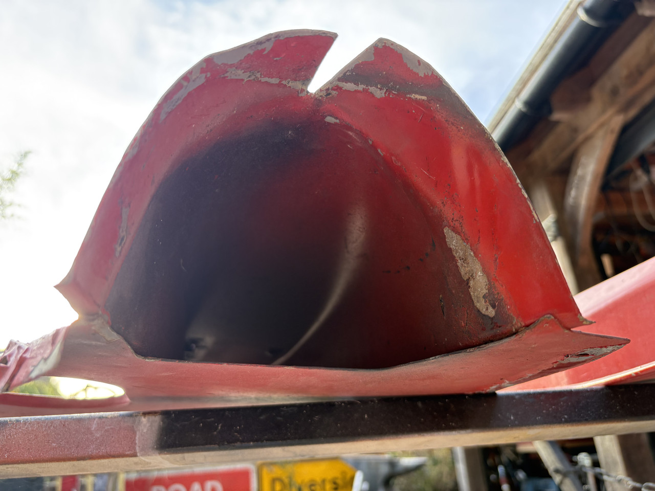

Is this an original or copy part.
Trevor.

Assessing whether a bonnet panel is original or not is pretty much impossible. Maybe someone who restores E type bodywork for a living might hazard a guess as to provenance, but they're not stamped nor have ID marks for us mere mortals.
It's all very well for Chuck, who has a very good reputation where panel work is concerned, to say things like that, but he can actually make his own repair sections and panels, and again most of us don't have access to that.
Over about 15 years I was involved in ground up restorations of maybe 15 or 20 E Types. All of our panel work was done by one guy throughout that period.
Wherever possible he would repair original panels. If not, we sometimes could supply second hand panels (often rejects from previous repairs). When we couldn't do that we bought panels new, and by and large he did a good job of fitting them, and hated every minute of it. The curvature of the repro wings was a particular problem.
As per David above the panel dies themselves changed shape over time at Jaguar, so early and later cars with original panels had subtle differences.
Modern repros have to be copied from something, and that one panel might suit one car and not the other. In our experience the Martin Robey panels were usually a better fit than the cheaper panels that seemed to come at the time from Eastern Europe.
In any event the only thing you can do is make your bonnet fit your car. This involves pulling the whole thing to bits, measuring up your body and chassis rails (another source of error) and them making the panels fit any way you can. I've seen new centre sections need to be trimmed an inch at the back, or alternatively have an extra inch welded in there to make it fit.
Unfortunately it's par for the course.

The captive nuts at the bottom show its original in my thinking, I have not been able to find a source of those captive nut plates though that doesn't mean they don't exist somewhere.
But in addition the spot welding that fixes them in place appears to have been made with a 4 electrode spot welder as they are consistently spaced which is not something you could easily achieve, also the size of the spot welds would make me think its original, or at least as original as mine.

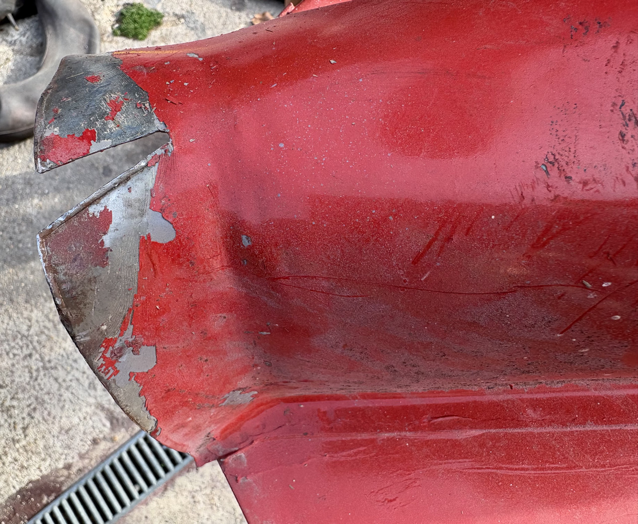

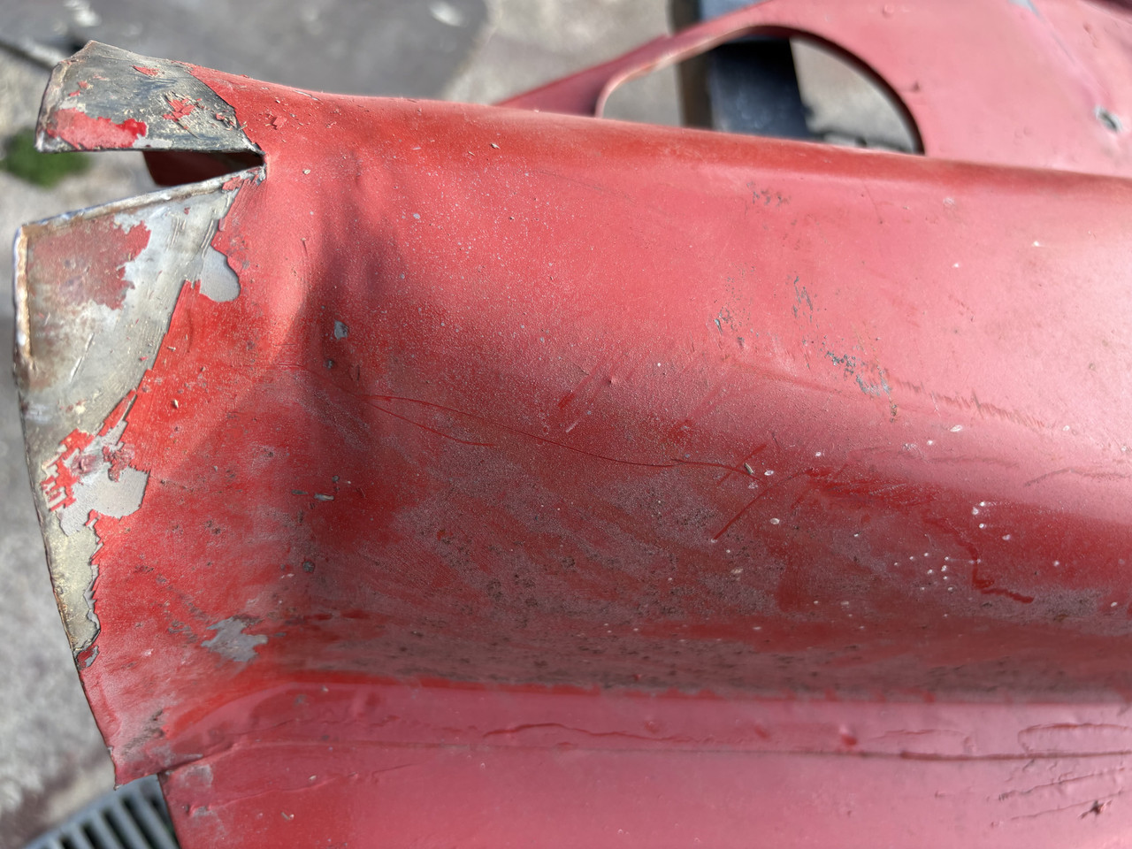

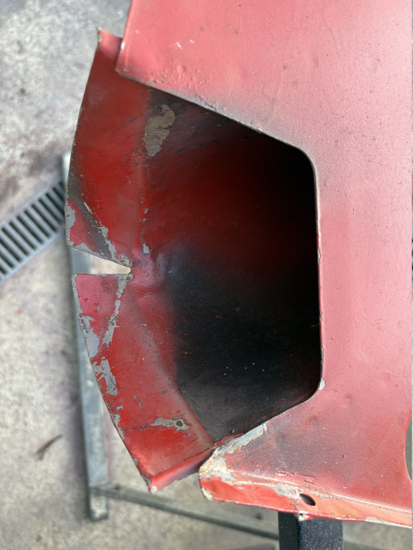

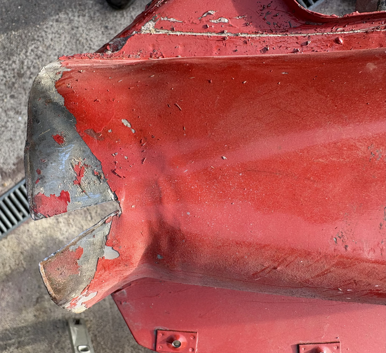

Tony that’s interesting and encouraging if there’s any truth in those observations, and nobody has challenged you on that yet.
Quite a few of my panels have those speed clips with the 4 spot welds.
Andrew thank you for your experience, I appreciate I might be asking the impossible but collectively we may have little nuggets of information.
So the damage on the ends of my air tubes/inner wings suggest a few possibilities
It may have had a little bump and not been repaired properly.
It could be an ill fitting pattern part made to fit.
It might have been an original part but assembled by an ape.
Also it may have been adjusted to compensate for another pattern part that it interfaces with.
What I don’t know is what the leading damaged end of the air tubes should look like when it hasn’t been mutilated. I also haven’t been able to find any detailed images of how snuggly it fits around the mouth of the lower valance and the main centre section. I’m assuming they should be fairly close fitting but not so close as to rub.
I’m unsure if the rippling in the panel is due to the original pressing or later damage sustained, the slit isn’t parallel compared to the other side. So if anyone has detailed images of these areas it would be helpful.
