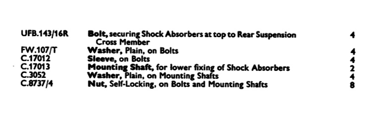

According to the S1,S2 & S3 parts lists, there has only been one washer per bolt specified.

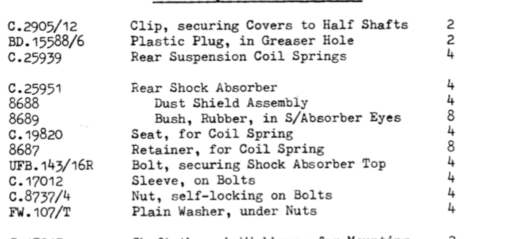

However, from the S2, the washer moved from under the bolt, to under the nut.
S1
S2

Post by Joes66 » Wed May 13, 2020 12:36 pm
Ohhh no.....
Haha
Ok I will stick the washer under the nut!!
