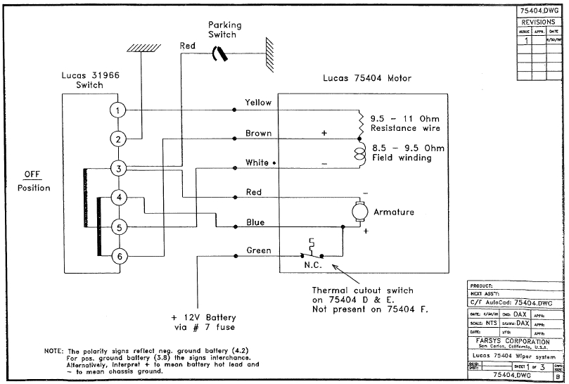

As you can see from the diagram you should have 12V on the green wire with ignition on. The red wire goes to the park switch which will earth when operated. You should also see 12V on Blue and Brown when the motor is connected.
With the motor disconnected you can test the field coil and resistor.
Multimeter set to measure ohms:
Yellow and Brown wires = ~10 ohms
Brown and White wires = ~ 9 ohms
Please report back and we will go from there.

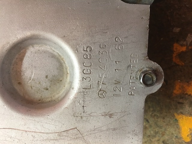

Hi David,
Just to be different mine Is 75403D. Do you think It would have a thermal cutout.

#34 Re: Indicators not working and Positive earth
I think that maybe a C ie 75403C
Is that a Mercedes symbol before the code?

#35 Re: Indicators not working and Positive earth
I should have been more comprehensive in my reply - DL3 75404 is the LHD motor, DL3 75403 is the RHD motor. Yours has a D mark so will have the thermal cut out. Even the early 4.2 cars (up to at least 1965) had the thermal cutout although with the E mark.
The Mercedes style symbol has nothing to do with the German car company. It is the Lucas symbol for 'part number'
