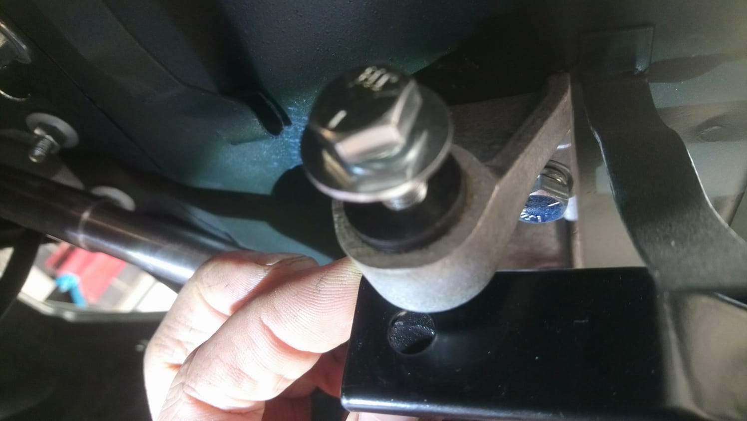

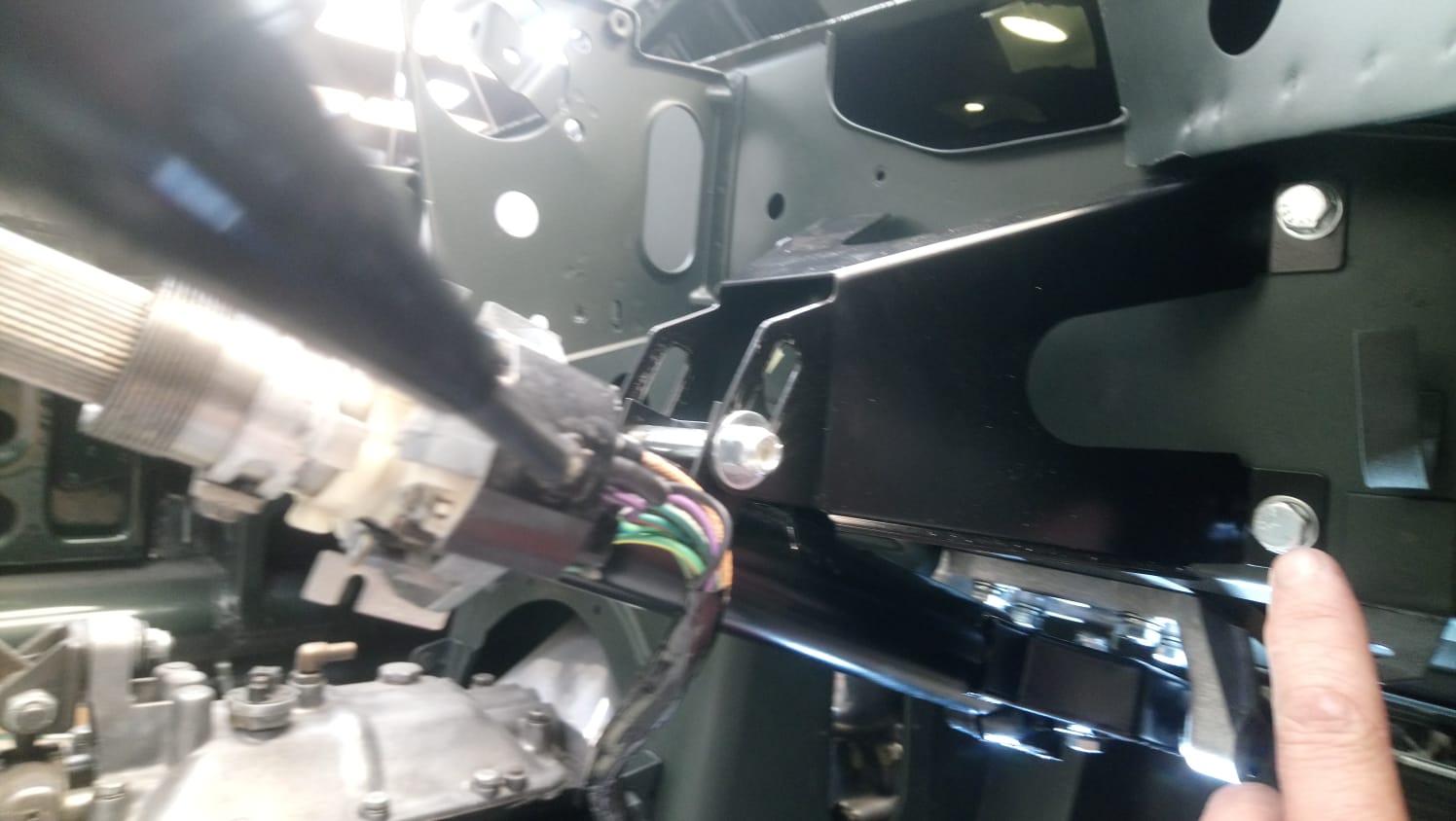

Latest issue is that with the bulkhead and under scuttle mounting bracket fitted the steering tube lower mounting holes on the steering tube do not line up with the holes in the alloy mounting bracket. The solution would appear to fit 5mm spacers between the upper mounting bracket and the bulkhead to bring the lower tube mounting holes back in line with the alloy bracket. Photos show the misalignment and the position where proposed spacers would be required. Has anyone seen this problem and is the proposed solution safe and acceptable?

Post by tinworm » Thu May 27, 2021 11:55 am
Don't forget C24285 spacer on lower bracket.

Thanks Barrie, I’m not sure that would move things enough to line up the holes. I also understand it is listed as NLA at Barratts

Post by tinworm » Fri May 28, 2021 5:04 am
Hello Alan, its not difficult to make the spacer - its the same rectangle shape as the mounting face of the lower bracket and is 3/16" thick.
Barrie
ps If you can its worth measuring all the parts and comparing with an existing car particularly if repro items are being used.

Post by Heronscourt » Fri May 28, 2021 11:07 am
Thanks Barrie. It’s interesting that the spacer doesn’t appear on the series 1 4.2 illustration on Barratt’s website but is on the 1.5 car illustration even though all all other part numbers are identical and apart from the misalignment of the holes shown on my photo everything else lines up pretty well. I can’t imagine that the position of captive nuts for the bracket mountings were changed. It may be the usual pattern part problem. I’ve asked Julien Barrett for an opinion and I’ll post his response. What is your opinion of my suggestion regarding moving the upper bracket away from the dashboard with spacers to line up the tube mounting holes with the lower bracket? Longer mounting bolts obviously needed but Is it a safety issue?

Post by tinworm » Fri May 28, 2021 12:03 pm
Hello Alan , I have seen spacers used under the top bracket - they were square with a slot - so a 'U' shape . Jaguar don't list a spacer here - so I don't know if that was an unlikely production line fit or a retro fit. Not safety related as long as everything is tight.
Looking at your photo the legs at the bottom of the top tube may be your problem - some adjustment of these I have seen many times.

Post by Heronscourt » Fri May 28, 2021 12:36 pm
Thanks again Barrie, I’ll look at if the legs can be cranked slightly to line up the holes.

Post by Heronscourt » Sun May 30, 2021 7:45 pm
Hi Barrie, a further thought. What about detaching the legs and re attaching them 5mm further back up the tube thus avoiding the possibility of damaging the legs while trying to adjust the crank? This also gives more clearance for the UJ to rotate if the upper column only just clears the end of the tube
