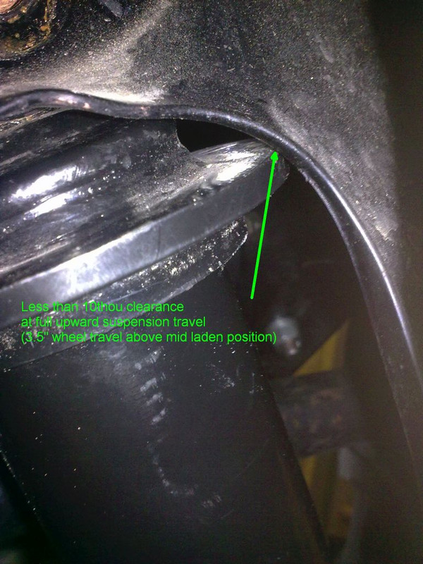

Irrespective of the ride height issue, the relatively short distance between the top perch and eye bolt of the Boge damper compared to the Girling is cause for concern. The full bump position should be checked to ensure that as the damper swings outward it does not impact the IRS cage. Consequences can be broken damper rod and/or split IRS cage as occured to this S3. (S3 has same cage but longer driveshafts than S1/2 so damper operates at a slightly greater angle exacerbating the problem)

Age strikes again - yes I was looking at the wrong ends of the dampers. :oops:
FWIW the Konis which came with my car only have 10thou clearance from the cage on full 3.5in bump.
Bob
