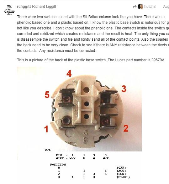

I note however that all the wiring diagrams I have seen show incorrect terminal wiring for the switch. I found the attached from Jag Lovers which I can confirm is correct. I have re-installed the original 39679A switch which I erroneously believed to be faulty but I can confirm that the Lucas 39415 is configured exactly the same way and works fine.
There are 2 wires attached to T2 - 12v from battery and 12v to starter solenoid.
There are 2 wires attached to T3, one of which is in fact 2 wires into 1 connector , so in effect 3 wires. These are attached to fuses 6 and 7 - coil, fuel pump instruments etc
There is 1 wire attached to T1 - starter relay
Nothing on T4 unless you have accessories
This is not what the wiring diagrams show.
I hope this helps - thanks to all those who provided assistance

- ligget switch.JPG (53.35 KiB) Viewed 4463 times

It was a wiring error. The wire connected to the coil was on the accessories terminal which is isolated during cranking. This meant that there was a 12v connection to the coil when in position 2 on the switch (ignition on) but when turning to position 3 (start) the 12v feed to coil was turned off. For years the car started, which I can only surmise was because of a strong battery providing plenty of spinning momentum to allow the engine to fire when key returned to position 2 and 12v feed to coil recommenced
As battery declined (it was NINE years old) the car would not start until we attached a direct 12 v wire from battery to coil.
with switch wiring corrected (as I note above, the wiring diagrams are wrong), and a new battery, the car starts almost immediately cranking commences. Even though it is 9 years old, I suspect as you say that now I have corrected the wiring the old battery would still start the car, but at nine years old I felt I had got my money's worth
