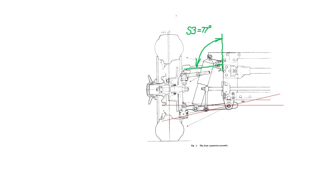

The reason it is said that the bushes should not be tightened until the car is on its wheels is so that, in their normal position the bushes will not be twisted; suspension travel will then be accommodated by the least amount of twisting of the bushes. I.e. it is a position thing, not a load thing.
In their normal (static loaded) position the wishbones are ~level (horizontal) and the frame to which the bush housings are bolted are at angles of ~77 degrees off horizontal. Knowing this, you can fully tighten and pin the fulcrum shaft nuts before bolting the wishbone to the car; just ensure while you do it that the angle between the wishbone and the mounting face of the bush housing is ~77 degrees.
You don’t get a choice about how much to tighten the fulcrum shaft nuts and compress the rubber. The nuts have to be tightened until the distance between the mounting holes in the bush housings is the same as the distance between the mounting holes in the frame. You will find that, if you are using all of the proper and correct thrust washers, the holes will be aligned when the washers are hard up against the ends of the bushes inner tubes. Note that you absolutely need this. The way these bushes work, the inner tube twists with the wishbone; the tube is clamped to the wishbone by the fulcrum shaft nuts; otherwise the fulcrum shaft will twist inside the tube, squeal like a banshee and handle like a citroen.
Last but not least, there is absolutely nothing wrong, nothing is lost, by trimming the rubber. The torque wrench settings are specified, 60 for the uppers, 80 for the lowers. If you are at these levels before the bush inner tubes are fully clamped and mounting holes aligned, your only option is to trim the rubber a couple of mm and try again.

As for the 77°and assembling on the bench, sorry, we must live in a different hemisphere

thanks for your advise but I am not quite sure about this 77° angle. What is it related to exactly?

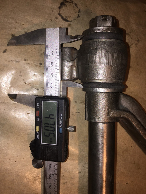

Philippe, to test everything you can just clamp the shaft in a vice - no wishbone needed - and fit both fulcrum blocks, with requisite washers, then run the nuts up hard and tight.
Note that the OUTER washers have a 1/2” bore, and are meant to butt up against the shoulder at the end of the threads.
The rubber has no effect whatsoever on how the castellated nuts end up oriented, this is dictated uniquely by the length of the steel sleeve that is contained within the rubber.
As a matter of precaution, just check that the sleeves are slightly (1 or 2mm from memory) longer than the corresponding parallel shank of the shaft, otherwise you’re not tightening on the sleeve but on the shoulder of the shaft.

Philippe - looking at your Fig.6., you can see that the rubber flange that is formed when the fulcrum nut is tightened is compressed between the bush housing on the inside, that is stationary, and the washers on the outside, that rotate with the wishbone. Ideally the washer would slide against the rubber however rubber is a lousy slide bearing surface and if the force required to compress the rubber is too much, instead of sliding the flanges will shear off.

On an S3, this angle is ~77 degrees, mainly because the frame post is not vertical.
If you know what it is for S1/S2 you can set your bonded sleeve bushes into their neutral position without having to do it on the car. Note there is not this requirement (to set the neutral position) with loose-sleeve bushes.

Having check the dimensions, I'd say my situation is not so bad eventually.
I tightened the slotted nuts so that the split pin holes in the shaft got flush with the depth of the slots. This was made without too much of a fight finally. And the distance between the washers was few tenths of mm longer than the length of the inner sleeves:
Now I released the nuts, waiting for the time to mount them on the car and do the final tightening under weight ... one day

You're nearly there ; forget the crenellations and the alignment of split-pins for now, what you want is to be both nuts tight so that the whole assembly becomes a block, there is nothing to measure or calculate

Yes Rory, my measurement demonstrates that I will be able to fully tighten the nuts, when it is time for the final mounting, up to a full contact between the washers and the sleeves, contrary to what I dreaded in the first instance
