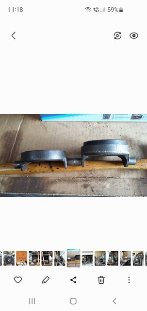

I measured the height of the actual carbon at 7mm on both the new one and the one supplied with the car.

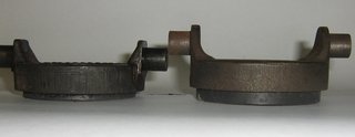

#22 Re: missmatched clutch arm ?
Post by mgcjag » Thu Jul 31, 2025 1:15 pm
Post a photo of your release bearing....is it like the tall one on the right of the photo I posted way back...if not then you have the wrong one....Steve
phoenix
Posts: 412
Location: Blackpool
#23 Re: missmatched clutch arm ?
Post by phoenix » Thu Jul 31, 2025 2:07 pm
I measure the height of the carbon on both the one supplied with the car and the new Girling one and they were both 7mm. Today I mated the box on the engine took the slave cylinder spring off and again the arm would travel all the way to the end of the opening .

#24 Re: missmatched clutch arm ?
Post by mgcjag » Thu Jul 31, 2025 2:27 pm
I Don't think your following the release bearing issue...forget the carbon..yes they all have about the same thickness carbon....what makes them different sizes is the depth from where the carbon starts to the center pivot point....look here both Jag...you need the deeper one on the right.....is this what you have
