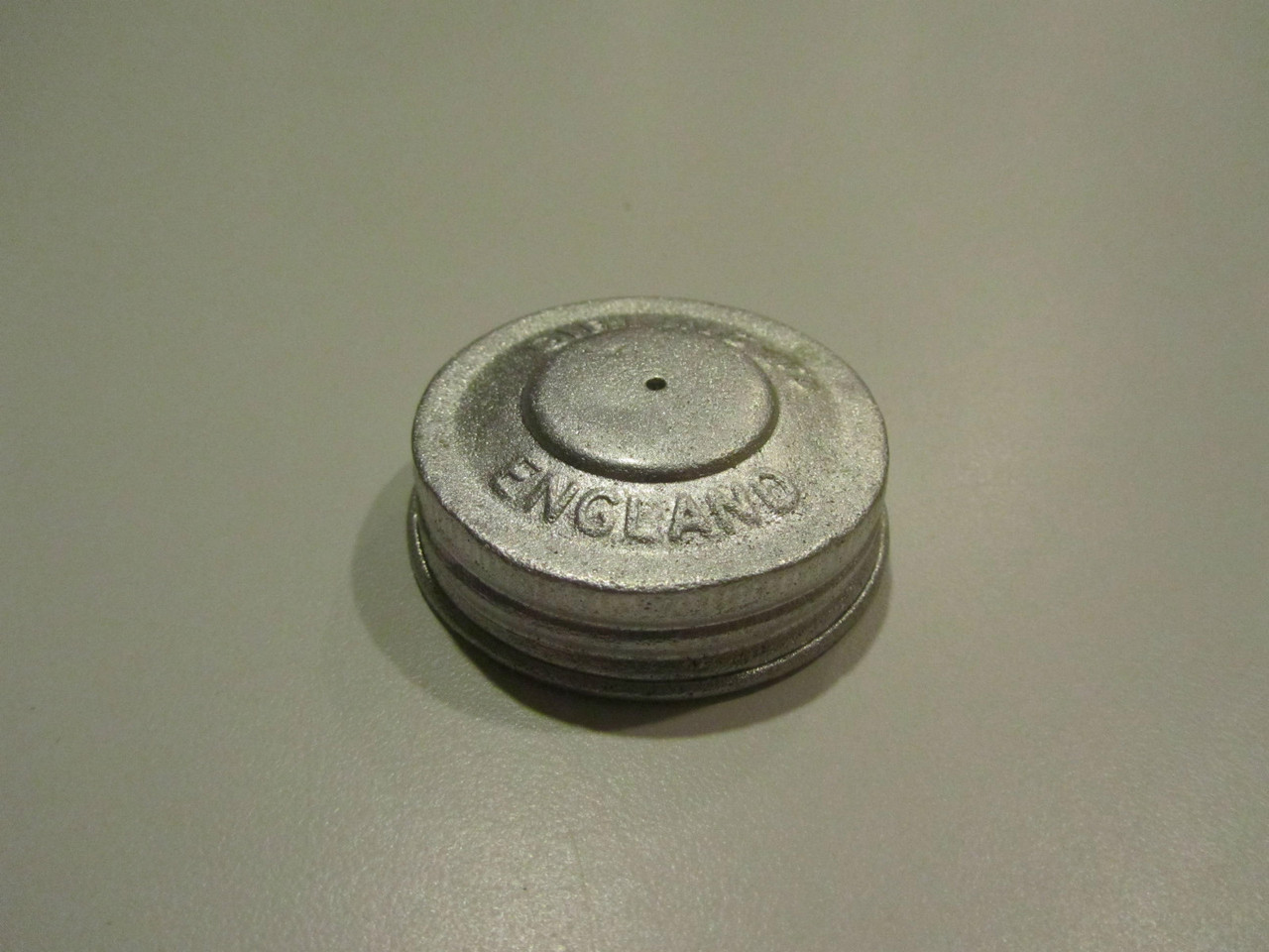

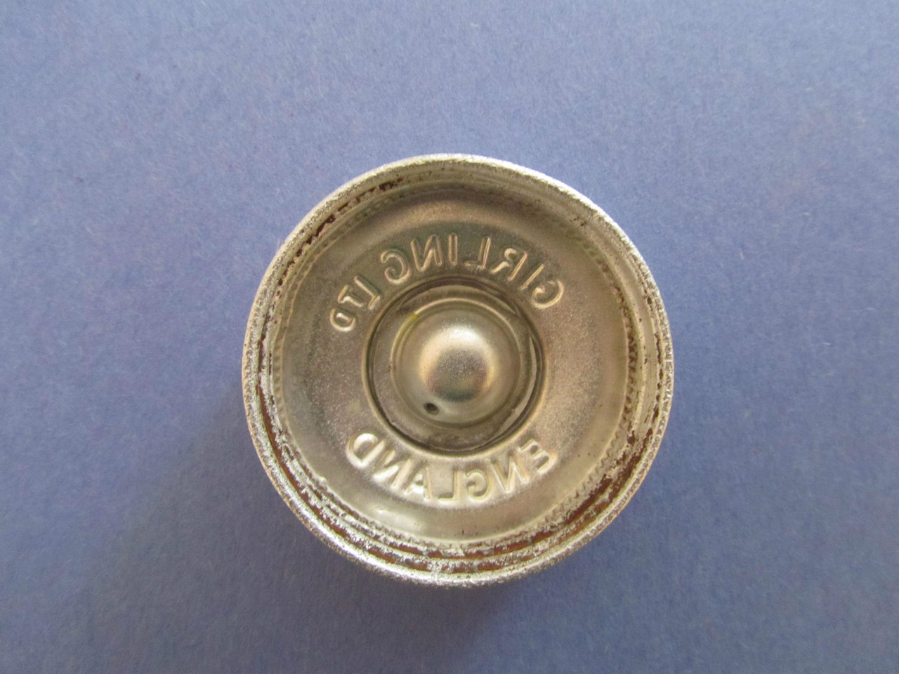

Reference: JAGUAR E-Type Six-Cylinder Originality Guide, Haddock & Mueller, p-226, middle left photo.
"The round clutch reservoir had a pressurized steel cap with no markings. There have been reports of E-types fitted with similar caps, but with GIRLING markings. The GIRLING caps were used on a range of British cars at the same time as E-type production and were likely placed on E-types during repairs or restoration. The authors have never observed a car known to be original with a GIRLING clutch reservoir cap."
The GIRLING clutch reservoir cap in the following images is believed to be for an Austin-Healey 100.
mtnjag
Posts: 588
#22 Re: Yet another brake bottle
Post by mtnjag » Tue Dec 23, 2025 5:34 pm
I interpret "pressurized" as meaning sealed which is very doubtful.
The cap would be vented as the Girling cap in the picture is vented.
Perhaps the writer means with a sealing gasket?
Layne
Car #876005, 62 OTS
budmarston@aol.com
Posts: 91
#23 Re: Yet another brake bottle
Post by budmarston@aol.com » Wed Dec 24, 2025 12:40 pm
Hello, a typo -- well-spotted.
Correction: "The round clutch reservoir had a pressed steel cap with no markings."
