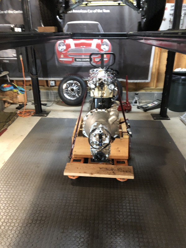

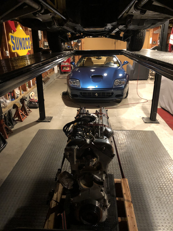

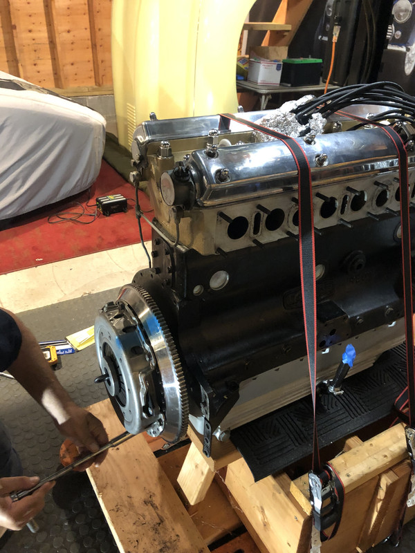

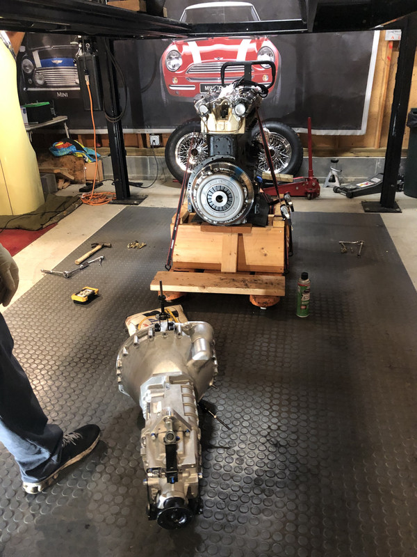

We tried to see how close but
It was getting late and it needs to be tilted to get in place
So I’m tied up with parents and doctors and hospitals so I might need a good week break
Gtjoey
We shall see

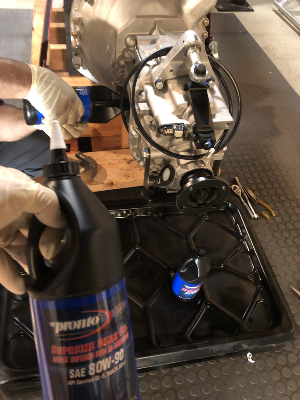

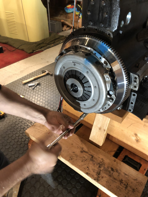

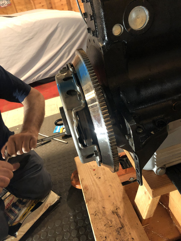

The clutch and flywheel were balanced hence the blue paint so you didn’t move the two apart.

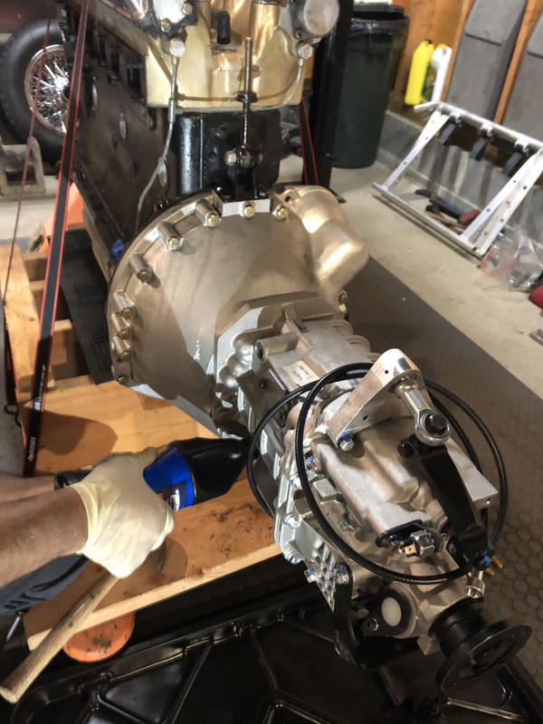

I’m at least 4 inches longer than the original box
It’s a two man job and must be angled in!
After my folks are settled we will get it in 👍🏾
Email away boys and girls!

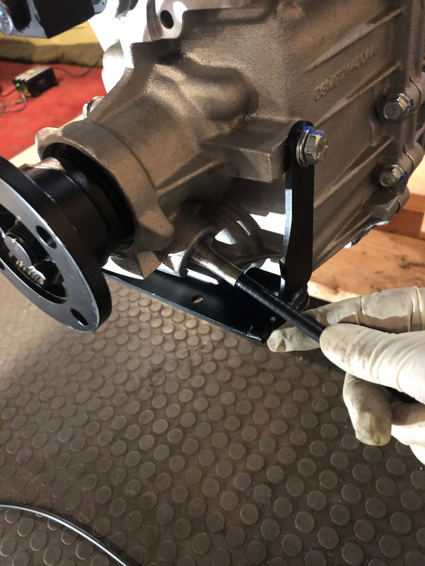

Ps the speedo cable o greased before we put the retaining clip in

Joey...your retaining clips on the clutch fork holding the thrust bearing still looks wrong to me....they should be pushed in more....whats stopping them....is it the hole in the thrust bearing or the recess in the fork......is it a repro fork?......Steve

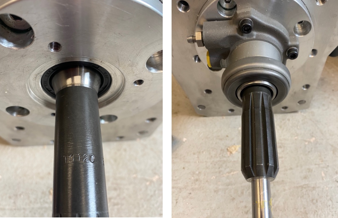

Well no need for retention clips as I've got this little widget instead.
I'm not sure its worth the extra cost, but as its an auto to manual conversion, I didn't have the slave cylinder and clutch bearing release lever or the pivot pin. This solves it, but will be a pain to bleed, so will fit a remote bleeder.
Nice that Broad provide an instruction leaflet. Mine didn't come with even the torque setting for the clutch housing bolts, oh and I also had to cut them down myself. Given these are blind holes, its really key that they are not too long or they will try to press the adaptor plate off the gearbox casing. I think studs make more sense like on yours.

The center hole post is longer on my originals and the retaining clip bent side was shorter.
If you push the clip all the ways down flush with the fork it can spin left and right
Where it is now it’s locked in place
It’s the original fork.

Well if you want one of those concentric throwout bearings, then here is one from RAM Clutches.
https://ramclutches.com/bearings/hydrau ... -bearings/

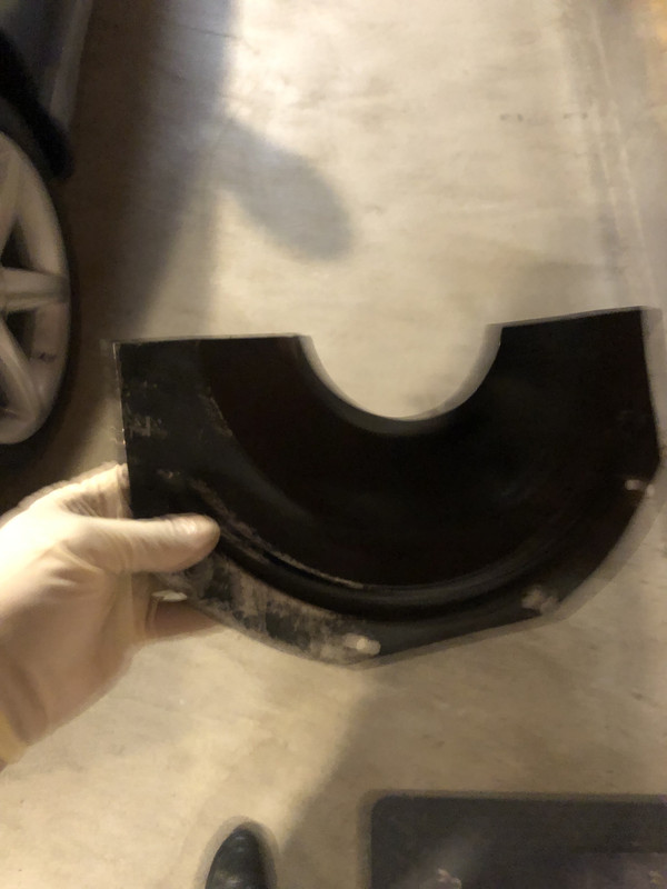

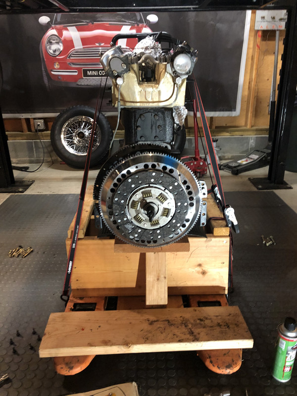

A little prep
Next flywheel inspection cover
gtjoey
Posts: 604
#212 Re: The 5 Speed is here……..
Post by gtjoey » Tue Aug 23, 2022 3:49 pm
Anyone have a suggestion on an angle?
We shall see
Posts: 9134
#213 Re: The 5 Speed is here……..
Post by mgcjag » Tue Aug 23, 2022 4:04 pm
Is your prop shaft in?.....Steve
gtjoey
Posts: 604
#214 Re: The 5 Speed is here……..
Post by gtjoey » Tue Aug 23, 2022 4:17 pm
First thing I did if you go back in the thread.
Yeah forget that and your dead🤣
