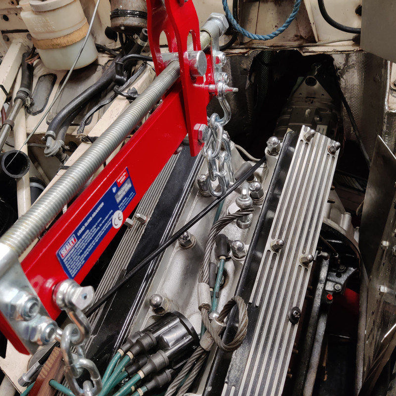

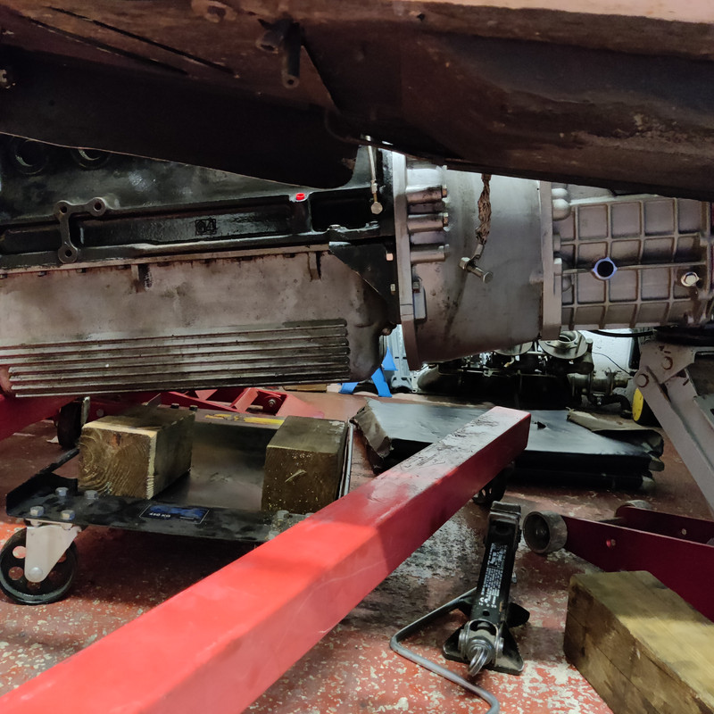

HI there, following your post and just thought to offer some hints having installed a Guy Broad box last winter into my Series 2 FHC.
As you have to raise the engine and gearbox at an angle I found removing the oil breather and studs from the cylinder head it gave just enough room to clear the picture frame to raise the engine and gearbox at the necessary angle. I did use a load leveller to control the lifting process safely, kindly ignore the chaos on the garage floor in picture 2 as I was working on my own and taking photos in real time.

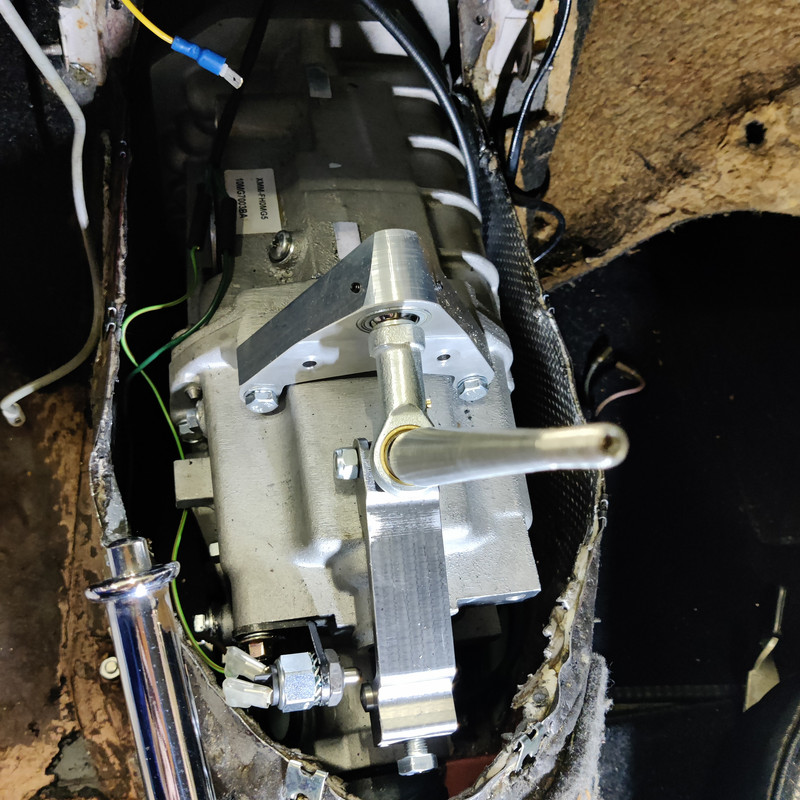

Chris I don’t know how long ago you did yours but
They said they constantly tweek the unit
Here is mine with speedo
If it’s the same angle I think it’s been gone already!
